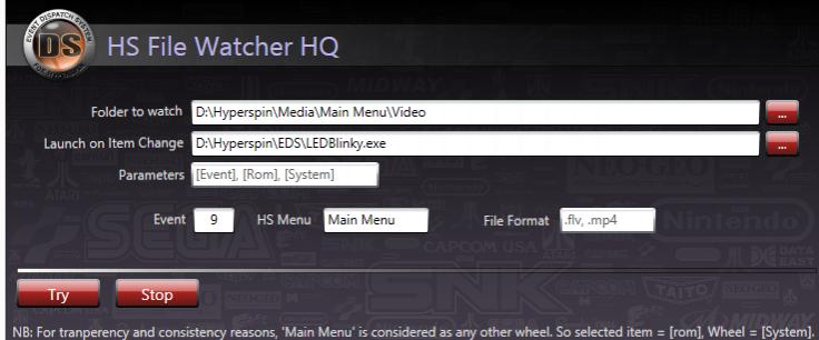

xavielson Posted December 6, 2014 Posted December 6, 2014 could the new "selected" system be retrieved in any manner ? Hi Inquisitom, do u mean when u are on the Main Menu, or do u actually have a system selected and its showing the old one? If u want EDS to know where u are on the main menu, thats HSFileWatcher´s job. It kind of makes the Main Menu a System. To test u can put something like this as ur Artwork: D:\Hyperspin\Media\[system]\Images\Wheel\[Filename].png. Then lets say u have MAME selected on the Main Menu Wheel, it will look for D:\Hyperspin\Media\Main Menu\Images\Wheel\MAME.png Hope it helps. X
Inquisitom Posted December 6, 2014 Posted December 6, 2014 Thanks xavielson, Indeed, I tried with HSFileWatcher, and I get better results.

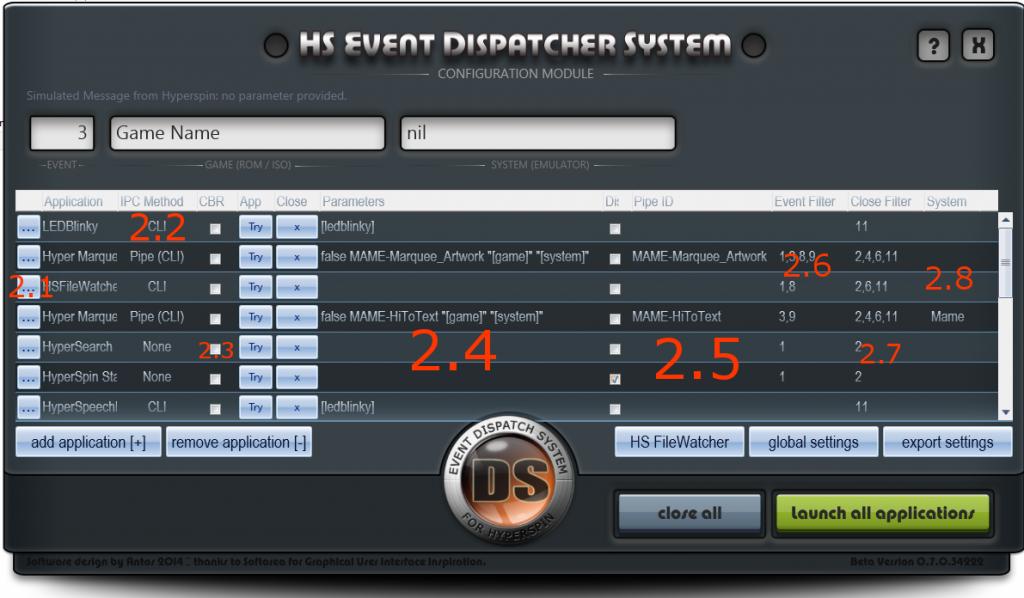

Xtra9268 Posted December 6, 2014 Posted December 6, 2014 Yay! I have successfully configured the HS Event Dispatcher System to launch VLC based on what ever game I put into the rom field. http://i.imgur.com/O8brKY3.png (apologies for the width; posting this on a nw system that only has Microsoft Paint) Unfortunately when I launch a MAME game inside Hyperspin the video doesn't play. Here's what I added: Application: vlc IPC Method: CLI CBR: unchecked Parameters: c:\Hyperspin\Media\MAME\Video\[game].mp4 Pipe ID: MAME-Marquee_Video Event Filter: 3 Close Filter: (empty) System Filter: Mame Does anyone know what I am missing?
sevenseal Posted December 6, 2014 Posted December 6, 2014 I really think you are making things hard on yourself unnecessary, you could just use hypermarquee to make it plain easy. just look like you are kicking yourself.... inorder to fix your issue in it configuration setup.. you need change your parameters to this c:\hyperspin\media\mame\video\ "[game]".mp4 make sure is a space before the "[game]".mp4 next to change to event filter: 3,9 make sure cbr is checked sevenseal

sevenseal Posted December 7, 2014 Posted December 7, 2014 this is a very sloppy instruction due for updates: requirements:Install .Net framework 4.5.1 1.: Rename EDS_LaunchModule.exe application to Ledblinky.exe ( Only for HS users) 2.: Run HyperSpinEventIntegrator.exe (EDS GUI) to configure your apps that you would like to use. 2.1: Application : Specifying application .exe directory location 2.1.1: example path for Application LEDBlinky - C:\Hyperspin\LEDBlinky\LEDBlinky.exe HS FileWatcher - C:\Hyperspin\EDS\HSfileWatcher\HSFileWatcher.exe HyperMarquee - C:\Hyperspin\HyperMarquee\Hyper Marquee.exe 2.2: IPC Methods : 2.3: CBR : Close Before Rerun, avoid using with IPC Methods: Pipe or Pipe (cli) 2.4: Parameters :input are place in this order [event], [system], [game] or [ledblinky] or blank for no parameters used. 2.4.1: Front-End Start (1) Front-End Stop (2) Game Launch (3) Game Stop (4) Screensaver Start (5) Screensaver Stop (6) System Select (7) List Change (8) Game Select (9) Animation Stop (11) Load MAME Controller File (12) Reset Ultrastik 360 (13) 2.5: Pipe ID : This is the name title of the Pipe to send the message between EDS and the remote application. 2.6: Event Filter : The specified events list accepted parameters to launch the application. input table refer to 2.4.1 2.7: Close Filter : This feature allows closing the application using its Process ID (PID) for application that does not manage closing by themselves. input table refer to 2.4.1 2.8: System Filter : This feature allows restricting the remote application from being launched by all System (emulator) but the defined ones. the remaining setting are self-explain 3.: Configure and enable EDS within your favorite Front End. Within HyperHQ, set the path for EventDispatchSystem root folder and enable LEDBlinky. 4.: setup up HSfileWatcher by clicking the button label "HS FileWatcher" on EDS menu at the bottom right side 4.1: Dowload Handle 4.0: http://technet.microsoft.com/en-us/sysinternals/bb896655.aspx 4.2: Copy Handle.exe into HSFileWatcher folder 4.3: Set Handle.exe to run as adminstrator 4.3.1: right mouse click handle.exe 4.3.2: select the "Compatibility" tab on top 4.3.3: checkbox "Run this program as an adminstrator" 4.3.4: click "ok" button 4.4: Open Handle.exe remove Handle.exe disclaimer. 4.4: Launch and configure HSFileWatcherHQ.exe 4.4.1: Browse for EDS module in the "launch on item change" example path: C:\Hyperspin\EDS\LEDBlinky.exe

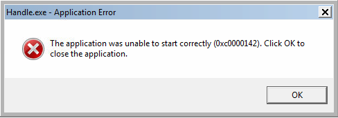

gooch Posted December 12, 2014 Posted December 12, 2014 File Watcher is great, it's allowing me to make console graphics for the Main Menu. I'm having one problem though. I have my power button on my HyperSpin PC set to quickly soft-shutdown Windows, and this has always worked with very little issue until I started using File Watcher. Now if I hit the power button when HyperSpin is in the Main Menu it gives the error message below. It eventually shuts down, but it's kinda messy. Shutting down from System Menus do not cause any problem.
sevenseal Posted December 12, 2014 Posted December 12, 2014 have you set handle.ex as admin, mean8ng with admin rights?
gooch Posted December 13, 2014 Posted December 13, 2014 have you set handle.ex as admin, mean8ng with admin rights? Well that fixed it. If that's in the doc I skimmed over it.
