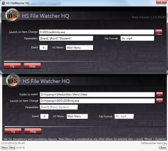

zorg2000k Posted February 7, 2015 Posted February 7, 2015 Hi trying to follow the instructions in post #188, but when i'm setting up HSFileWatcherHQ.exe is not the same as ? Its missing the folder to watch ?
sevenseal Posted February 7, 2015 Posted February 7, 2015 Hi trying to follow the instructions in post #188, but when i'm setting up HSFileWatcherHQ.exe is not the same as ?Its missing the folder to watch ? [ATTACH=CONFIG]50126[/ATTACH] your hsfilewatcher is updated to the most current revision which is 1.1, the picture used in the instruction is 1.0, that entry line was removed in 1.1

zorg2000k Posted February 9, 2015 Posted February 9, 2015 HSFileWatcher <?xml version="1.0" encoding="utf-8"?> <Preferences xmlns:xsi="http://www.w3.org/2001/XMLSchema-instance" xmlns:xsd="http://www.w3.org/2001/XMLSchema"> <Event>9</Event> <HSSystem>Main Menu</HSSystem> <FileFormat>.flv, .mp4</FileFormat> <ApplicationPath>E:\EDS\Ledblinky.exe</ApplicationPath> <ApplicationParameters>[Event] "[Rom]" "[system]"</ApplicationParameters> </Preferences> EDS <?xml version="1.0" standalone="yes"?> <NewDataSet> <EDS> <ID>d369e7244ff249f6b08ba371974b942b</ID> <Path>E:\Hyperspin\LEDBlinky\LEDBlinky.exe</Path> <Application>LEDBlinky</Application> <Close>false</Close> <PID>3264</PID> <IPC>CLI</IPC> <Running>false</Running> <Kill /> <Parameters>[ledblinky]</Parameters> <RunningFlash /> <Disable>false</Disable> <IPCID /> <EventFilter /> <CloseEvent /> <RelativePath>../Hyperspin/LEDBlinky/LEDBlinky.exe</RelativePath> </EDS> <EDS> <ID>9d2a9d684aa74257870fe3847aa04b0d</ID> <Path>E:\Hyperspin\HyperLaunch\HyperMarquee\Hyper Marquee.exe</Path> <Application>Hyper Marquee</Application> <Close>false</Close> <PID>7544</PID> <IPC>Pipe (CLI)</IPC> <Running>false</Running> <Kill /> <Parameters>false MAME-HS-Marquee_Artwork "[game]" "[system]"</Parameters> <RunningFlash /> <Disable>false</Disable> <IPCID>MAME-HS-Marquee_Artwork</IPCID> <EventFilter>1,3,7,9</EventFilter> <CloseEvent>2,4,6,11</CloseEvent> <SystemFilter /> <RelativePath>../Hyperspin/HyperLaunch/HyperMarquee/Hyper Marquee.exe</RelativePath> </EDS> <EDS> <ID>0f11d943f95b4846b425c637baa5d0d0</ID> <Path>E:\EDS\HSfileWatcher\HSFileWatcher.exe</Path> <Application>HSFileWatcher</Application> <Close>false</Close> <PID>8396</PID> <IPC>CLI</IPC> <Running>false</Running> <Kill /> <Parameters /> <RunningFlash /> <Disable>false</Disable> <IPCID /> <EventFilter>8</EventFilter> <CloseEvent>2,6,11</CloseEvent> <SystemFilter /> <RelativePath>HSfileWatcher/HSFileWatcher.exe</RelativePath> </EDS> <EDS> <ID>f0d3ed5d9ac14f529f8df2b002b83d81</ID> <Path>E:\EDS\PipesServerTest.exe</Path> <Application>PipesServerTest</Application> <Close>false</Close> <PID>5724</PID> <IPC>Pipe (CLI)</IPC> <Running>false</Running> <Kill /> <Parameters>false MAME-HS-Marquee_Artwork "[game]" "[system]"</Parameters> <RunningFlash /> <Disable>true</Disable> <IPCID /> <EventFilter>1,3,9</EventFilter> <CloseEvent>2,4,6,11</CloseEvent> <RelativePath>PipesServerTest.exe</RelativePath> </EDS> <EDS> <ID>8a327f0ba689411393c7236e79b188b0</ID> <Path>E:\Hyperspin\HyperLaunch\HyperMarquee\Hyper Marquee.exe</Path> <Application>Hyper Marquee</Application> <Close>false</Close> <PID>3220</PID> <IPC>Pipe (CLI)</IPC> <Running>false</Running> <Kill /> <Parameters>false MAME-Digital_Text "[game]" "[system]"</Parameters> <RunningFlash /> <Disable>true</Disable> <IPCID>MAME-Digital_Text</IPCID> <EventFilter>3,9</EventFilter> <CloseEvent>2,4,6,11</CloseEvent> <SystemFilter>mame</SystemFilter> <RelativePath>../Hyperspin/HyperLaunch/HyperMarquee/Hyper Marquee.exe</RelativePath> </EDS> <EDS> <ID>63dc63cec2f64d0f87427942dc3e1935</ID> <Path>E:\EDS\PipesServerTest.exe</Path> <Application>PipesServerTest 2</Application> <Close>false</Close> <PID>5132</PID> <IPC>Pipe (CLI)</IPC> <Running>false</Running> <Kill /> <Parameters>false MAME-Digital_Text "[game]" "[system]"</Parameters> <RunningFlash /> <Disable>true</Disable> <IPCID /> <EventFilter>3,9</EventFilter> <CloseEvent>2,4,6,11</CloseEvent> <RelativePath>PipesServerTest.exe</RelativePath> </EDS> </NewDataSet>
sevenseal Posted February 9, 2015 Posted February 9, 2015 HSFileWatcher 9 Main Menu .flv, .mp4 E:\EDS\Ledblinky.exe [Event] "[Rom]" "[system]" EDS d369e7244ff249f6b08ba371974b942b E:\Hyperspin\LEDBlinky\LEDBlinky.exe LEDBlinky false 3264 CLI false [ledblinky] false ../Hyperspin/LEDBlinky/LEDBlinky.exe 9d2a9d684aa74257870fe3847aa04b0d E:\Hyperspin\HyperLaunch\HyperMarquee\Hyper Marquee.exe Hyper Marquee false 7544 Pipe (CLI) false false MAME-HS-Marquee_Artwork "[game]" "[system]" false MAME-HS-Marquee_Artwork 1,3,7,9 2,4,6,11 ../Hyperspin/HyperLaunch/HyperMarquee/Hyper Marquee.exe 0f11d943f95b4846b425c637baa5d0d0 E:\EDS\HSfileWatcher\HSFileWatcher.exe HSFileWatcher false 8396 CLI false false 8 2,6,11 HSfileWatcher/HSFileWatcher.exe f0d3ed5d9ac14f529f8df2b002b83d81 E:\EDS\PipesServerTest.exe PipesServerTest false 5724 Pipe (CLI) false false MAME-HS-Marquee_Artwork "[game]" "[system]" true 1,3,9 2,4,6,11 PipesServerTest.exe 8a327f0ba689411393c7236e79b188b0 E:\Hyperspin\HyperLaunch\HyperMarquee\Hyper Marquee.exe Hyper Marquee false 3220 Pipe (CLI) false false MAME-Digital_Text "[game]" "[system]" true MAME-Digital_Text 3,9 2,4,6,11 mame ../Hyperspin/HyperLaunch/HyperMarquee/Hyper Marquee.exe 63dc63cec2f64d0f87427942dc3e1935 E:\EDS\PipesServerTest.exe PipesServerTest 2 false 5132 Pipe (CLI) false false MAME-Digital_Text "[game]" "[system]" true 3,9 2,4,6,11 PipesServerTest.exe hi zong, well for one I see for your on EDS; MAME-HS-Marquee_Artwork the events you would like that you are seeking should be 1,3,8,9 instead of 7 in the set. 8 is the event trigger for when list item change when hovering next suggestions is to disable/delete pipe server test.exe in eds MAME-Digital_Text I can tell this is disable but i would then delete the second entry for MAME-Digital_Text because this is all just testing communication with pipe server test.exe everyrhing look right on eds/hypermarquee front.... one question, are you using windows 8.1? if not then it is time to check your hypermarquee marquee config file, could you head over to that thread and post it there? sevenseal
zorg2000k Posted February 9, 2015 Posted February 9, 2015 hi zong,well for one I see for your on EDS; MAME-HS-Marquee_Artwork the events you would like that you are seeking should be 1,3,8,9 instead of 7 in the set. 8 is the event trigger for when list item change when hovering next suggestions is to disable/delete pipe server test.exe in eds MAME-Digital_Text I can tell this is disable but i would then delete the second entry for MAME-Digital_Text because this is all just testing communication with pipe server test.exe everyrhing look right on eds/hypermarquee front.... one question, are you using windows 8.1? if not then it is time to check your hypermarquee marquee config file, could you head over to that thread and post it there? sevenseal Still not working for me, could someone post a working EDS, Hyper Marquee and HSFileWatcher for the following ? That way I'd be able to check my settings or start a fresh Main HS Menu marquee's and system marquees.
