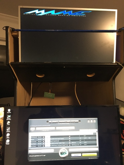

aarikg Posted November 22, 2017 Posted November 22, 2017 52 minutes ago, mamefan said: In your EDS pic, you have hypermarquee twice. That might cause an issue. Really, I was thinking I could have multiple(that was the panels I was talking about on your video), I was hoping that I could run a third monitor mounted on the wall showing Flyers and other game art. I have seen it done on a video I thought was hyper Marquee. I will try that tonight too. I found the link ...

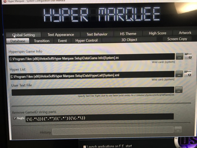

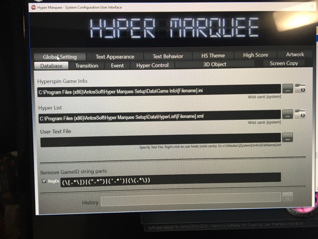

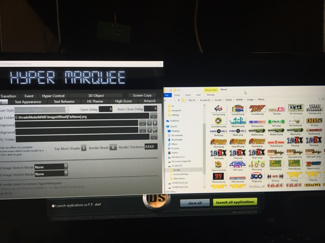

aarikg Posted November 24, 2017 Posted November 24, 2017 Ok here is another question, I started out with an old hyperspin I loaded a version of watcher that I didn't set up after reading that with Hyperspin 1.4 I didn't need it(grabbed that exe and dumped it in) . I was fumbling around and low and behold Hyper marquee started working(kind of). The system marquess show up and some of the Marquees(I thought) were working. I started a new Hypermarquee and set all of the paths correctly after re-reading instructions and watching videos and figuring out what was going on. I now have one setup that all the "games" are using the marquees and if not the then the wheel art but the systems will not show up. I have verified the paths and they are correct I even opened the XML files and verified they were correct and they were. This made me go look at the first marquee again thats when i realized the "system" path was not even close to the right path and the "games" path was correct however I noticed that the images it was using were not the marquee images from that folder, I have no idea where they are coming from. Whew I guess I am wondering if the paths can determined somewhere else? or what else could I have going on? I am sure we will get this figured out however I just am thinking about purchasing a stretch monitor and want it all working on this test monitor before I make the plunge.

aarikg Posted November 25, 2017 Posted November 25, 2017 Sevenseal or Antos anything jump out at what I am talking about it is a fresh install of Windows 10 with the Arcade flies on a separate hard drive. I just can’t quite firgure out why it sometimes is not using the path I have in hyper marquee.
sevenseal Posted November 26, 2017 Posted November 26, 2017 Sevenseal or Antos anything jump out at what I am talking about it is a fresh install of Windows 10 with the Arcade flies on a separate hard drive. I just can’t quite firgure out why it sometimes is not using the path I have in hyper marquee.give a current path in the setting, a screenshot will help?Sent from my SM-G928V using Tapatalk

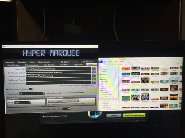

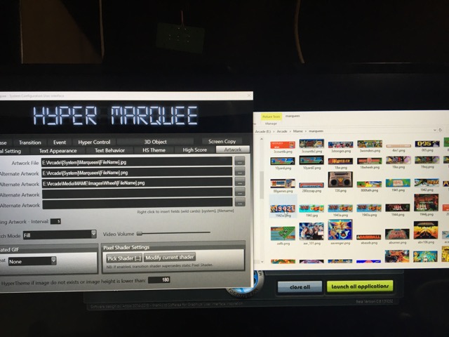

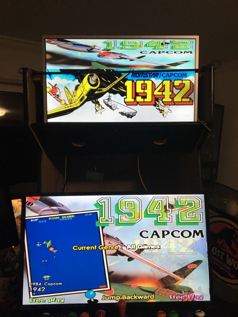

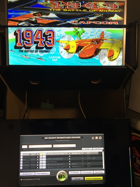

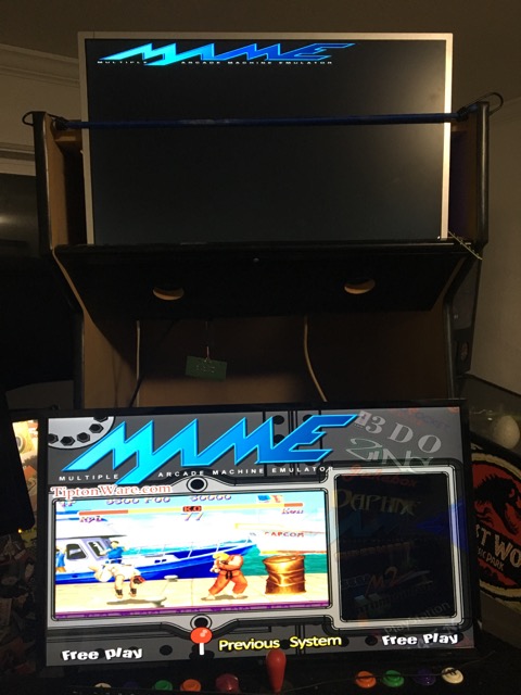

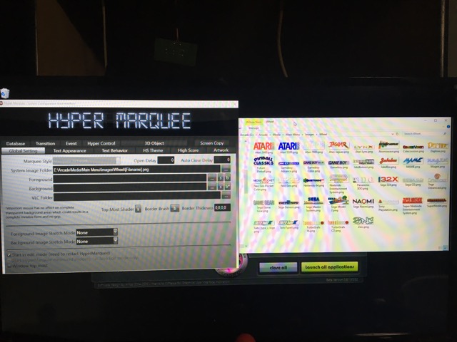

aarikg Posted November 27, 2017 Posted November 27, 2017 2 hours ago, sevenseal said: give a current path in the setting, a screenshot will help? Sent from my SM-G928V using Tapatalk Ok lets try this again sorry if I am talking in circles, and I already know SWEET bungee cord. OK I enabled both to hopefully show what I am talking about. the top of the top monitor is the Marquee_Aarik and the bottom of the top screen is the Marquee_Final. The first picture (sorry about using pictures I was trying to not have this machine ever touch the network but that may have to change) any way 1 in the Event then Mame then Main menu you can see the "final" shows nothing for system, the I used 1 1943 and Mame I just figured out that the "top" or Marquee_Aarik one is using the hyperspin artwork and I have no idea how. he next two are showing the same thing but through Hyperspin, The next three are settings for the 'top" or Marquee_Aarik as you can see the paths are not correct I show the path next to the settings.The next are the paths from the bottom or Final they work great except the System path again I show the folder appears to be correct. I hope this helps again I appreciate all the help I would love a better understanding of how this works behind the scenes in EDS why the Hyperspin artwork path is getting used, I can change the path to something crazy it will still show that art work in that(Marquee_Aarik)one.

sevenseal Posted December 2, 2017 Posted December 2, 2017 here is your issue.. 1. on the main menu.... the system is consider main_menu, that is a different directory source path than your mame source... it is showing blank/black/nothing because it cant find the file needed and the directory is not listed in HM. to fix that you need to either use a system wildcard in your directory listing for your source or another individual add a alternative source. 2. extenstion do matter, make your library is all the same. better yet dont add an extenstion when you use the wildcard [FileName] so that it can use any image without the limitation of what extenstion that you set 3. i see issue on eds setting, but that problem is not for this thread to discuss on, this is HM thread. Sent from my SM-G928V using Tapatalk
aarikg Posted December 4, 2017 Posted December 4, 2017 On 12/2/2017 at 9:06 AM, sevenseal said: here is your issue.. 1. on the main menu.... the system is consider main_menu, that is a different directory source path than your mame source... it is showing blank/black/nothing because it cant find the file needed and the directory is not listed in HM. to fix that you need to either use a system wildcard in your directory listing for your source or another individual add a alternative source. OK I see now it goes in the Artwork folder and I was missing a Bracket, I still don't understand what the system image folder is but.. for now I guess its doing what I want. 2. extenstion do matter, make your library is all the same. better yet dont add an extenstion when you use the wildcard [FileName] so that it can use any image without the limitation of what extenstion that you set Took care of this also thanks 3. i see issue on eds setting, but that problem is not for this thread to discuss on, this is HM thread. Anywhere we could? I have LED buttons and a new Ipac coming would love to get LED Blinky working through EDS. Sent from my SM-G928V using Tapatalk
