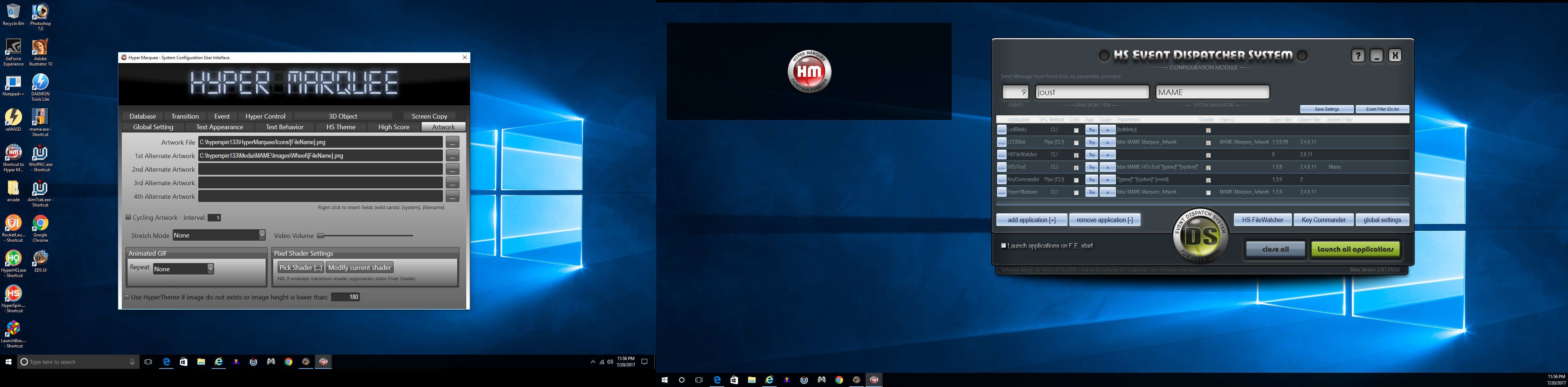

TpsKevin Posted July 21, 2017 Posted July 21, 2017 Hi, I'm having an issue that I haven't been able to find the answer to. I apologize in advance if this has been covered before and I missed it in the 40+ pages on HM. My issue is with the wild card function. With the [filename].png wild card inserted in my path to marquee art I get a blank marquee or the HM logo to display only. This happens when using the "try" or "launch all applications" or when HS is launched. If I change the wild card to "1943.png" for example, the 1943 marquee displays fine. Of course it displays 1943 no matter what game I'm actually playing. Unfortunately I'm an auto mechanic not a computer genius like most everyone on here seems to be. Any additional information you need from me I will do my best to supply. Thank you for any help you can give me and for making HM.
sevenseal Posted July 21, 2017 Posted July 21, 2017 are you using eds along with hypernarquee?hypermarquee doesnt work standalone by itself if not, that is easiest way to get function without much issue is to setup eds with itSent from my SM-G928V using Tapatalk
TpsKevin Posted July 21, 2017 Posted July 21, 2017 yes I'm using EDS. No HL or RL. It is strictly a MAME cabinet. I7, windows 10.
sevenseal Posted July 21, 2017 Posted July 21, 2017 please post a screenshot of your eda setting from the gui?
DarthVetter Posted July 21, 2017 Posted July 21, 2017 Your not calling an "game" "system" or "event" on EDS when you call for HyperMarquee false MAME-Marquee_Artwork "[game]" "[system]" "" [event] - this is how mine looks and runs perfect
TpsKevin Posted July 22, 2017 Posted July 22, 2017 Getting closer thanks for the help so far. I put in "[game]" "[system]" [event] in my parameters now when in EDS I get the correct marquee image when using the "try" or "launch all applications" buttons. But when I launch HS I still get a blank marquee. It seems HS is sending the info to EDS??? but no image just shaded grey marquee.
DarthVetter Posted July 22, 2017 Posted July 22, 2017 Your missing two quote marks between the one after system and before event. Try checking our CBR as well. I am still kind of new I could be wrong but I will try and help you figure this out.

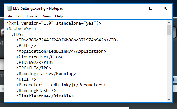

sevenseal Posted July 22, 2017 Posted July 22, 2017 35 minutes ago, TpsKevin said: Getting closer thanks for the help so far. I put in "[game]" "[system]" [event] in my parameters now when in EDS I get the correct marquee image when using the "try" or "launch all applications" buttons. But when I launch HS I still get a blank marquee. It seems HS is sending the info to EDS??? but no image just shaded grey marquee. vader is correct about the missing parameters, in addition you do not need [event] portion unless you use events type wildcards for such as speak or sound, or similar things ex; false MAME-Marquee_Artwork "[game]" "[system]" it should look like this next question, in the eds folder did you rename the module file to Ledblinky.exe?
