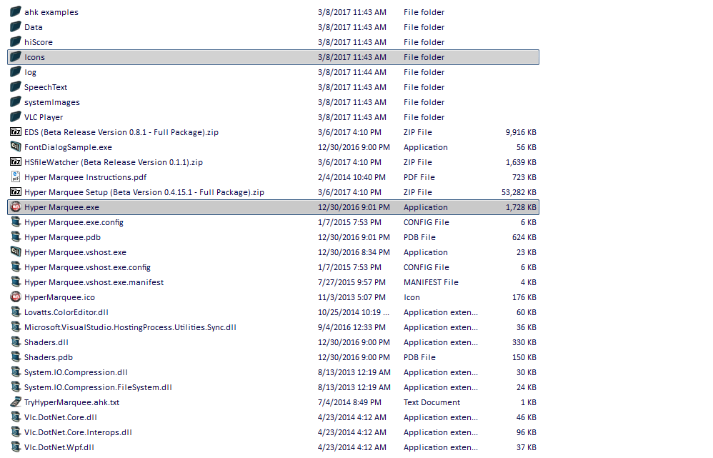

sandman7793 Posted March 8, 2017 Posted March 8, 2017 Question: When I close HyperMarquee after the configuration, where does it save the xml? I cant seem to get it to save the config file correctly, even if I do save as. Maybe because windows 10? I need a little help. Thank you for the program. A boy stuck in a mans body
Antos Posted March 8, 2017 Author Posted March 8, 2017 6 hours ago, sandman7793 said: Question: When I close HyperMarquee after the configuration, where does it save the xml? I cant seem to get it to save the config file correctly, even if I do save as. Maybe because windows 10? I need a little help. Thank you for the program. Have a look in settings. It will save it with the name you have provided when you created it. HyperMarquee & Event Dispatch System
sandman7793 Posted March 8, 2017 Posted March 8, 2017 6 minutes ago, Antos said: Have a look in settings. It will save it with the name you have provided when you created it. Which settings? Hyperspin settings folder? A boy stuck in a mans body
Antos Posted March 8, 2017 Author Posted March 8, 2017 Just now, sandman7793 said: Which settings? Hyperspin settings folder? HyperMarquee HyperMarquee & Event Dispatch System
sandman7793 Posted March 8, 2017 Posted March 8, 2017 Just now, Antos said: HyperMarquee Guess I did something wrong, there's no settings folder in there. A boy stuck in a mans body
Antos Posted March 8, 2017 Author Posted March 8, 2017 Try to create a new marquee and simply exit and see if it will create the folder with the file automatically.. I can't remember.. HyperMarquee & Event Dispatch System
sandman7793 Posted March 8, 2017 Posted March 8, 2017 6 minutes ago, Antos said: HyperMarquee Ok I created a settings folder and it saved. A boy stuck in a mans body
sandman7793 Posted March 8, 2017 Posted March 8, 2017 1 minute ago, Antos said: Try to create a new marquee and simply exit and see if it will create the folder with the file automatically.. I can't remember.. I tried that like 10 times. I created it and it worked. A boy stuck in a mans body
Antos Posted March 9, 2017 Author Posted March 9, 2017 Ok, first time I see that... I will remember it and see if something can be done in the future. HyperMarquee & Event Dispatch System
sandman7793 Posted March 9, 2017 Posted March 9, 2017 1 minute ago, Antos said: Ok, first time I see that... I will remember it and see if something can be done in the future. All good. Thanks for your help!! Thank you for the program. Now ill see if I can get the rest. A boy stuck in a mans body
