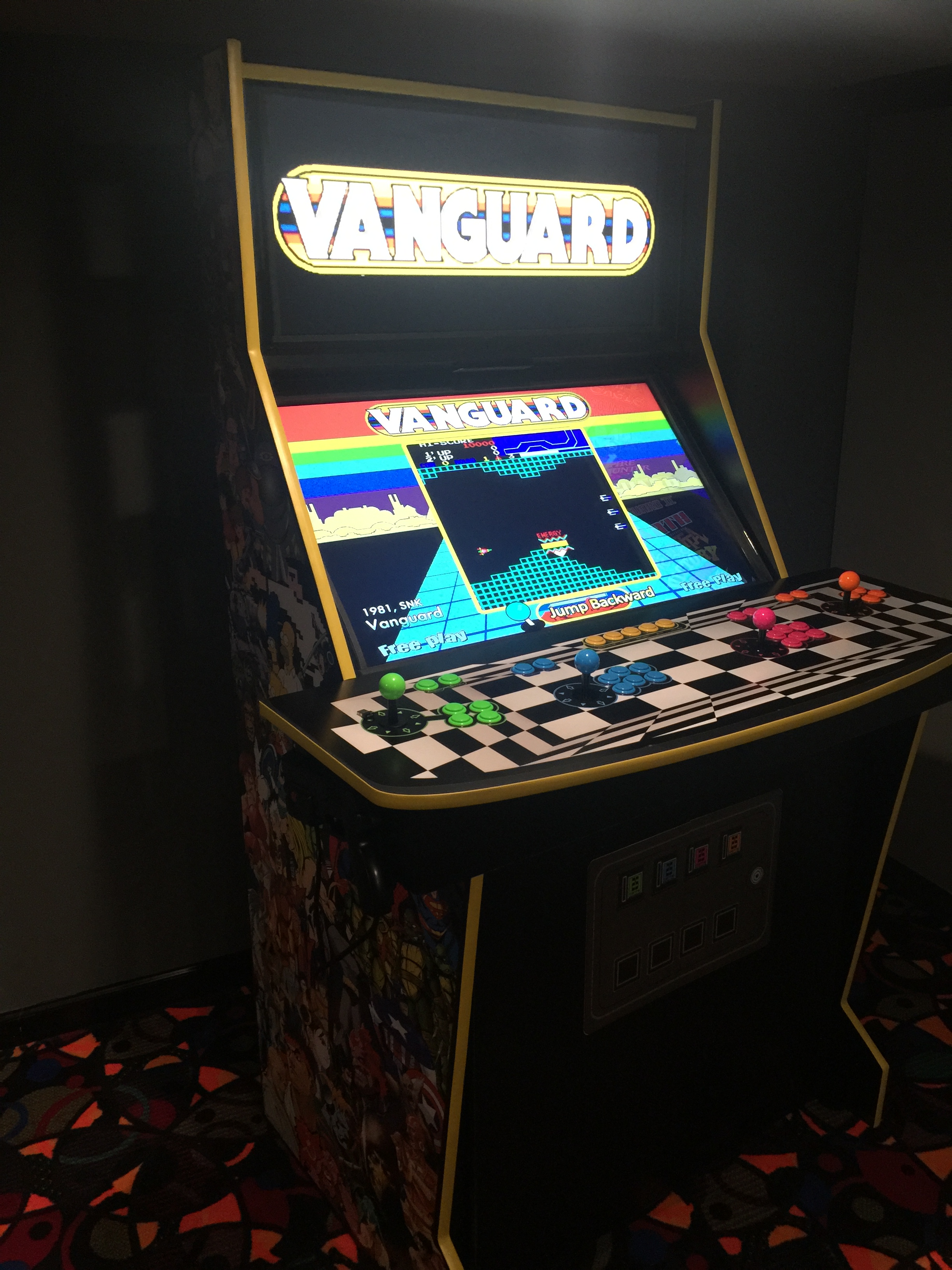

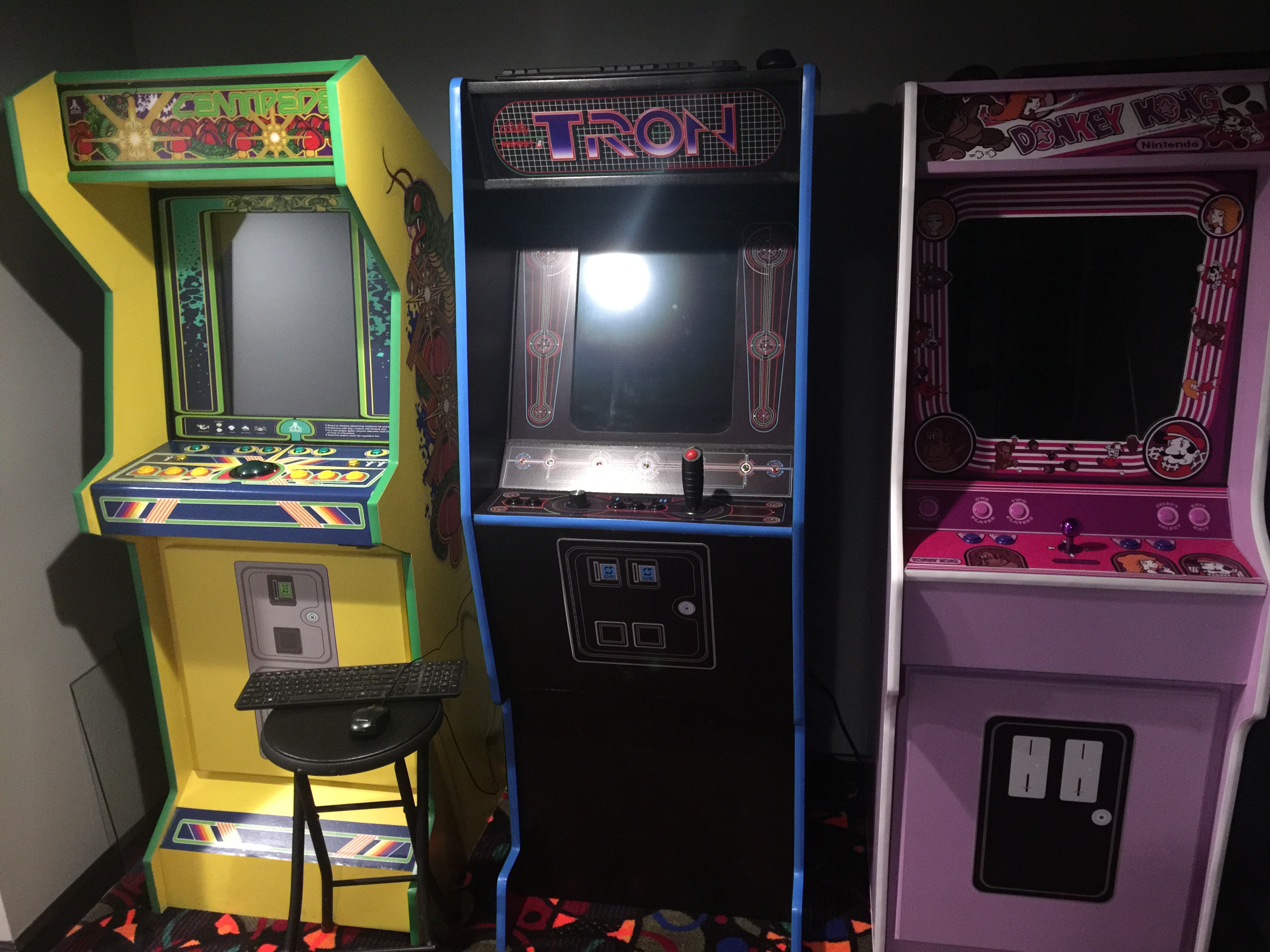

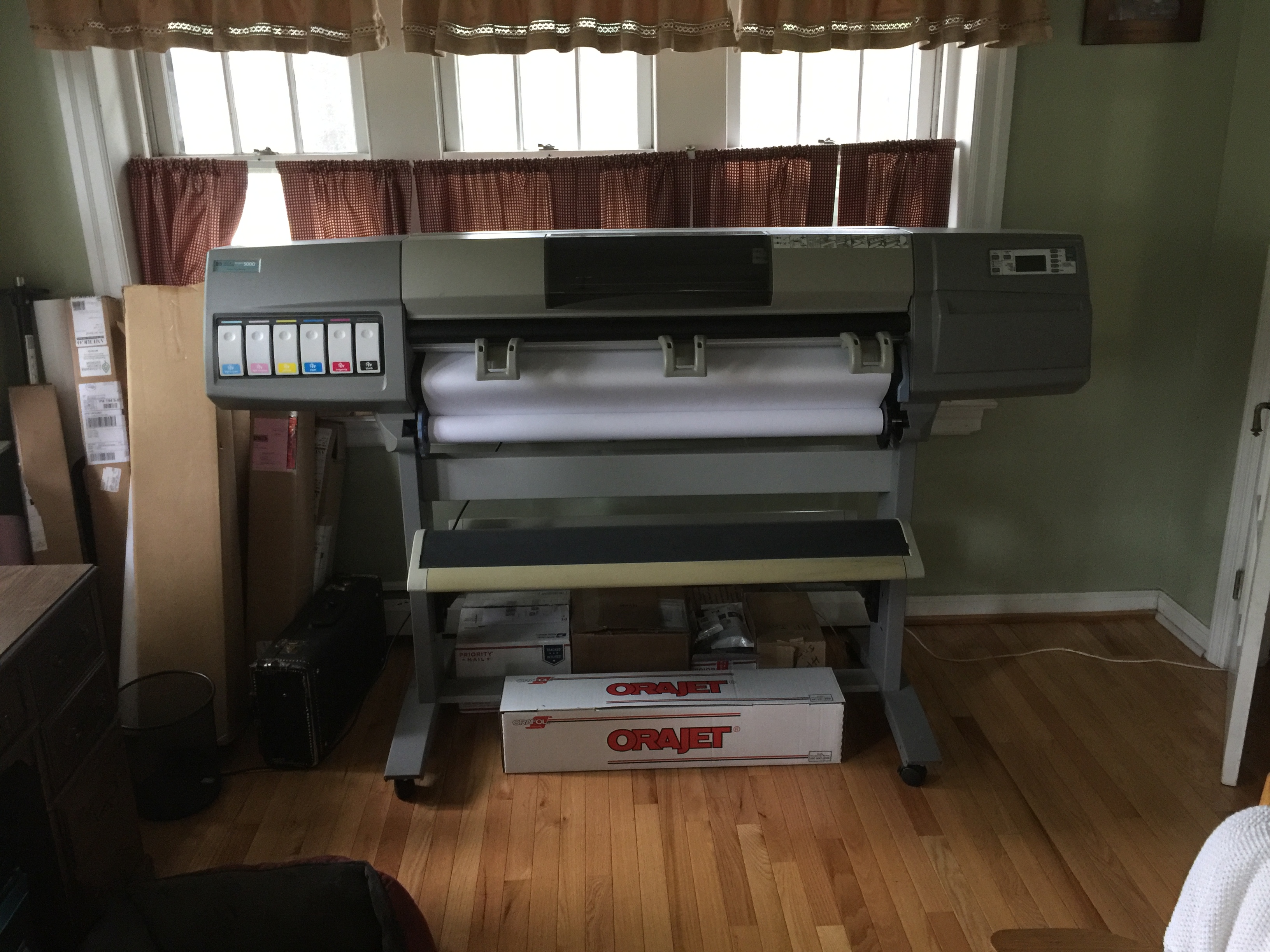

TpsKevin Posted July 25, 2017 Posted July 25, 2017 all right windows 10 sucks. formatted the hard drive. put in fresh windows 7. now HM works perfectly. Thanks for all of your help sevenseal and darthvetter if either of you or antos need any art printed up let me know. I put in some pics of the cabs I've built so far (I printed all the art, gotta love craigslist). Still have to make the smash tv for my two stick set up. Then maybe a driving cab, hahaha. thanks again
Antos Posted July 25, 2017 Author Posted July 25, 2017 Awesome and beautiful! This is what I call a real professional printer! Thanks for sharing and the donation! HyperMarquee & Event Dispatch System
sevenseal Posted July 25, 2017 Posted July 25, 2017 1 hour ago, TpsKevin said: all right windows 10 sucks. formatted the hard drive. put in fresh windows 7. now HM works perfectly. Thanks for all of your help sevenseal and darthvetter if either of you or antos need any art printed up let me know. I put in some pics of the cabs I've built so far (I printed all the art, gotta love craigslist). Still have to make the smash tv for my two stick set up. Then maybe a driving cab, hahaha. thanks again i like the look of that machine lol... windows 10 is great honestly.... one major thing you have to do from the start is disable UAC.... that system is a nightmare for developer/3rd party apps. once gones... its a piece of heaven, personal i would suggest you to try 10 again with uac off, it is night and day
