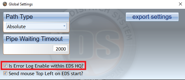

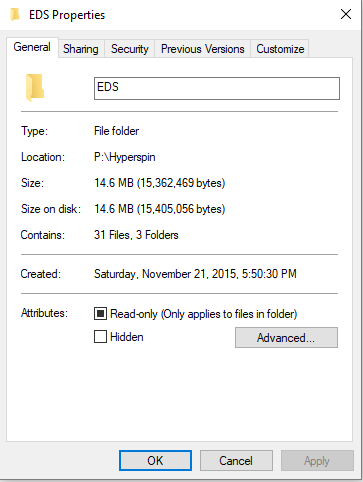

sevenseal Posted June 23, 2018 Posted June 23, 2018 20 minutes ago, Gilrock said: Yes I checked for a log file in the EDS folder yesterday and didn't see it creating one. You know people are treating me like I'm the first one to want to use EDS in RocketLauncher but its listed right there in the RL Wiki. Right here on this page it says "Integration with EDS" which made me think it was reasonable to ask if anyone has that working. RocketLauncher_Daemon eds require you to set true in the parameter to in the global setting tab once save correctly it will build a log, you might have your eds root folder lock down that will prevent it from being produce if your system allows folder/file structure have the permissions to create a file in the directory.
sevenseal Posted June 23, 2018 Posted June 23, 2018 here is a example when the folder is lockdown.... you will see the box filled in where it is label as "Read-Only"

Gilrock Posted June 23, 2018 Posted June 23, 2018 Thanks I'll check those settings for the log. Yes I already had EDS working from a batch file. Sevenseal gave me a tip that seems to have RL sending events now. I had ledblinkyEnabled set to "true" but he suggested I use "All". I made the change and now I see these entries in the RL log. 19:38:23:028 | MD | INFO | +0 | LEDBlinky - Started, sending mode START 19:38:23:028 | MD | INFO | +0 | Run - Running: M:\EDS\LEDBlinky.exe "joust" "MAME" 19:38:23:207 | MD | INFO | +187 | LEDBlinky - Ended 19:38:44:693 | MD | INFO | +0 | LEDBlinky - Started, sending mode END 19:38:44:737 | MD | INFO | +46 | LEDBlinky - Ended That's still not displaying a marquee the way I had EDS setup because I usually send parameters like "1 joust MAME" to load and "2 joust MAME" to unload.
