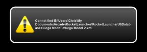

chriswalsh41 Posted August 28, 2016 Posted August 28, 2016 I know this may be old now but I had the same problem and still cannot find a solution anywhere, so here's what I did and it works! Nothing to do with running as administrator, try to load a game in Hyperspin and if the error message is anything like mine it says cannot find RocketLauncher\RocketLauncherUI\Databases\Sega Model 2\Sega Modle 2.xml (or whatever emulator you're trying to run, see attached image). This is because the Databases folder which contains all the required .xml files is not in the RocketLauncherUI folder but actually in Hyperspin\Databases. So I just went to my Hyperspin folder, copied the Databases folder and pasted it into RocketLauncher\RocketLauncherUI\, it replaces the existing databases folder and your games work through Hyperspin. This probably isn't the correct way to do it, but I've tried all the other suggestions and nothing worked. Hope this helps.
tanuki Posted September 6, 2016 Posted September 6, 2016 This has just bitten me. I just changed the Settings.ini file for HyperSpin to point to RocketLauncher.exe in place of HyperLaunch. I have taken the above steps (long in the past, verified just now) and the error message I see (when trying to launch a game in MAME in this example) is: "Cannot find S:\RocketLauncher\RocketLauncherUI\Databases\MAME\MAME.xml" Indeed, there is no such file. When I launch anything (MAME, or any number of other emulators) from RocketLauncherUI everything works fine. RocketLauncher version is 1.0.1.7. HyperSpin is version 1.4.16. Any suggestions?
