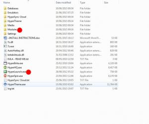

Download and extract HyperSpin 1.3.3 to your chosen location. Delete the Modules folder and the HyperLaunch.exe from the folder.
post-2819-0-17049400-1433926059_thumb.jp

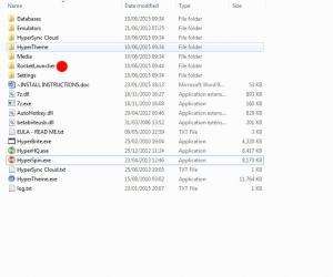

Extract RocketLauncher, you can put it anywhere but make sure it stays in a folder.
Here I have placed it in the HyperSpin root.
post-2819-0-95500400-1433926158_thumb.jp
Download the HyperSpin 1.4 beta and place in the root HS folder overwriting the original.

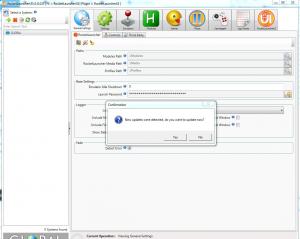

That's the install done, you can now navigate to your RocketLauncherUI folder and run the RocketLauncherUI.exe
On first run RLUI will tell you there are updates available, click yes and follow the instructions to install the updates.
post-2819-0-59615000-1433926819_thumb.jp

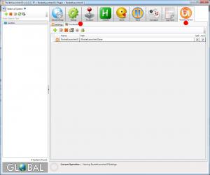

Once complete you will notice there are no systems present in the left hand pane. To populate that you need to tell RLUI which Frontend you are using.
Click the large RocketLauncherUI tab then the smaller Frontends tab.
post-2819-0-23116000-1433927029_thumb.jp

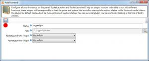

This window should pop up.
post-2819-0-55552600-1433929837_thumb.jp
You need to give the new frontend a name so type HyperSpin as the name.
Add the path to HyperSpin by clicking the magnifying glass and browsing to the HyperSpin.exe.
Now select the RocketLauncherUI Plugin and RocketLauncher Plugin, selecting HyperSpin for both.
Click the post-2819-0-86027700-1433927543.jpg button to save the settings.

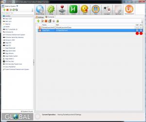

In the frontends list click HyperSpin to highlight it.
You now need to set it as the "Default Frontend" and the "Active Frontend", do that by clicking the post-2819-0-33245000-1433927742.jpg and post-2819-0-29996900-1433927765.jpg buttons.
You should now have two check marks in the boxes next HyperSpin and a fully populated list.
post-2819-0-28290600-1433928020_thumb.jp
