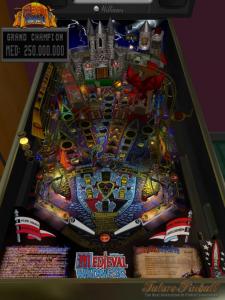

zauche Posted April 5, 2013 Posted April 5, 2013 I've a selfrotating 4:3 monitor and play future pinball on it. Works perfectly in 1200x1600. --> I'd definately go with a 4:3 screen if you do not want to just play pinball.
cmoses Posted April 6, 2013 Posted April 6, 2013 I've a selfrotating 4:3 monitor and play future pinball on it. Works perfectly in 1200x1600. --> I'd definately go with a 4:3 screen if you do not want to just play pinball.[ATTACH=CONFIG]25765[/ATTACH] Is that self-rotating monitor in a cocktail? Do you have any info on it, a build thread? I would interested in taking a look. Sent from my iPad Mini using Tapatalk HD
bmosley Posted April 15, 2013 Author Posted April 15, 2013 how does the table look when flat on the monitor? i've never been a fan of the perspective.. can you post a pic?
zauche Posted April 18, 2013 Posted April 18, 2013 How do you change to "Flat-Mode" in Future Pinball ? I don't know !?!
