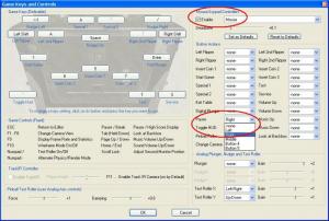

  9. Recomended settings are: [FPLaunch] exitScriptKey=q & s exitEmulatorKey=Esc toggleCursorKey=t pauseVPinball=p hideCursor=true hideDesktop=true hideTaskbar=true useExitScreen=true usePauseKey=true useLoadScreen=true fadespeed=25 UseExitAsPause=true exitEmulatorKey2=1 exitEmulatorKey3=Enter pauseFPKey=RButton saveFPTables=true Dont forget to configure RButton as pause in FP. (I will send screenshot later when i come home).
