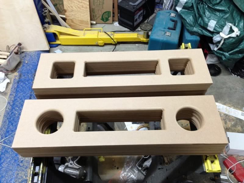

Gannicus Posted April 2, 2013 Posted April 2, 2013 Does anyone here have a to scale template that I could print out for the DMD template with speaker holes? Something preferably like the Medieval Madness front panel as seen here
shakenbake Posted April 2, 2013 Posted April 2, 2013 I have them in stock finished or unfinished in round or square holes. PM me if you are interested.
Gannicus Posted April 2, 2013 Author Posted April 2, 2013 I have them in stock finished or unfinished in round or square holes. PM me if you are interested. Thanks for the offer shakenbake! I actually enjoy the woodworking aspect of projects like this, so I'm looking to do it myself. I just need a outline I can print out to get the measurements and proper locations.
