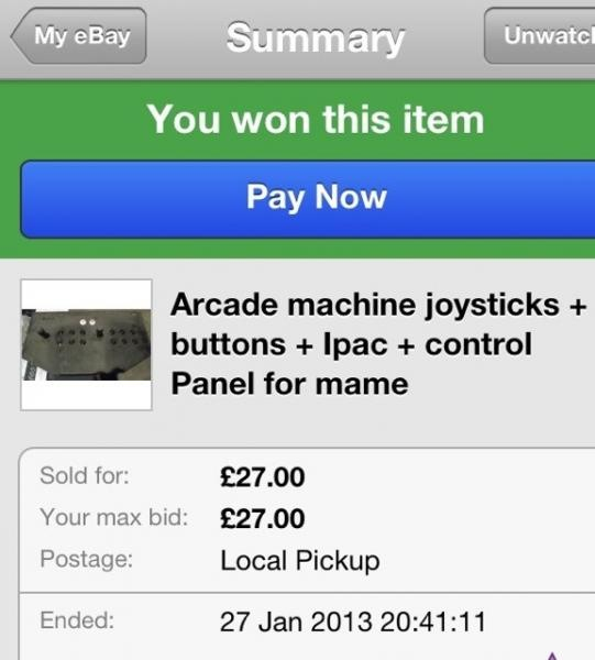

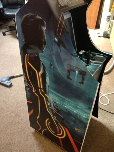

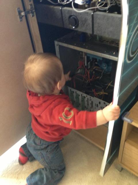

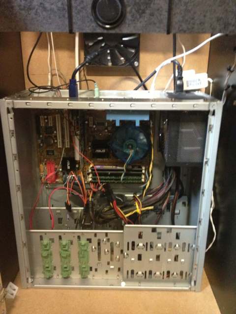

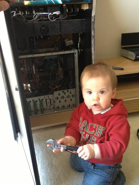

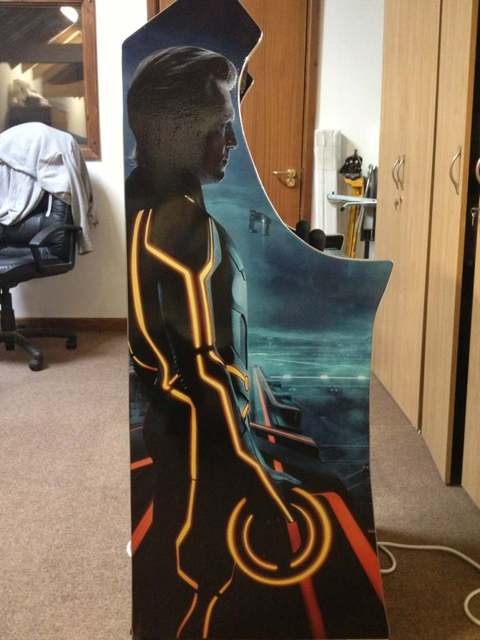

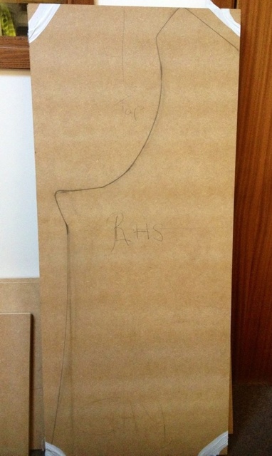

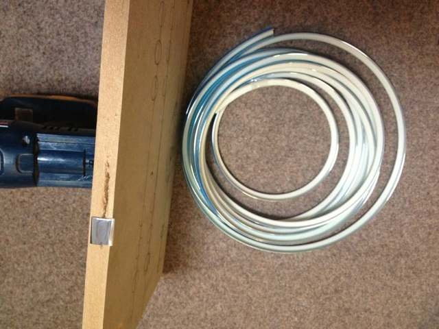

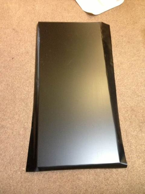

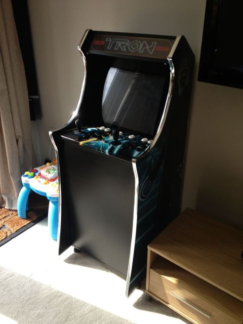

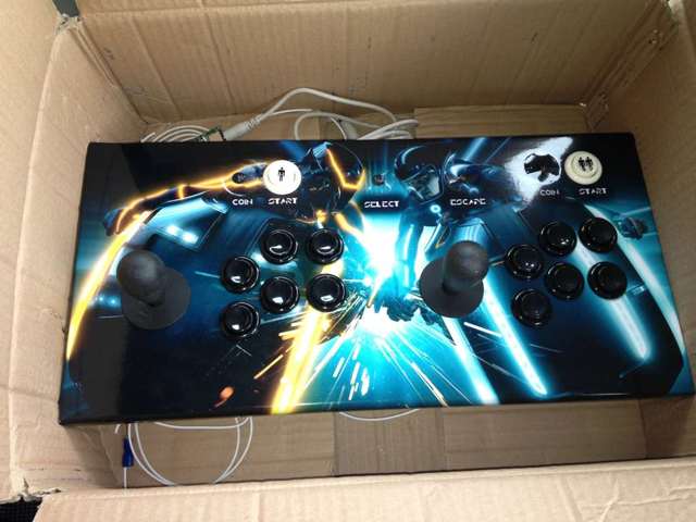

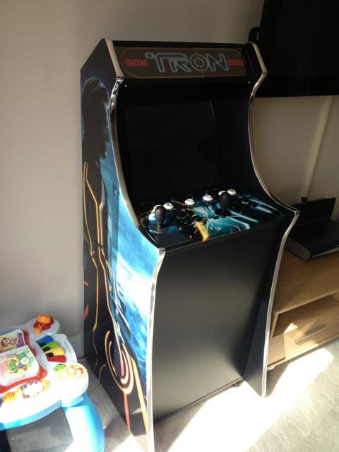

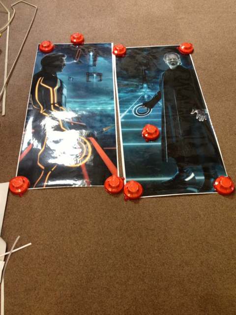

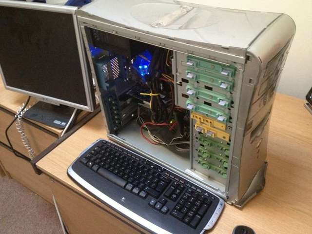

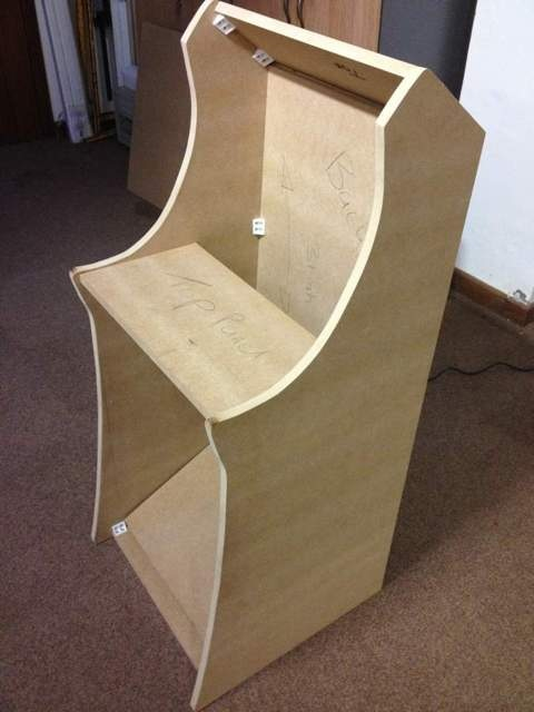

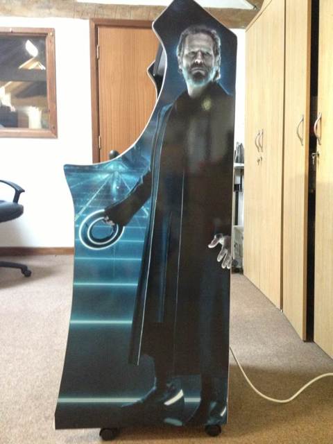

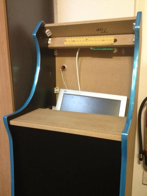

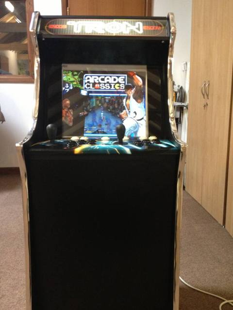

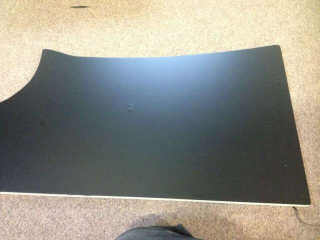

monkeychunkuk Posted April 5, 2013 Posted April 5, 2013 Tron legacy Hey, Thought id post the first machine to be finished in a separate thread, Let me thank the folks of the hyperspin forums for all the help and feed back whilst building and a huge thanks to Mike for the great artwork. This is the Tron legacy machine. It runs all the of Mame games ,Sega master system,Sega mega drive,Nes,Super Nes,Game boy advance,Game Gear The specs P4 with 4gigs of ram Nvidia Geforce 210 17 inch lcd NEC monitor 500 whatt power supply 160 Gig hard drive Led strip light for marquee Logic pro ipod speaker modded to fit Windows 64 bit ultimate installed Completely shelled with custom start up logo,welcome screen changed and windows branding removed,removed the blue spinning circle and used transparent cursor. Start up Custom Tron style Hyperspin intro movie So just to recap This machine is made from one sheet of 18mm MDF cut into pieces at my local hardware store.it 48' tall and 21' wide The non artwork faces are fitted with matt vinyl The edges are fitted with chrome T-molding The pc was bought from gum tree And i left it in its case The controls and ipac are from ebay Fitted The artwork is from my local printing company here is me fitting them And here is the finished machine (with out final glass fitted) And at home for final testing And the final thing i fitted was the lock that i got from ultracabs and Jack helped me fit it ( his only 9 months) I fitted the lock because you don't want little fingers getting into the machine whilst its running After these pics i fitted the final plexi glass and tidied the wiring and loaded it on my van ready to be taken to its new home......... g Break down cost £28 MDF and Fixing £50 Pc from gumtree £28 controls and Ipac £10 monitor £n/a speakers £10 Vinly for non artwork sides £72 all printed artwork £3.50 lock from ultracabs £2.50 for wheels £15 for plexi for marquee and screen £20 T-Molding Excluding my own time total price £239

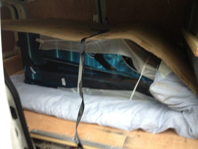

monkeychunkuk Posted April 5, 2013 Author Posted April 5, 2013 So like all things that travel it had a little problem When i set it up on location it forgot its bios setup,lucky i brought a keyboard and set it again no problem, then i moved it again its final position it did it again and also pushed the battery to make sure it wasn't loose I set it up again and left it unplugged for a minute and it started ok Im worried it maybe a recurring fault Anyone have any idea what maybe causing this? Duff batt? Loose jumper?
mikekim Posted April 5, 2013 Posted April 5, 2013 Looking good Steve.. Replace the battery on the mobo. Sent from my Samsung Galaxy Note II.
monkeychunkuk Posted April 5, 2013 Author Posted April 5, 2013 Looking good Steve..Replace the battery on the mobo. Sent from my Samsung Galaxy Note II. Cheers Mike thank you again Why would the travel effect the battery? Ohh its was in my cold van overnight

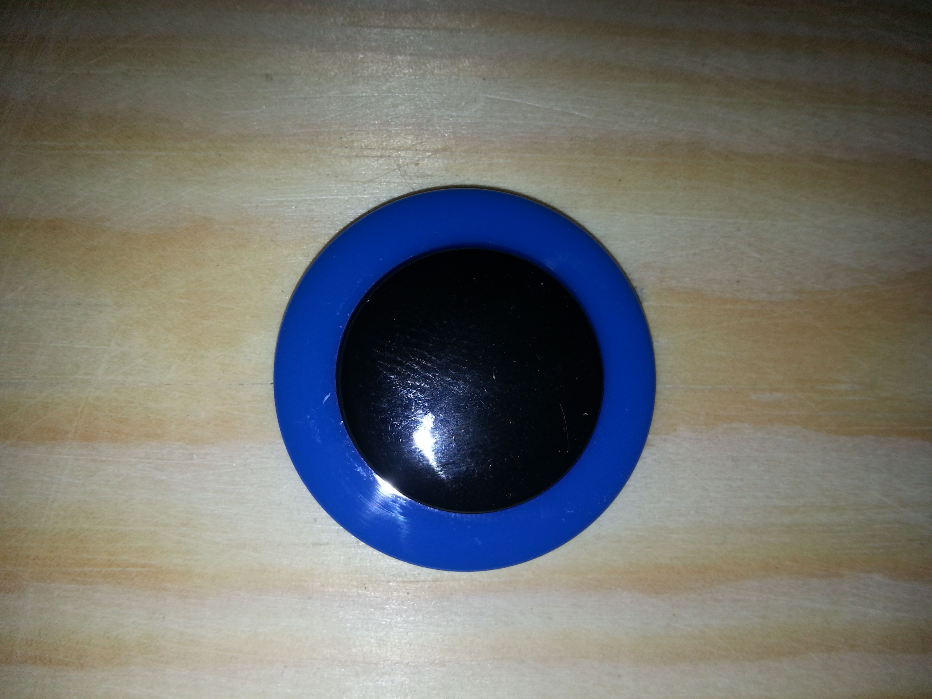

mikekim Posted April 5, 2013 Posted April 5, 2013 Steve, how about doing this with the buttons... pickup 6 blue and 6 yellow buttons (the same type as you already have) then replace the button centers with the back ones you have, so they would look like this.. cheaper than buying illuminated buttons and would work well with the Tron Theme
monkeychunkuk Posted April 5, 2013 Author Posted April 5, 2013 Ohh very nice i think ill use that idea on the second Tron cab

zomboided Posted April 8, 2013 Posted April 8, 2013 I've been looking at local printing companies for my artwork...what did you get done, just a full colour print on self adhesive vinyl? Did you have any coating on it to give it some resilience, especially on the control panel? This is a good looking build too, really clean. [sIGPIC][/sIGPIC]
monkeychunkuk Posted April 8, 2013 Author Posted April 8, 2013 I asked for high gloss front with sticky back,both machines ive put them on have held up ok, any damage im going to put down to the "realistic touch" And thank you
