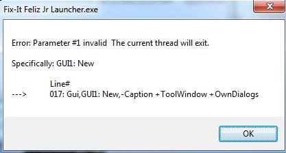

jshmupj Posted May 3, 2013 Posted May 3, 2013 compiled and now i get a n error 017....lol!!!! Warning! A huge Battleship is approaching fast!
gamesmame Posted May 3, 2013 Posted May 3, 2013 How do I put it in hyperspin using this script? because with this script it runs independent of HK hyperspin ..

mixelplick Posted May 11, 2013 Posted May 11, 2013 compiled and now i get a n error 017....lol!!!! That's the same thing I get too...did you ever find a fix?
djvj Posted May 11, 2013 Posted May 11, 2013 You need autohotkey L to use that parameter. http://l.autohotkey.net/docs/commands/Gui.htm#New "Computer games don't affect kids; I mean if Pac-Man affected us as kids, we'd all be running around in darkened rooms, munching magic pills and listening to repetitive electronic music."RocketLauncher's Official Home If you appreciate my work:My Apps:Window LoggerIdle Volume AdjusterExplorerRestorerRom Folder CleanerModule UpdaterMy Guides:How To Mod Guncons with Aimtrak
mixelplick Posted May 11, 2013 Posted May 11, 2013 Thanks djvj!!!!! Should I use this new compiler for all my Hyperspin work since it seems to work so well or should I use my old one? That did the trick. For any of you that read this, download autohotkey l (I am using win 7 64bit) then open the location and there is a new compiler. Use that one instead of what you have been using and recompile it.
