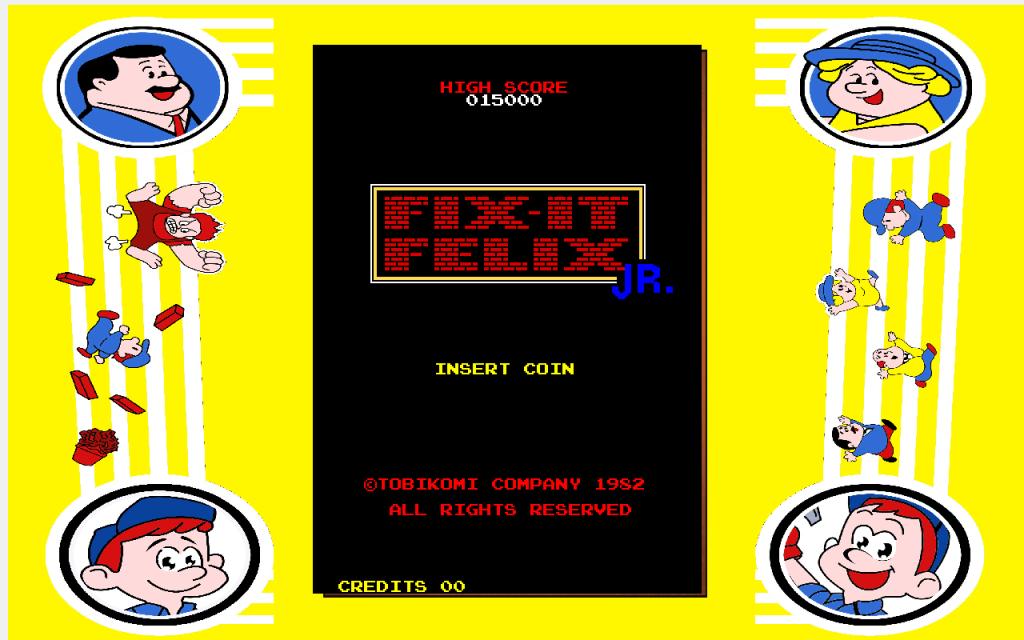

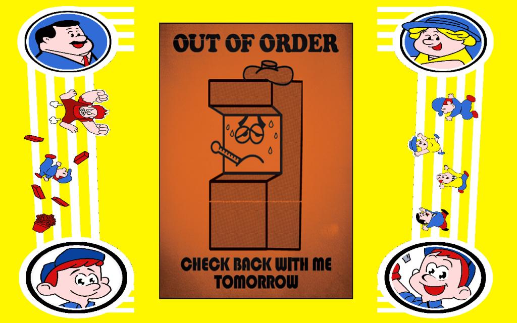

chillinwater Posted April 15, 2013 Posted April 15, 2013 I modified Djvjs script... -made a couple fixes (1)-size was locked at 200 (2)-added ability to set horizontal screen position -added control remapping -added Bezel support. (bezel.png placed in your in FIFJ.exe directory) (1)-set true to show bezel, false for No Bezel For bezel leave zoom (size) at 100 Still no true vertical fullscreen but the bezel is added to fill in the black sidebars. Exactly like Mame Bezels. The Bezel I have needs adjustment (see attachments) by the artwork gurus. This was done on a 1280x800 screen In this script..."fix it felix jr.exe" is the name of the compiled exe. If thats not what you compile it as, change this below to what it is. size=100 ; Frame Resolution-Only 33,50,100,200 are supported YAdjust=56 ; adjusts where to place game window from top of screen, negative moves up, positive moves down XAdjust=35 ; adjusts where to place game window from left side of screen, 0=allthe way to the left title=ahk_class FOCAL Test Shell exitkey=Esc ShowBezel=true ;------------------------- Hotkey, ~%exitkey%, Close WinHide ahk_class Shell_TrayWnd WinHide, ahk_class Button Gui, GUI1: New, -Caption +ToolWindow +OwnDialogs Gui, GUI1: Color, Black Gui, GUI1: Show, x0 y0 h%A_ScreenHeight% w%A_ScreenWidth% IfInString, ShowBezel, true { Gui, Add, Picture, W%A_ScreenWidth% H%A_ScreenHeight%, %a_scriptdir%\bezel.png ;WinSet,AlwaysOnTop, On, fix it felix jr.exe Gui Show, x0 y0 h%A_ScreenHeight% w%A_ScreenWidth% WinSet, Style, -0xC00000, [color=#00FF00]fix it felix jr.exe [/color]; Remove border and titlebar } Run, FixitFelixJr.exe WinWait, %title% WinActivate, %title% WinMenuSelectItem, %title%,,Zoom,%size%`% winHwnd:=WinActive(title) WinSet,AlwaysOnTop, On, %title% WinSet, Style, -0xC00000, %title% ; Remove border and titlebar DllCall("SetMenu", uint, winHwnd, uint, 0) ; Remove the MenuBar MaximizeWindow(title) ;-----Control Remaps----- ~3::c ;Insert Coin ;~[color=#FF0000]?[/color]::1 ;Start Player 1 ;~[color=#FF0000]?[/color]::2 ;Start Player 2 ;[color=#FF0000]?[/color]::{Left} ;Move Left ;[color=#FF0000]?[/color]::{Right} ;Move Right ;[color=#FF0000]?[/color]::{Up} ;Jump Up a Level ;[color=#FF0000]?[/color]::{Down} ;Jump Down a Level ;[color=#FF0000]?[/color]::x ;Fix-It ;[color=#FF0000]?[/color]::{LButton} ;Jump ;[color=#FF0000]?[/color]::{Shift} ;Fix-It ;[color=#FF0000]?[/color]::{F5} ;save ;[color=#FF0000]?[/color]::{F6} ;FrameSkip ;[color=#FF0000]?[/color]::{F7} ;ScreenShot ;[color=#FF0000]?[/color]::{scrlk} ;lock mouse crosshairs to center of screen ;------------------------ Process, WaitClose, FixitFelixJr.exe MaximizeWindow(class) { Global YAdjust Global XAdjust WinGetPos, appX, appY, appWidth, appHeight, %class% widthMaxPercenty := ( A_ScreenWidth / appWidth ) heightMaxPercenty := ( A_ScreenHeight / appHeight ) If ( widthMaxPercenty < heightMaxPercenty ) percentToEnlarge := widthMaxPercenty Else percentToEnlarge := heightMaxPercenty appWidthNew := appWidth * percentToEnlarge appHeightNew := appHeight * percentToEnlarge Transform, appX, Round, %appX% Transform, appY, Round, %appY% Transform, appWidthNew, Round, %appWidthNew%, 2 Transform, appHeightNew, Round, %appHeightNew%, 2 appXPos := ( A_ScreenWidth / 2 ) - ( appWidthNew / 2 ) appYPos := ( A_ScreenHeight / 2 ) - ( appHeightNew / 2 ) WinMove, %class%,, % (appXPos+XAdjust), % (appYPos+YAdjust), appWidthNew, appHeightNew } Close: WinClose, ahk_class FOCAL Test Shell WinShow, ahk_class Shell_TrayWnd WinShow, ahk_class Button ExitApp Return Game\Theme\Favorites\Genre - List Creation * FatMatch File Renaming for HyperNewbies. Like Me! https://hyperspin-fe.com/forums/topic/259-setting-up-un-official-systems-with-hyperspin/?do=findComment&comment=31034
