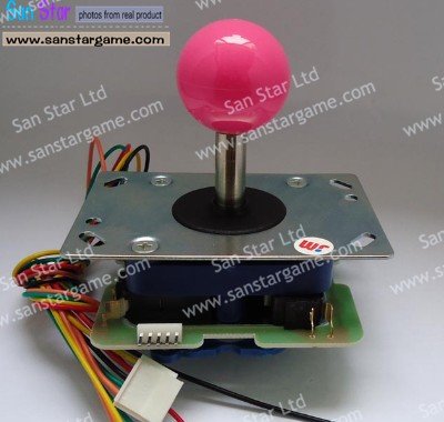

Anpanman Posted August 24, 2015 Posted August 24, 2015 Nothing wrong with using pan head screws from the underside of a control panel to mount joysticks. This way there are no unsightly bolts on the top of the cp. pan head screws on a 1/4" panel? Don't know about that. Me, I'd snap that wood in no time. That area fits the 3 joystick types we sell Zippy, Sanwa, and LED. I will check on how to make sure happ style sticks fits as well. Thank you! I don't see how it could fit happ or even semitsu sticks on there. Happ have a wider base and needs a vastly different area milled out or no milling at all. semitsu and some more premium sanwa sticks need an extra area milled out for the 5 pin header.
ouguitarman Posted August 24, 2015 Author Posted August 24, 2015 pan head screws on a 1/4" panel? Don't know about that. Me, I'd snap that wood in no time. I don't see how it could fit happ or even semitsu sticks on there. Happ have a wider base and needs a vastly different area milled out or no milling at all. semitsu and some more premium sanwa sticks need an extra area milled out for the 5 pin header. I am checking on those. We sell zippy and sanwa primarily and it fits those with space. Sanwa's connect the same was as the picture above. More to come on this as I will probably just have a larger area milled out to accommodate all sticks.... My small catch is pre-drilling the plex or not. I really do not want guys using anything but a screw driver for this (no drills or routers). Can you give me some feedback on the $229.99 pricing including shipping? Is that in line with what you have seen? Better/worse?
