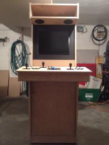

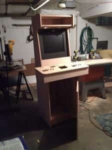

madhatter3339 Posted September 20, 2015 Posted September 20, 2015 Reefboi16 I use the bat top joysticks and a 3" trackball and I router out all three so they fit in there nice and snug!! Then I put down the art work and cover it with plexi!! I recently found t-molding that is 13/16 wide and has a lip on the top and bottom that way it locks in the plexi so I don't have any bolts showing!!! I took these pics before I got the t-molding obviously!!
Reefboi16 Posted September 20, 2015 Author Posted September 20, 2015 man that looks nice!! What thickness wood/mdf did you use? And what thicken acrylic? Roughly how much that you route out? I guess that last questions depends on the lip of the joystick base?
madhatter3339 Posted September 21, 2015 Posted September 21, 2015 It's 3/4" plywood for the cabinet and 5/8" plywood for the control panel top with 1/8" plexiglass over that!! That gives the special t-molding enough room to cover top and bottom edge!! I believe I only had to route out a 1/4" for the joysticks and 1/16" for the trackball mounting plate!! This is the first one I ever made! trying to improve with every one I make by doing something different like lightguns or light up buttons or led lights with sensor for music! I'm clearly addicted to this stuff!!!

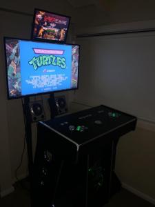

purcho Posted November 7, 2015 Posted November 7, 2015 This is mine. In regards to screen size, I use a 42". That's as big as I would go at the distance I have mine at, anything bigger is a strain on the eyes unless it was further away. My Cab...
purcho Posted November 7, 2015 Posted November 7, 2015 I do, as it doubles as a jukebox. but the sound system in it is only temporary and not fully installed the way it will be when the cab is 100% finished until I can upgrade it to something more powerful. My Cab...
