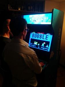

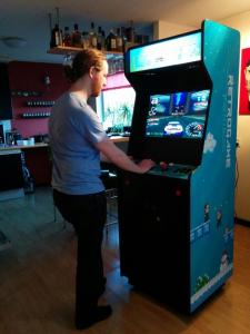

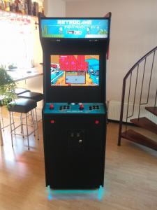

Hi guys,
After lurking my way around here for quite some time now I wanted to show you guys my own build cabinet. It's 100% custom and not like any other cabinet out there. My brother and I love cabinets and retrogames since we were kids so it was just a matter of time before we deceided to build our own cabinet. We have been collecting games and consoles for a long time and always kept our collection up to date at http://retrogamebrothers.com. Therefor we deceided to build a custom cab dedicated to our alias the "retrogamebrothers".

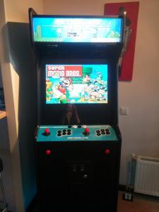

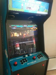

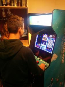

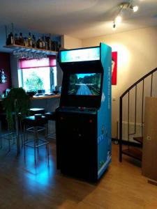

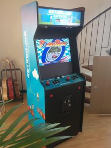

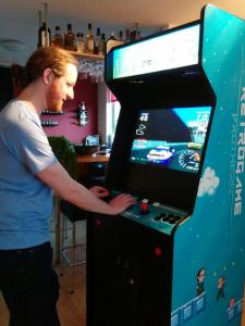

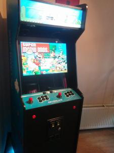

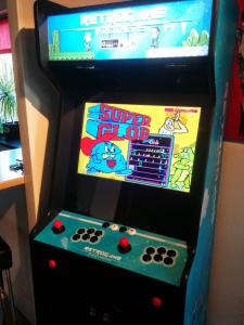

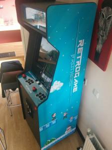

Lets start of with the finished product.
post-49247-0-37522400-1444648211_thumb.jpegpost-49247-0-15465900-1444648211_thumb.jpegpost-49247-0-55495600-1444648211_thumb.jpgpost-49247-0-81820500-1444648211_thumb.jpgpost-49247-0-07391900-1444648212_thumb.jpgpost-49247-0-35226600-1444648212_thumb.jpgpost-49247-0-71290500-1444648212_thumb.jpgpost-49247-0-38552600-1444656854_thumb.jpgpost-49247-0-17381500-1444656854_thumb.jpgpost-49247-0-89456500-1444656853_thumb.jpgpost-49247-0-61775600-1444656853_thumb.jpgpost-49247-0-14809500-1444656924_thumb.jpg
Also see our cabinet in action
If you don't get anything we say, its because its in Dutch.

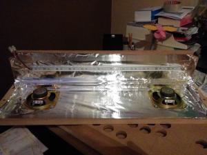

2 Large fans (intake and outtake for airflow at the back)
Stereo speakers

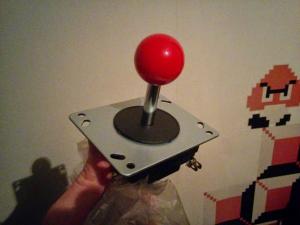

Sticks: Sanwa sticks with 8 diagonal restrictor plates

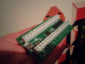

Controller: iPAC2

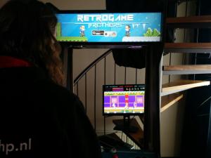

Vynil sticker for the marquee
2 pieces of Plexiglass for the marquee and the button panel

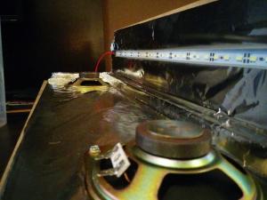

RGB LED lightstrip for the footer
LED lightstrip for the marquee

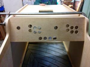

Construction

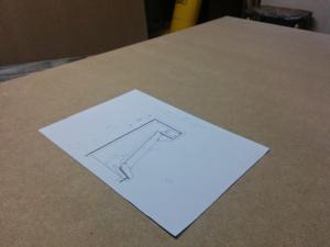

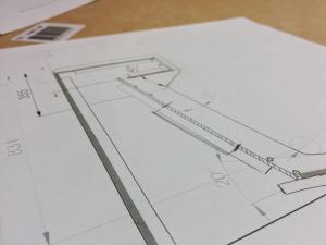

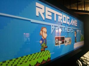

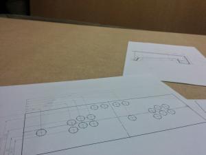

We started out by drawing our ideal cabinet on a piece of paper. What do we want? CRT of LCD? standup cabinet or tabletop? 2 player or 4 player? Finally we deceided and skeched some mockups of what we would like. Not much later we started thinking about sizes and shapes and got to the following final draft.
post-49247-0-88593600-1444651699_thumb.jpgpost-49247-0-12818100-1444651700_thumb.jpgpost-49247-0-45796400-1444651700_thumb.jpg

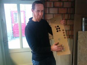

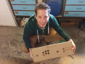

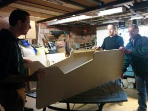

After that we started cutting out the panels.
post-49247-0-68457800-1444653850_thumb.jpgpost-49247-0-42981700-1444653850_thumb.jpgpost-49247-0-16926600-1444653850_thumb.jpgpost-49247-0-22500300-1444653849_thumb.jpgpost-49247-0-80219800-1444653849_thumb.jpg

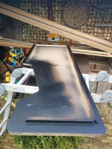

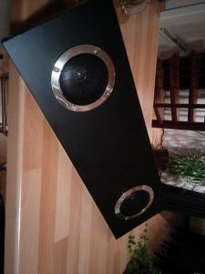

Time to apply some paint to the inside of the sidepanels

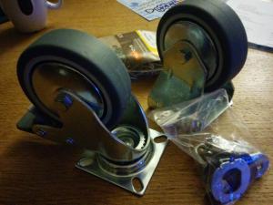

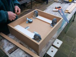

Then, order some goodies and start working on the foot stand (with collapsable wheels)
post-49247-0-31048000-1444655568_thumb.jpgpost-49247-0-63711200-1444655568_thumb.jpgpost-49247-0-90227900-1444655568_thumb.jpgpost-49247-0-32536700-1444654030_thumb.jpgpost-49247-0-05824000-1444654030_thumb.jpg

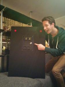

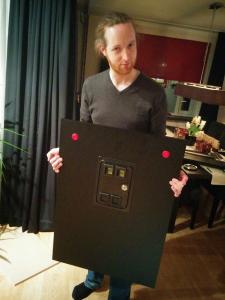

Creating the frontpanel with the coinslot
post-49247-0-34703300-1444656137_thumb.jpgpost-49247-0-62822800-1444656137_thumb.jpegpost-49247-0-91773900-1444656137_thumb.jpg

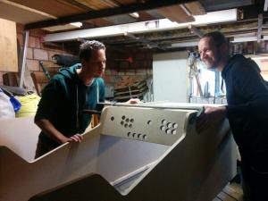

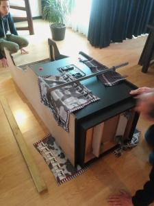

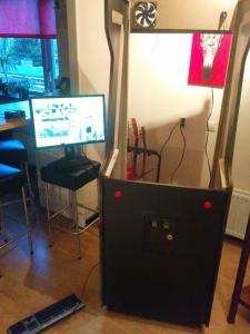

Start putting it toghetter to get an idea of the result
post-49247-0-80788900-1444655768_thumb.jpgpost-49247-0-06050300-1444655769_thumb.jpgpost-49247-0-31151900-1444655769_thumb.jpgpost-49247-0-61037600-1444655769_thumb.jpgpost-49247-0-88771300-1444655890_thumb.jpg

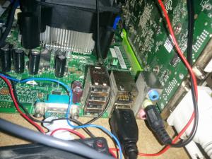

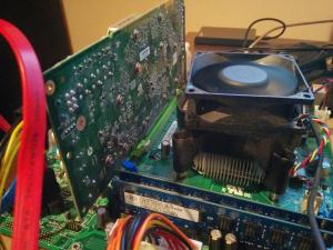

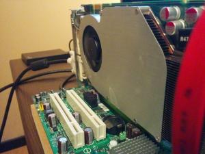

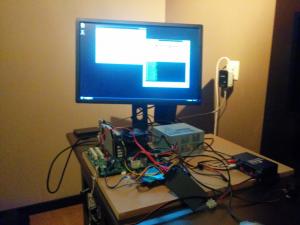

Start working on the electronics and PC
post-49247-0-72336900-1444655888_thumb.jpgpost-49247-0-23711500-1444655889_thumb.jpgpost-49247-0-37070100-1444655890_thumb.jpgpost-49247-0-06126900-1444655888_thumb.jpegpost-49247-0-82701000-1444656042_thumb.jpg

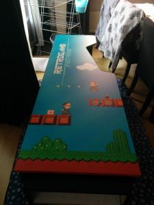

Creating the art and finnishing the cabinet
post-49247-0-80299600-1444656238_thumb.jpgpost-49247-0-06146800-1444656239_thumb.jpgpost-49247-0-47261700-1444656239_thumb.jpgpost-49247-0-69800600-1444656239_thumb.jpeg

In conclusion
It was a lot of work! We had never done anything remotely to working with wood or building a cab but we are really happy with the result! It took us about 3 months to build the whole cab. Since we only worked on it in the evenings and weekends it took us a bit longer then expected. Also figuring out the best way to run HyperSpin, MAME, mapping the buttons, creating configs, downloading movies etc. turned out to be waaaaaaay more work then I thought. By using a subscription to both HyperSpin and EmuMovies I spared mysqlf quite some time.

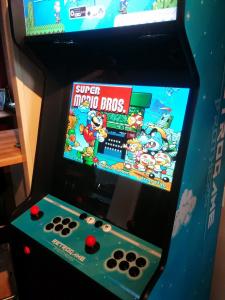

The cabinet powers on with one single button on the back. It lights the marquee, footer RGB led, LEDS for the coinslot (not in the pictures), the monitor and the PC. The PC resumes Windows from an image stored on the SSD so the cabinets boots into Hyperspin in about 15 seconds. You never see anything from Windows since I modified the resume screen and from there it goes straight into Hyperspin wich was still loaded in memory.
We only used MAME games since we love throwing in quarters and play the games we used to play when on holiday. We wanted the authentic feel so no SNES or other retro consoles are installed. We deceided to go with LCD though. It tunred out great! The cabinet is a bit lighter and thinner then using a CRT. Using the MAME HLSL shaders we emulated a great retro look on the LCD. My little nephew even told me to get a new graphics card since it all looked so "blurry" and "pixelated". Just how I wanted it!

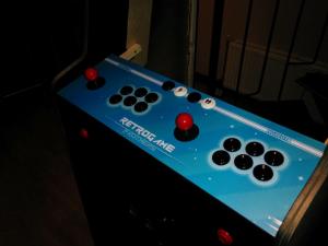

I absolutely love your cab and especially your control panel. Having the CP integrated like that (like an actual arcade cabinet) looks so much better than the overlarge ones that spill over the edge and are wider than the cab itself. I also love that you kept it arcade only with no consoles. I recently did that myself and deleted all my console systems, all their roms/iso's etc... I now like it better with just arcade systems and PC arcade style games.

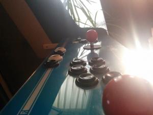

Thanks man! Really appreciate it. Let me know how your panel turns out, would love to see it when its done. For me what really made the panel was to cover it with some plexiglass. The buttons hold it on its place so its a neat transparant layer over your artwork. Turned out better then I hoped.
