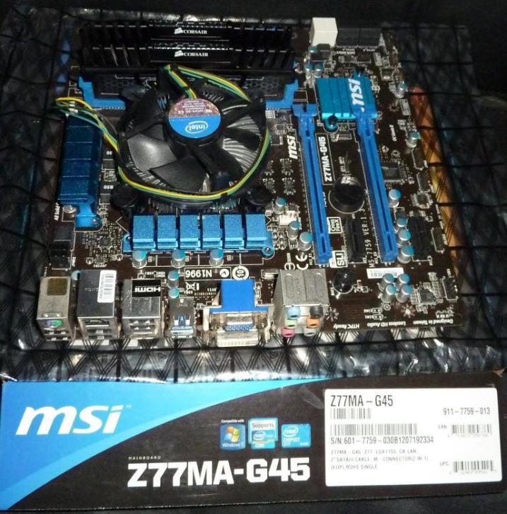

SubZero Posted February 7, 2016 Author Posted February 7, 2016 thanks for the reply guys, found this on marktplaats (graigslist in the netherlands) for 250 euro is it worth it? - MSI Z77MA-G45 MOBO, 7.1 Audio, USB 3.0, S-Ata 600, Crossfire.- Intel Core i5 2500K Processor with cooler.- Corsair Vengeance 2 x 8 GB 1600 Mhz DDR3. i dont have the graphic card, but hey i can save up for that and buy it later
SIMPLYAUSTIN Posted February 7, 2016 Posted February 7, 2016 That would indeed runny any of the stable emulators of today at full speed. With the change you may get a 750ti 2nd had to see you through. You may have to overclock for 100% emulation with the bells and whistles. Which means a good fan or cheap waterblobk cooler could be rehired. Althouh a OC to just under 4ghz MAY get you stable for now depending on stress heat. Other than that, your pretty much future proof. It's an older CPU but still holds up on todays games and emus. I have almost same setup with a older 760 cpu giving me awesome emulation and modern gaming. This is going in my can build in future Simply Austin's YouTube
SubZero Posted February 7, 2016 Author Posted February 7, 2016 Well then its good for now, this will eventually go in the cab anyway, its just for a year orso untill i have more to spend. my old one is getting tired
