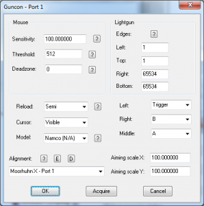

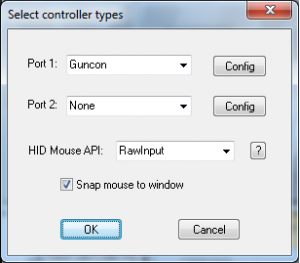

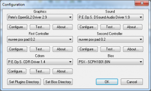

startreker Posted July 2, 2013 Posted July 2, 2013 I'm trying to configure my aimtrak to work with the Playstation 2 emulator PCSX2 (haven't tried the other PS2 emulator yet) and having some problems. I was able to get the gun firing piece working by using the nuvee plugin but I can't get the left or right buttons mapped to the A and B of the controller. I also tried having it setup so I could use either my keyboard or the xbox 360 controller press the buttons so I can get past calibration screen. Any help with this issue would be great. Trying a few things out, I also attempted to see if I could put the aimtrak into guncon mode but I couldn't get the guncon drivers I found to work with it and Windows 7 x64. I played a couple of them on the PS2 itself but the guncon2 emulation on the PS2 itself only works on certain games. I figured if I could get it to work in PCSX2 it will work on all of them. Thanks in advance for any help.
kyoken Posted July 2, 2013 Posted July 2, 2013 try nuvee usb plugin here http://forums.ngemu.com/showthread.php?t=143143 or here http://forums.pcsx2.net/Thread-Nuvee-PS1-PS2-input-plugin-supporting-lightguns-by-Shalma
startreker Posted July 3, 2013 Author Posted July 3, 2013 I got the gun to work with the nuvee plugin but I can't seem to get the "A" button pressed at calibration time to confirmation calibration and move on with the game. I was able to get the gun to work in guncon mode and for some reason it doesn't work in mouse mode. I'm not able to get the buttons on the gun to work as A and B respectively. I tried to set it up where I could use the keyboard or the xbox 360 controller to do the A press to confirm calibration and didn't have any luck with either. Thanks in advnce for your help. Update after trying quite a few things more I found that shooting off-screen while in calibration mode caused it to move on. Funny thing though that once I started a game and got into the game piece I'm not able to shoot off screen to reload. Any help with that would be greatly appreciated because without reloading you can't play the games long.
Trnzaddict Posted July 3, 2013 Posted July 3, 2013 I got the gun to work with the nuvee plugin but I can't seem to get the "A" button pressed at calibration time to confirmation calibration and move on with the game. I was able to get the gun to work in guncon mode and for some reason it doesn't work in mouse mode. I'm not able to get the buttons on the gun to work as A and B respectively. I tried to set it up where I could use the keyboard or the xbox 360 controller to do the A press to confirm calibration and didn't have any luck with either. Thanks in advnce for your help.Update after trying quite a few things more I found that shooting off-screen while in calibration mode caused it to move on. Funny thing though that once I started a game and got into the game piece I'm not able to shoot off screen to reload. Any help with that would be greatly appreciated because without reloading you can't play the games long. I posted about this a while back....when I was finalizing the last bit of games to add to my cab I tried to get the Time Crisis games to work with my Aimtraks. The same thing the a/b buttons I could not get them to work on the Aimtraks, and the way Nuvee is made Shalma did not add the option to have joy buttons when emulating guncon's with mice. (How our secondary buttons are coded in the Aimtrak Utility) . I wasted a week fighting with Nuvee and all sorts of workarounds....save yourself the headache. The Aimtraks cannot go into Guncon mode either on a PS2 emulator according to the guys over at arcadeguns.com (they made my guns), only on a real ps2. If we were able to get them into Guncon mode on PC this would probably work but I don't think it's possible. I think I asked Andy about this over at Ultimarc as well and he said it's not possible as of right now. I am......Machine

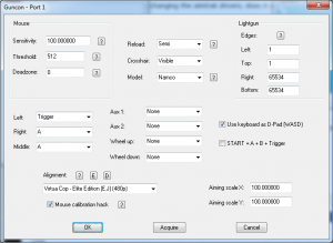

startreker Posted July 3, 2013 Author Posted July 3, 2013 Thanks for your knowledge on what you have done. I was taking a peek at the source code and found out where they programmed in the code that assigns the WSAD to the keyboard when you click the checkbox. I modified it to add the spacebar key as A and the R key as B (I'm probably going to change that key soon but it was really just for testing). I popped it through the compiler and eurkea I can know use the spacebar as my "A" key. Which is great because I know have an old keyboard on the ground and press that with my foot just like the pedal. I found out through trial and error that you can reload just by point towards the corner of the screen (instead of shooting off screen) and it works pretty well. In order to get the plugin to work properly with my aimtrak I had to config port 1 as guncon2. Then go under config and click acquire and click through the button clicks and have it find my gun. Then I clicked the checkbox for Use keyboard as D-Pad(WSAD). On my modified code it has the controller buttons mapped out to: w=up, a=left, s=down, d=right, q=start, e=select, f=C button, spacebar= A button, r= B button. I don't know if others will have this issue but under the main plugin page I had to select swap lightgun players 1-2 to get my lightgun to show up as player 1 for some reason but others might not be affected the same way. Also as a note I have the HID Mouse Input as RawInput, that really seemed like the best so far for me. I'm honestly not sure if I can post a link to a file that I can upload somewhere or not so if others are interested feel free to PM me. I turned on usb debugging and am currently looking at the log file to see if I can decipher what code entry has to be provided in order to get the buttons on the aimtrak to actually work with the game but at least with the A and B buttons mapped to the keyboard and the reloading issue figured out it is a working solution. I also found that for most games I had to go under config on my guncon2 and under alignment choose the custom alignment to go with the game I am playing. I see that not all of the games are there though so I'm not sure how difficult it is to make my own alignments or if someone has a list of additional alignments that I can have. Update: I have been having a lot of luck getting this working. Under the config page I set the checkbox for mouse calibration hack and that really helped clear up my calibration issues on Time Crisis 2 and 3. Overall it is proving to be a great method to keep on. I also forgot to mention that I have reload set to semi. I haven't played around enough with that setting to see if it makes much difference. When it is all said and done it might be best to just provide screenshots of my config.

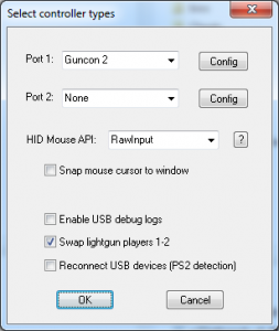

startreker Posted July 9, 2013 Author Posted July 9, 2013 I spent some more time on this working towards perfection. I talked with Andy from aimtrak and was hoping to get the code for the buttons so I code them directly into the controller. In talking with him and going back and forth through quite a few e-mails I found out that the topgun drivers will work work with aimtraks that are started in guncon2 mode. True enough I held down the two buttons and powered up my gun. I went into device manager and installed the topgun drivers for the unknown device in device manager and bamb it looked like it took the drivers. I went into PSXC2 and fired up Time Crisis 3 and it attempted to use the buttons. At first things didn't look any better because the left button didn't work but I tried the right button and it worked how it is supposed to work! I was able to play time crisis 3 with the right button. I'm not aware of any games that really need both buttons to play so that really shouldn't be a big deal but for those wanting a method to use at least one button on the aimtrak you have it. If you are running x64 like me you will have to disable the driver signing check for it to work. Update I also found that it with it now running in guncon mode it works perfectly so far with pcxsr with nuvee plugin that I have. So now I can knock PSX and PS2 off my list.

startreker Posted July 18, 2013 Author Posted July 18, 2013 Sorry just seeing you first question here. The top gun drivers are meant for when you load the aimtrak up in guncon mode. To do that you have to unplug the aimtrak, hold down the front two buttons and plug back in the aimtrak. You should be able to let go of the buttons fairly quickly. Then go into your device manager and you should see an unknown device with a yellow question mark. Right click that and use the topgun drivers to load it. After that just follow my settings for compatibility and it should work great with the right button. I talked with Andy and let him know that it only worked with the right button and not left but he didn't know why that was the case. Once you get the topgun mode working it works great for both PCSX2 and PCSXR-lightgun. Attached are two screenshots that should help you see how I have it configured. Don't forget to click the acquire button and click on the window with your aimtrak trigger to have it comfirm it has your ID. It all works like a champ and the great thing is that it works independent of all your standard aimtrak settings because it goes into guncon mode Also just as a heads up reloading works great but instead of shooting offscreen you just shoot towards the sides.
connorsdad Posted July 18, 2013 Posted July 18, 2013 Thanks for taking the time to post pics of your config. I followed your guide from the byoac forum, have my guns working now Thank you Time crisis 2 won't load at all with the nuvee plugin selected, how did you go on ? I have vampire night working but the crosshair isn't visible, also I have to aim up and to the left on the calibration screen otherwise the sight won't travel to right or bottom of the screen. Virtua cop elite edition, I can't get past the "press start button" screen. I'd be interested to hear what games you have tested and any annoyances you have come across. Cheers
connorsdad Posted July 18, 2013 Posted July 18, 2013 I found you have to set the controls to unplugged in the lilypad controller plugin config, then use the Q key to start. As far as shoot off screen to reload, I find I have to shoot right at the inner edge of the screen for it to register.

startreker Posted July 18, 2013 Author Posted July 18, 2013 Just saw your most recent post, yeah the default plugin has this configuration for keys when you press click the send WSAD to keyboard checkbox: w=up, a=left, s=down, d=right, q=start, e=select, f=C button. I have worked with his source code and recompiled a modified dll that makes the spacebar= A button and r = B button. I found it works well for Time Crisis 2 and 3 because I can have an old keyboard on the ground and press down on the spacebar ke with my foot like the original foot pedal. Let me know if you are interested and I send you a link in PM. The keyboard re-mapping doesn't work on PS1 because he didn't include a keyboard re-direct on that plugin but so far I have had success with everything PS1 wise by have the right button assigned to B so I haven't really spent much time in the source looking to change it. Update: Funny I would say that about the B button and not having an issue. I ran into an issue with Extreme Ghostbusters. I needs both the A and B buttons pressed to start the game. Putting a controller in port two to press the start button doesn't seem to work either. I'm not sure how worried I am about it right now but in order to get this working either the keyboard redirect piece has to be implemented or the left button has to work in guncon mode.
startreker Posted July 18, 2013 Author Posted July 18, 2013 Testing out Vampire Night I personally found his correction for Endgame to be the closes for me. I would make sure for the cursor disappearing that you have the checkbox for enable mouse calibration hack enabled so you will know where you are pointed. You can always change the icon to look like a gun scope (I plan on doing that shortly). The great thing about the corrections list is that is a .ini so when I get closer to minting everything for my collection there are some values for each game so if the shot for you is far and to the left you can modify the values in the ini either manually or by clicking the E button on the plugin and change them so the work flawlessly for you. On the PS1 side I really wasn't having issues with calibration too much but I did notice in my initial playings with PS2 that sometimes a correction for a different game then I was playing worked better than the one he had. I will eventually fix all that for myself and if it helps others I can post it here also. update:Let me know btw if your left button works. I have been trying everything and it works perfectly in other games in its standard mode but in guncon mode it doesn't want to work with nuvee for me. I might get lucky and it turns out someone with a different firmware for aimtrak has a working left button and we can get Andy to provide a patch to fix it. If not I will just have to look at the source code and see what I can do when I get around to it.
