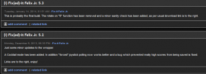

barakawins Posted May 4, 2016 Posted May 4, 2016 Gigapig, I think I have a solution. In the guide that you put up on youtube, what version fix it felix did you use? Is it Howard's? (Dragon King). He has a 5.3 version which I think will work for horizontal monitors. Do you have 5.3 or does anyone have it? The links don't work.
barakawins Posted May 4, 2016 Posted May 4, 2016 Nevermind. I see you used 5.3. Man, I can't get this to run full screen for some reason.
