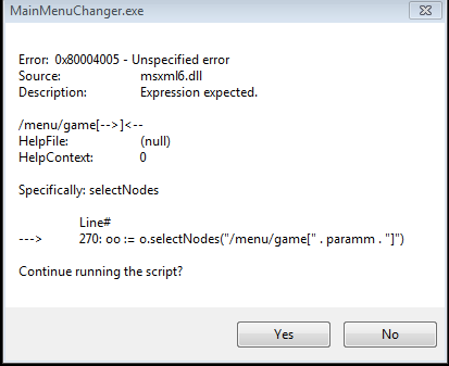

spotUP Posted April 3, 2016 Posted April 3, 2016 I did something stupid to my install, and when i exit out to the categories something goes wrong, what could it be?
knewlife Posted April 4, 2016 Author Posted April 4, 2016 I did something stupid to my install, and when i exit out to the categories something goes wrong, what could it be? this error is because mmc is recibing an empty filter as parameter.... This can be because of various reasons... First check the filed called DATA openig it as a text file... Send me the contents please. Then try to run mmcexit.exe manually and after that run hyperspin again and see if it works. I'm currently unable to use a computer due to electricity problems in my town but gonna check this later. EmuLink (Canal de Youtube) | Main Menu Changer | HyperArchiver Version 0.0.0.17 | HSBezel
