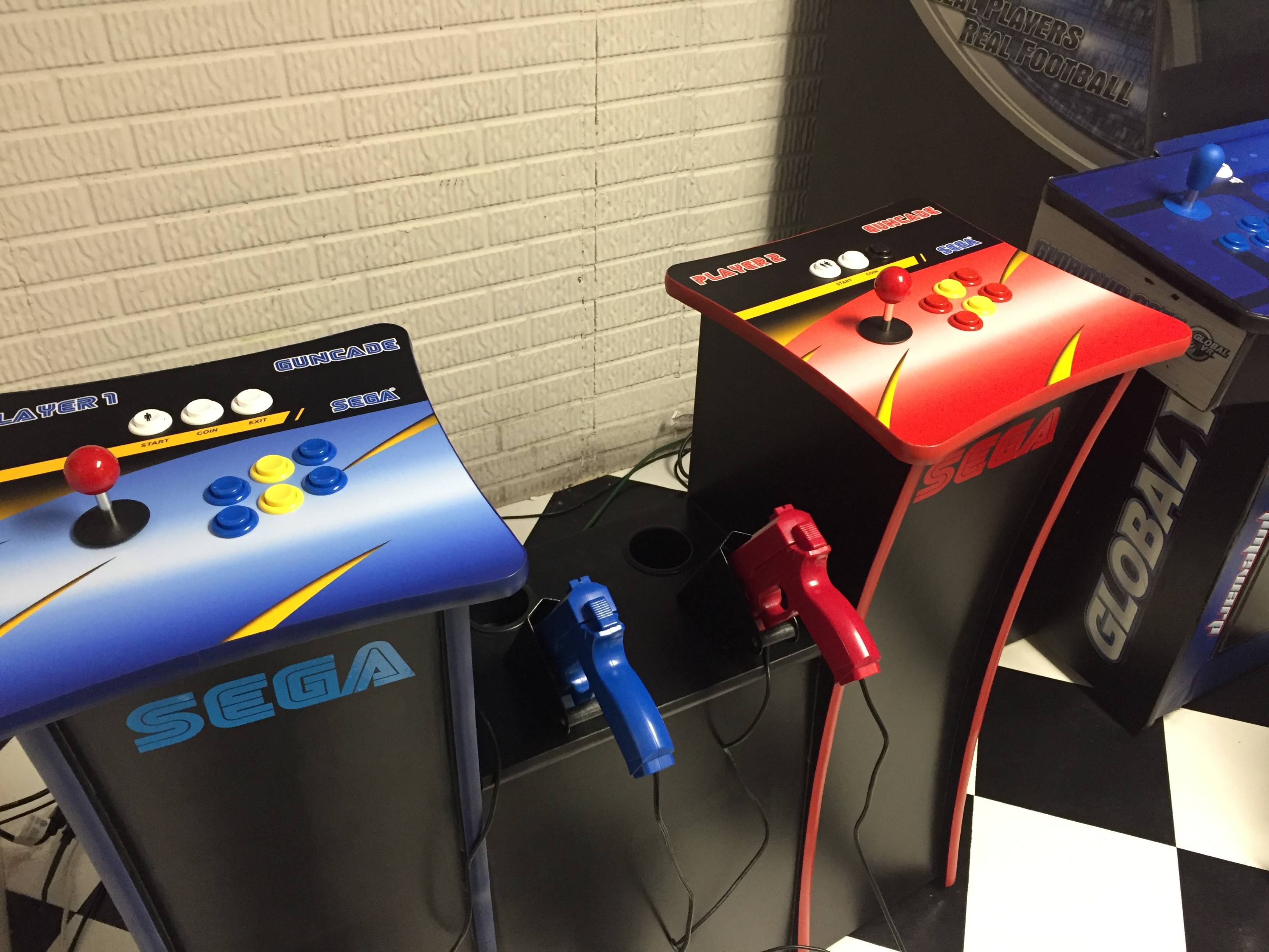

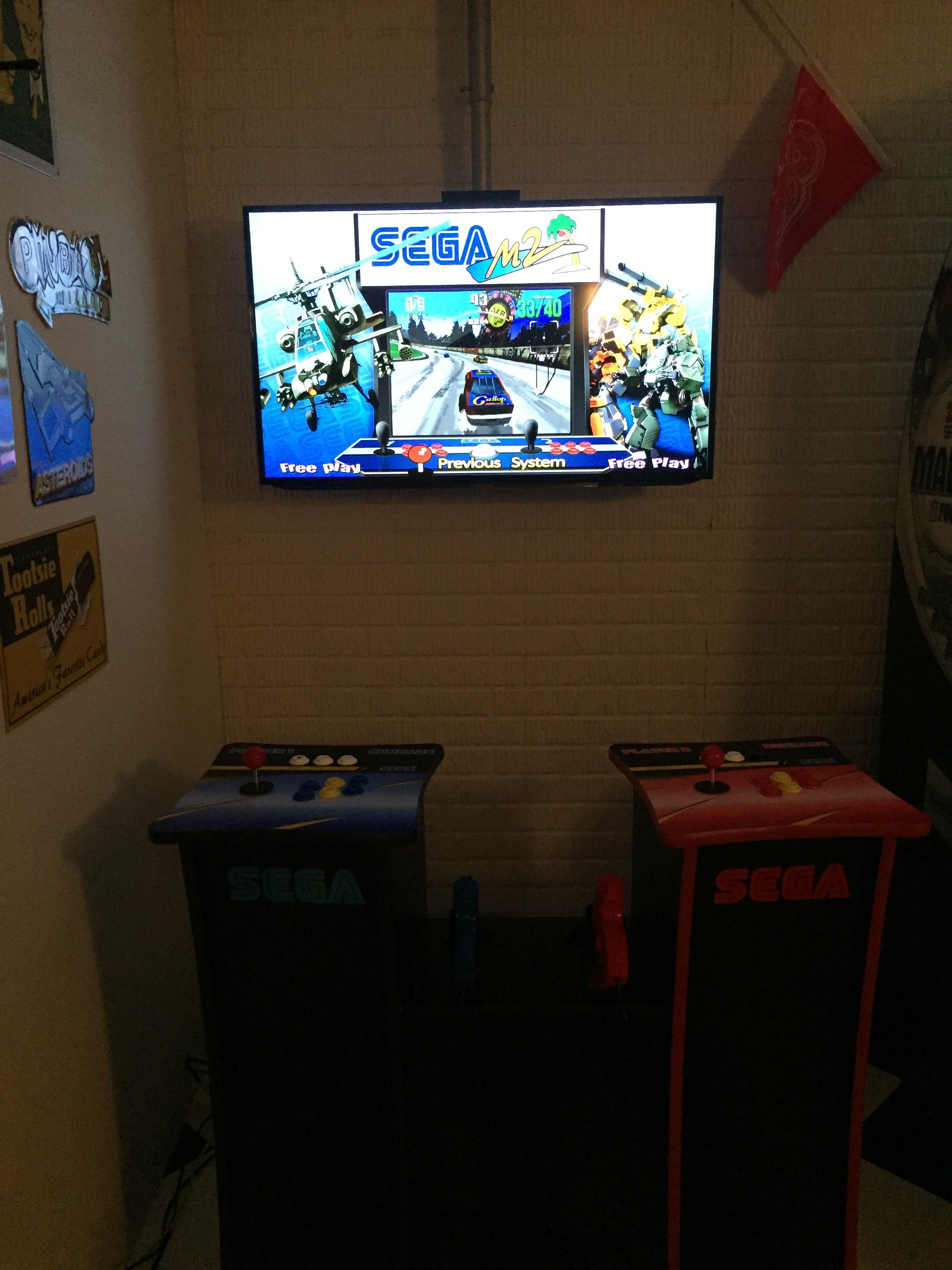

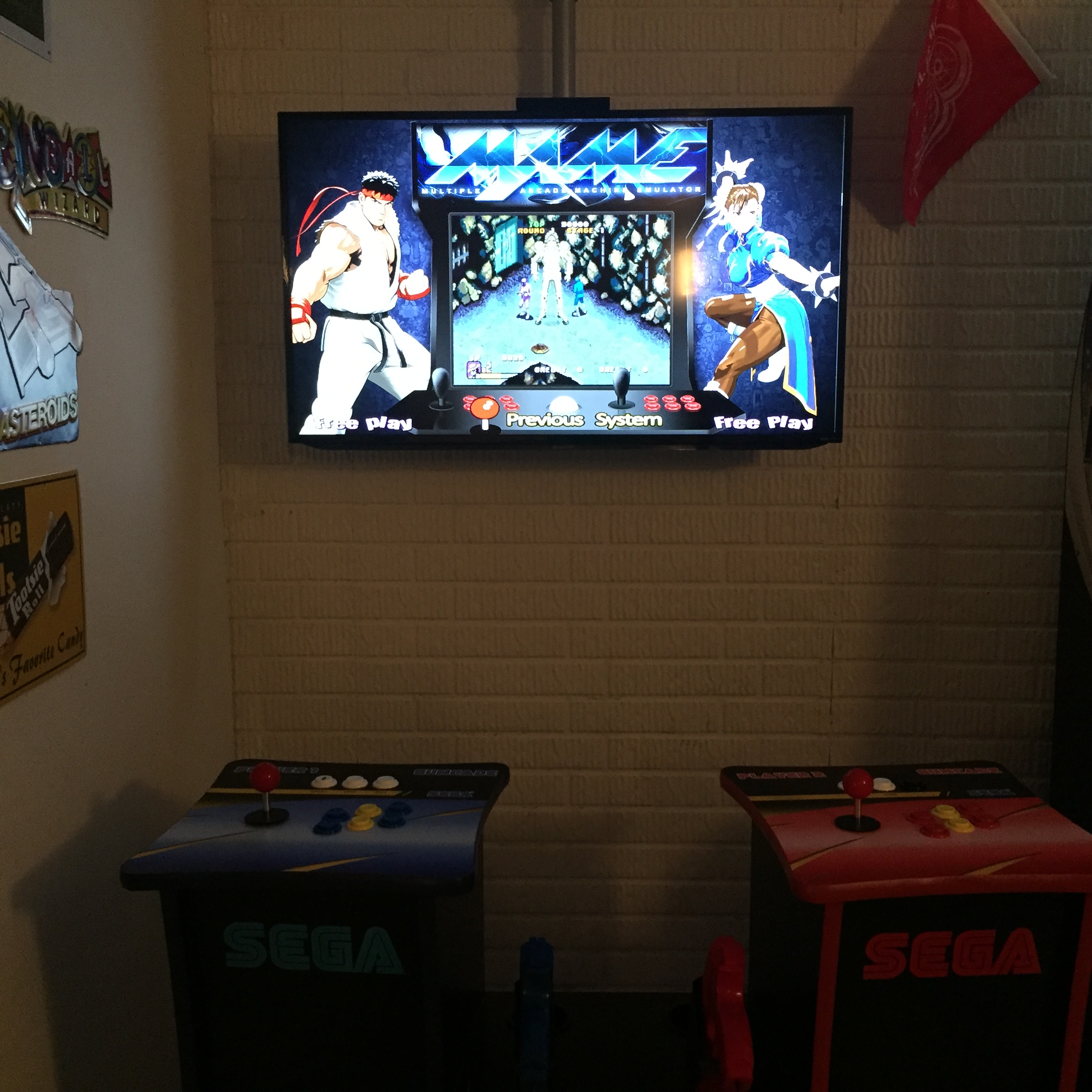

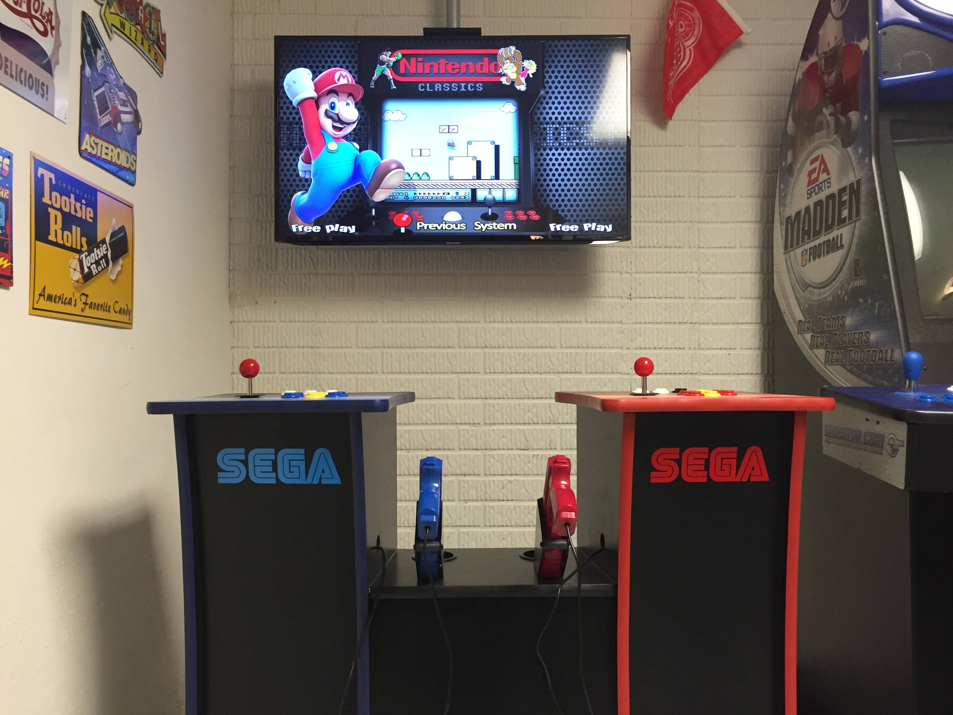

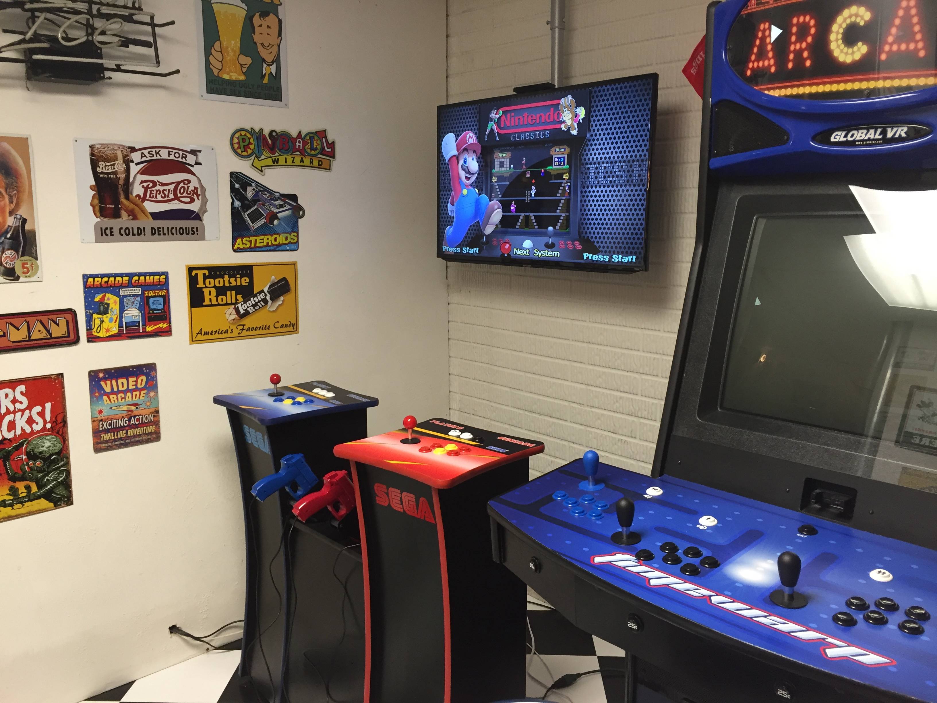

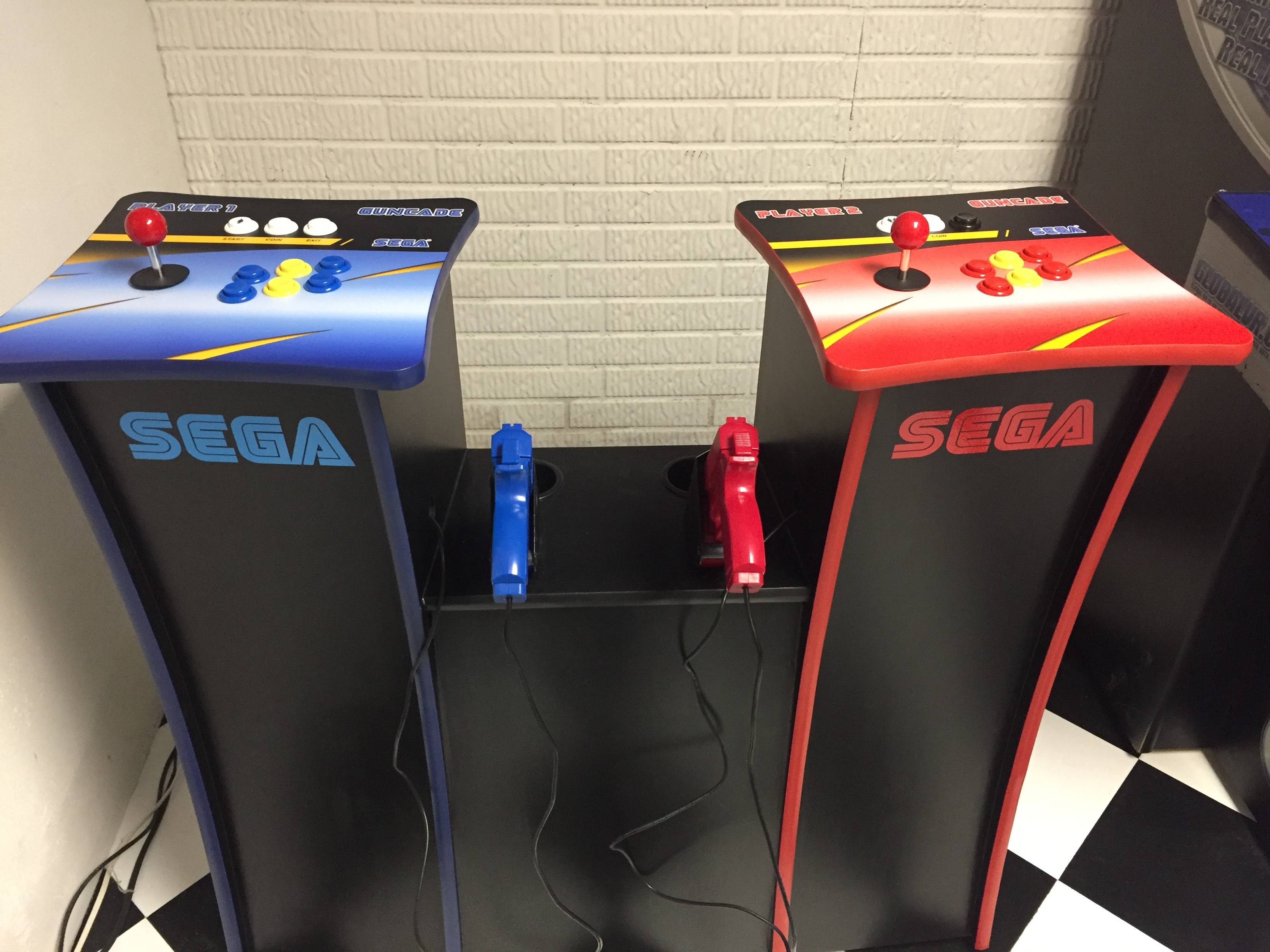

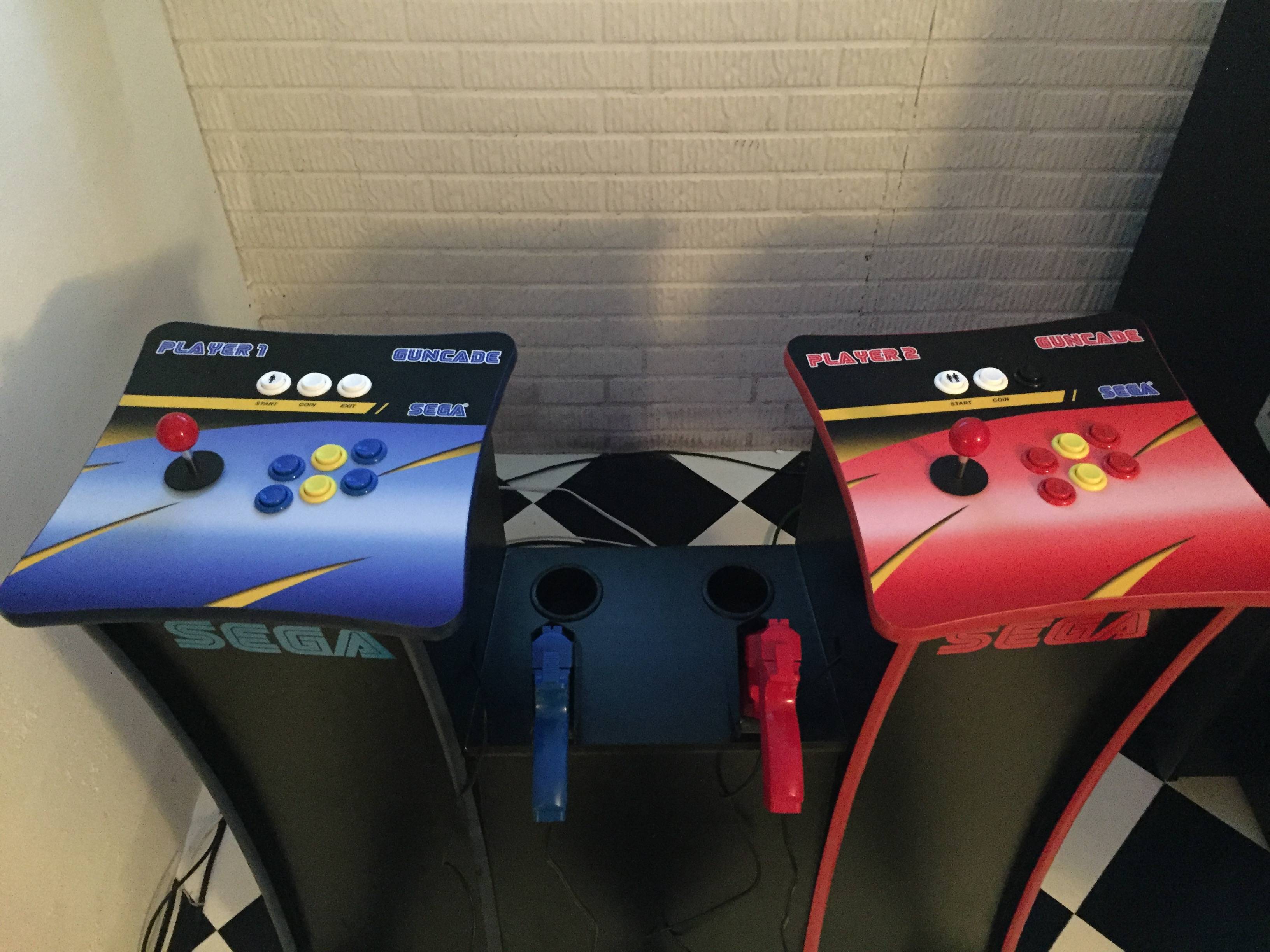

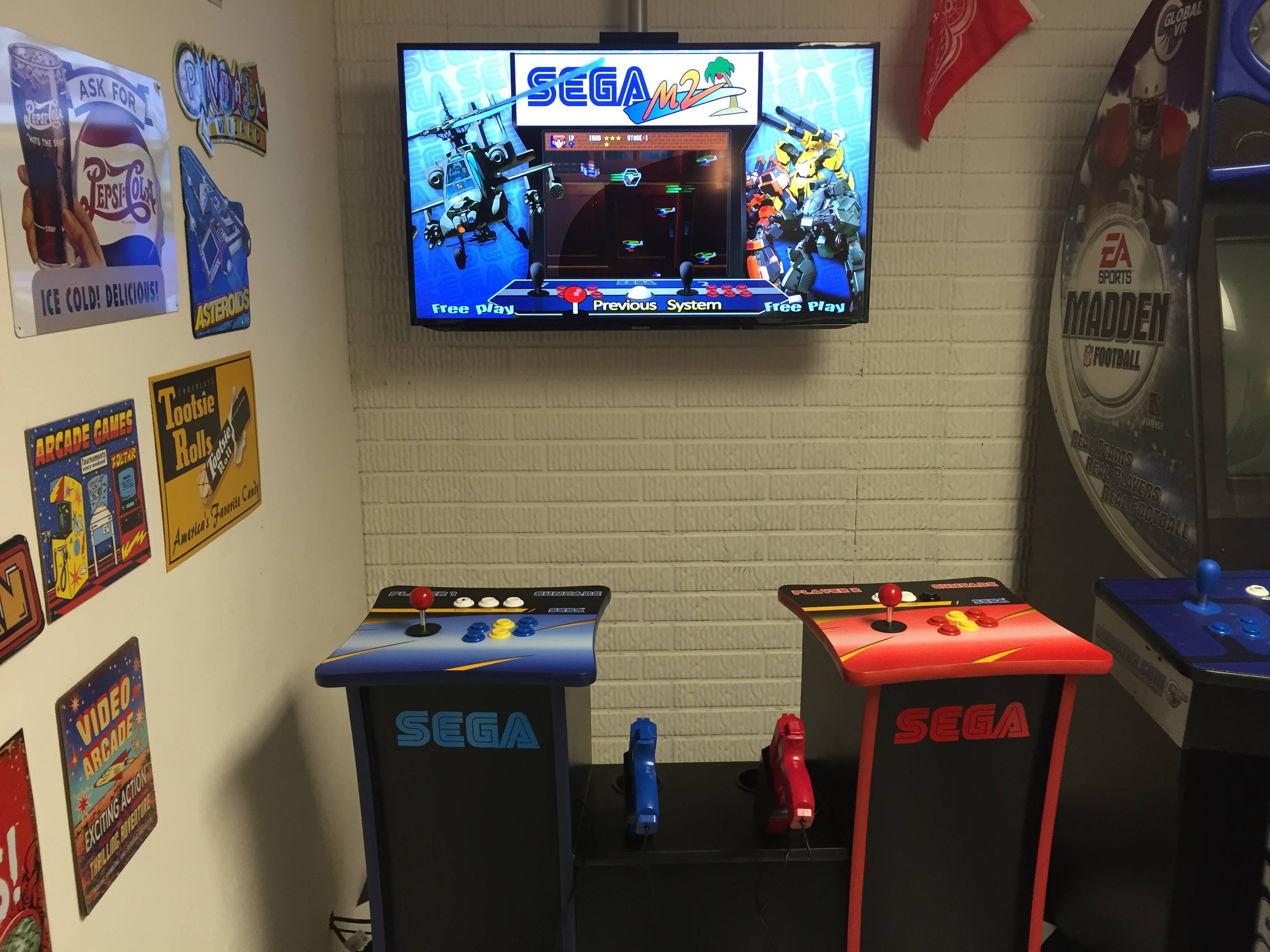

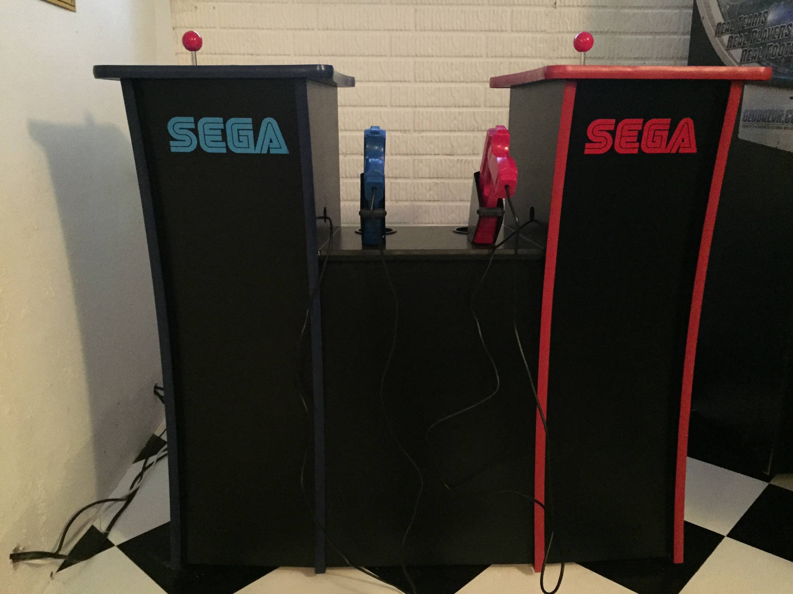

bhudkins Posted April 13, 2016 Posted April 13, 2016 Finally finished my fourth hyperspin build. I previously had a cocktail, a 2 player cabinet and a 4 player cabinet all running hyperspin. I set out to build a dedicated lightgun cabinet. It was going to be a small pedestal cabinet with 1 joystick/button setup and two light guns. I ended up doing a full custom 2 player pedestal with two light guns. I think it turned out great, setup to play the standard arcade emulators and PC games. 2 ultimarc u360's and 2 ultimarc aimtrak guns. GeForce 970 GPU with a 43" flat screen. Here are some pics of the final product!
hitchhikingflatlander Posted April 17, 2016 Posted April 17, 2016 Nice work wish I had some light guns, big fan of shooting games! IMO you need a big display like you have for good light gun action.
KlopjerO Posted April 17, 2016 Posted April 17, 2016 Nice work! ! Sent from my SM-A700FD using Tapatalk | My themes / downloads | Get the MS-DOS Wheel sound pack | Get your MS-DOS game themes here | Get the MS-DOS wheel set here | My YouTube channel | WarcrafT - Lord of the clans |ZeroJay's Ultimate DooM archive
bhudkins Posted April 17, 2016 Author Posted April 17, 2016 Yeah I started with a 32 which was fine when I was building everything and testing in the office. Once I got it mounted it was way to small so I upgraded to a 43 There actually100s of gun games between all the systems. House of the Dead III is the most played. And Blue Estate for the PC is also pretty fun

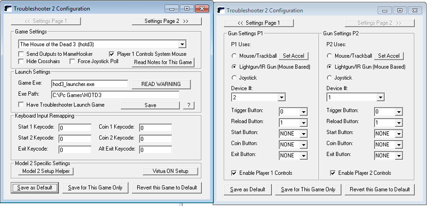

potts43 Posted April 19, 2016 Posted April 19, 2016 Yeah I started with a 32 which was fine when I was building everything and testing in the office. Once I got it mounted it was way to small so I upgraded to a 43 There actually100s of gun games between all the systems. House of the Dead III is the most played. And Blue Estate for the PC is also pretty fun Hi I'm wondering if you can help me? I have just set up HOTD3 using the original troubleshooter to get 2 light guns working. I launch it first and then the game. It I launch it via rocket launcher it's fine but if I do it from Hyperspin then the game appears to be one player only. It's bizarre. How have you set yours up? Thanks!
bhudkins Posted April 19, 2016 Author Posted April 19, 2016 Hi I'm wondering if you can help me? I have just set up HOTD3 using the original troubleshooter to get 2 light guns working. I launch it first and then the game. It I launch it via rocket launcher it's fine but if I do it from Hyperspin then the game appears to be one player only. It's bizarre. How have you set yours up? Thanks! I am using troubleshooter 2 for hotd3 pc version. I would try that. If it launches fine with rocketlauncher, theoretically i should work from hyperspin. troubleshooter just runs in the background you shouldnt need to launch it before the game.

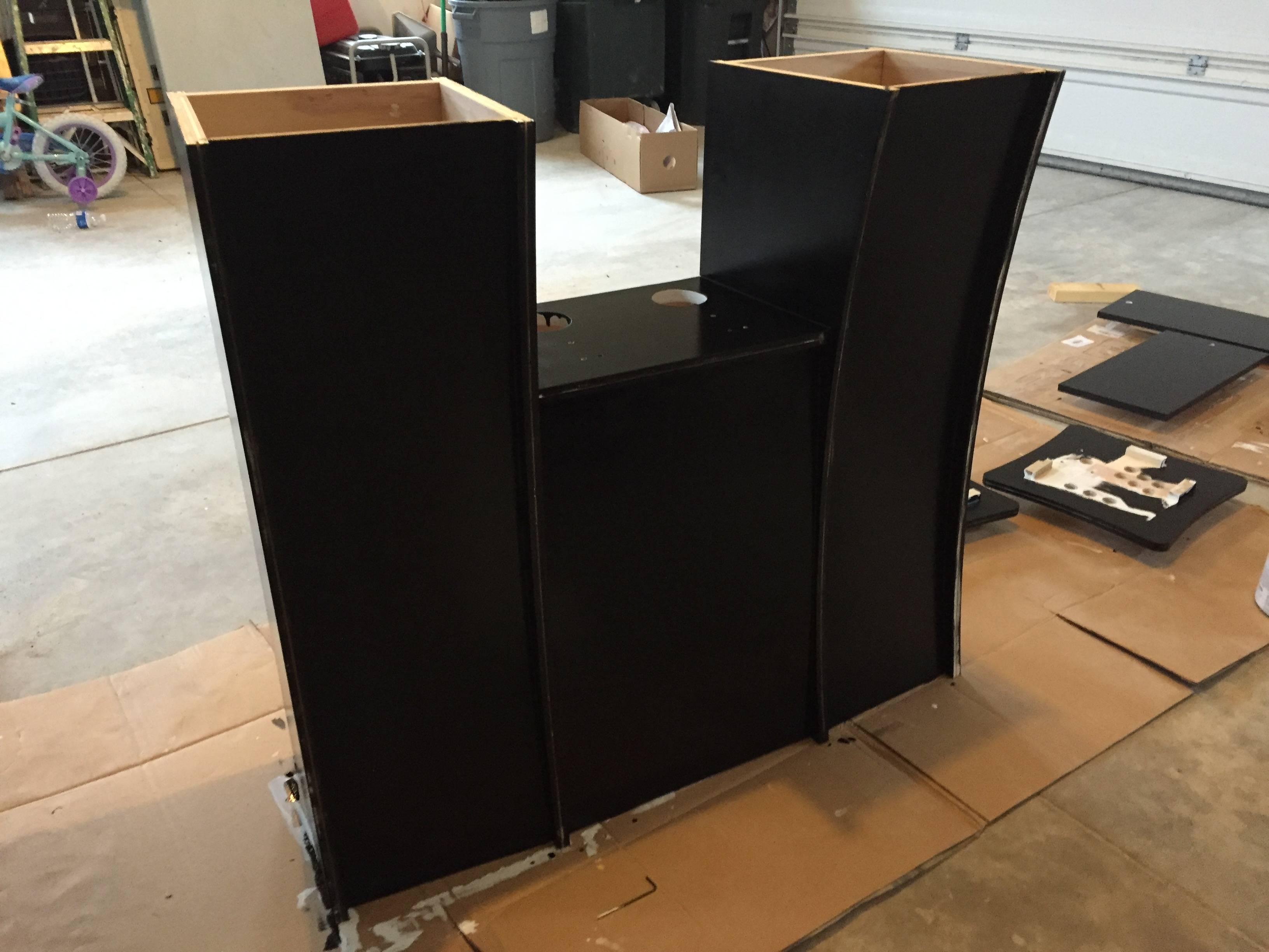

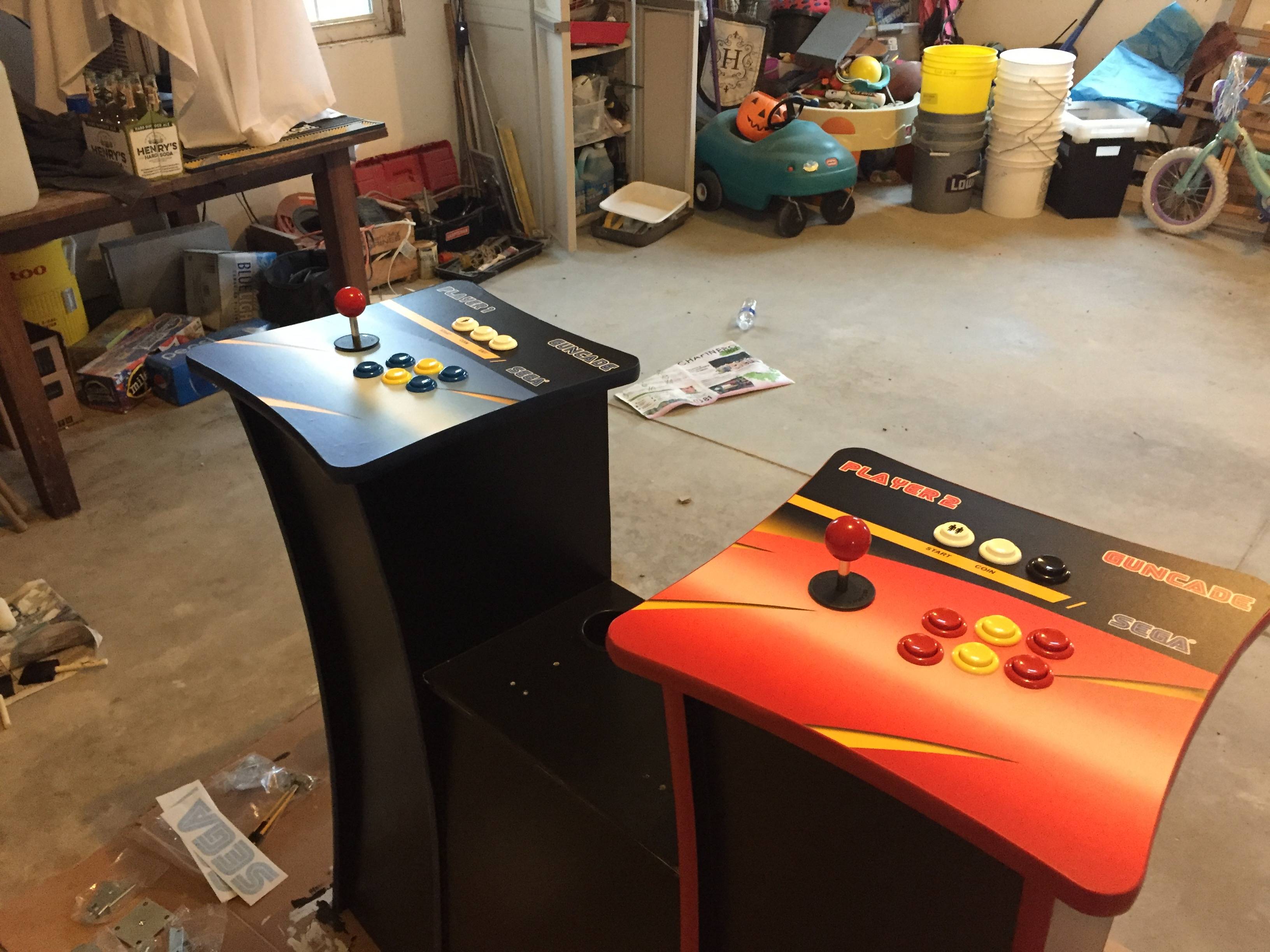

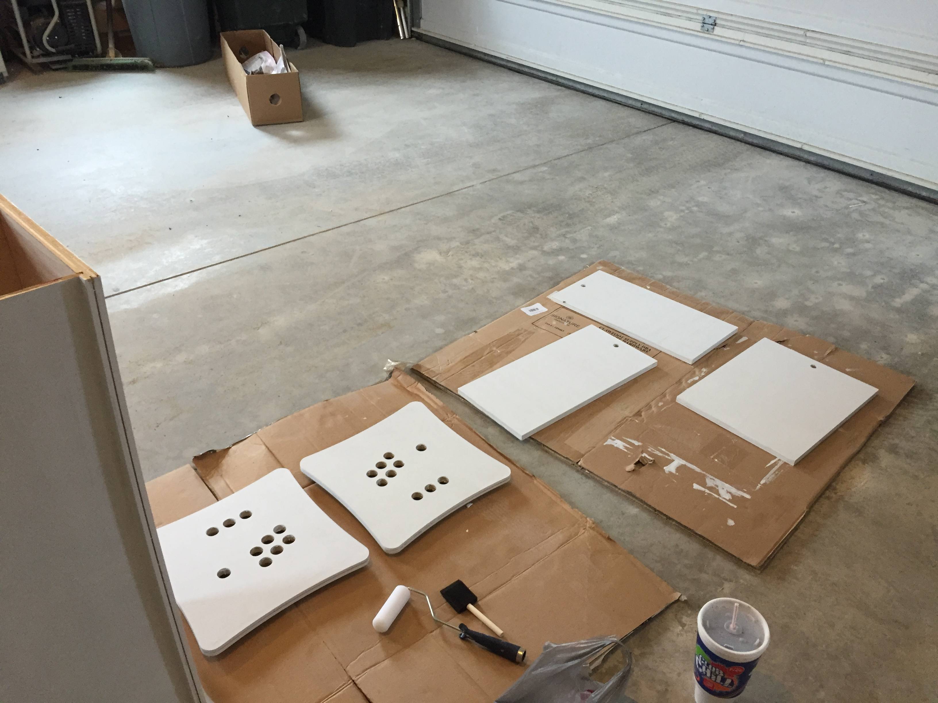

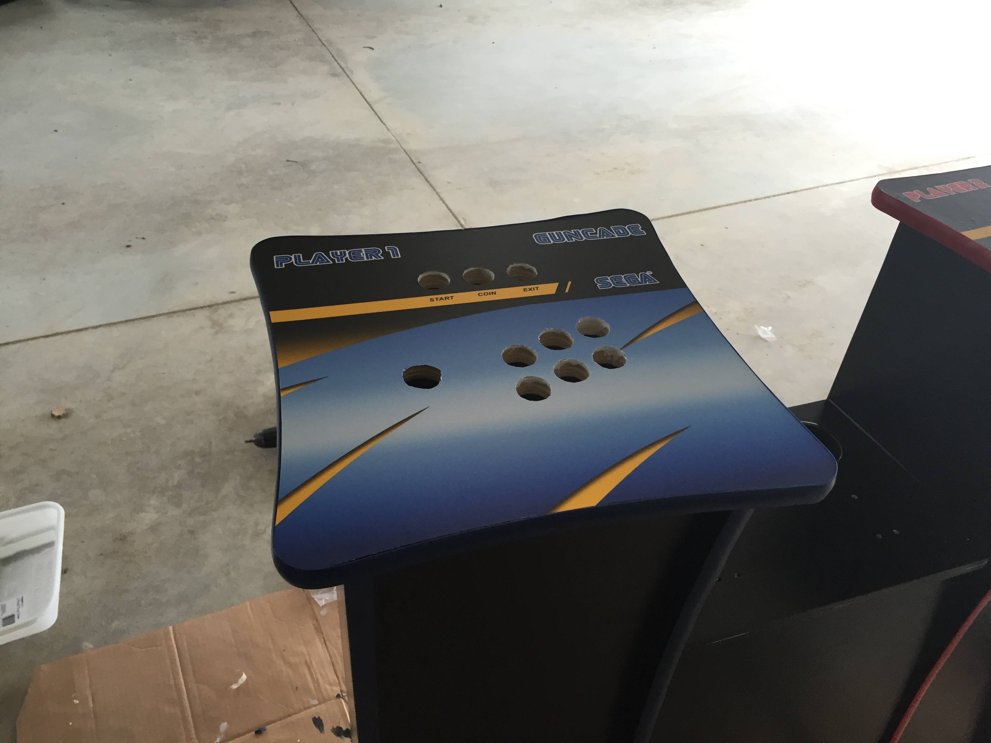

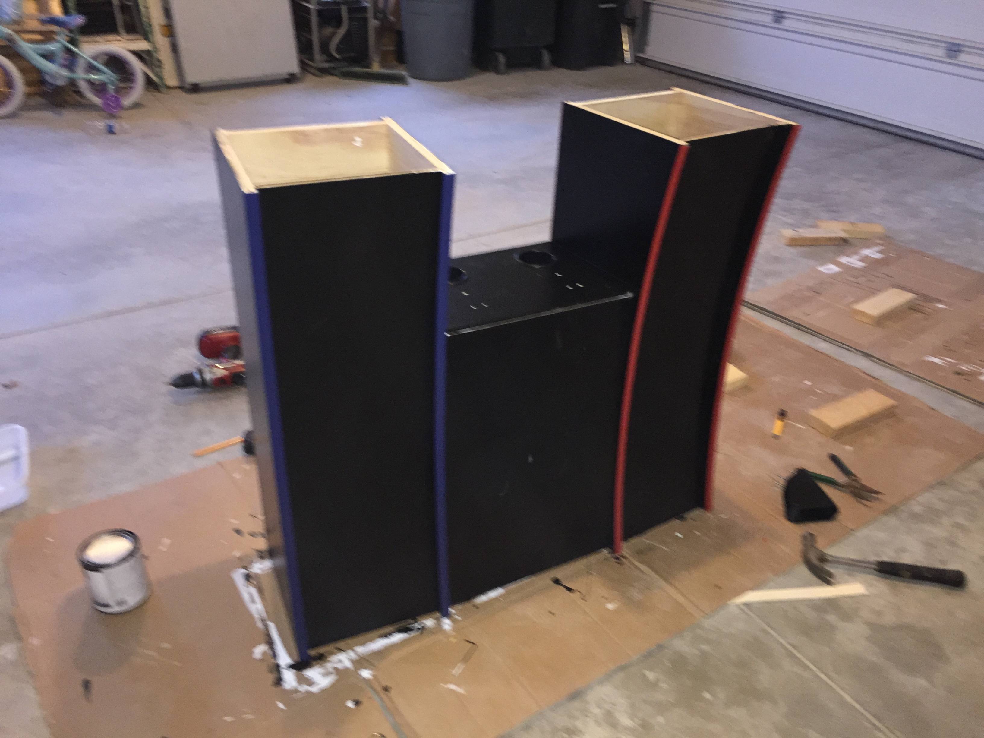

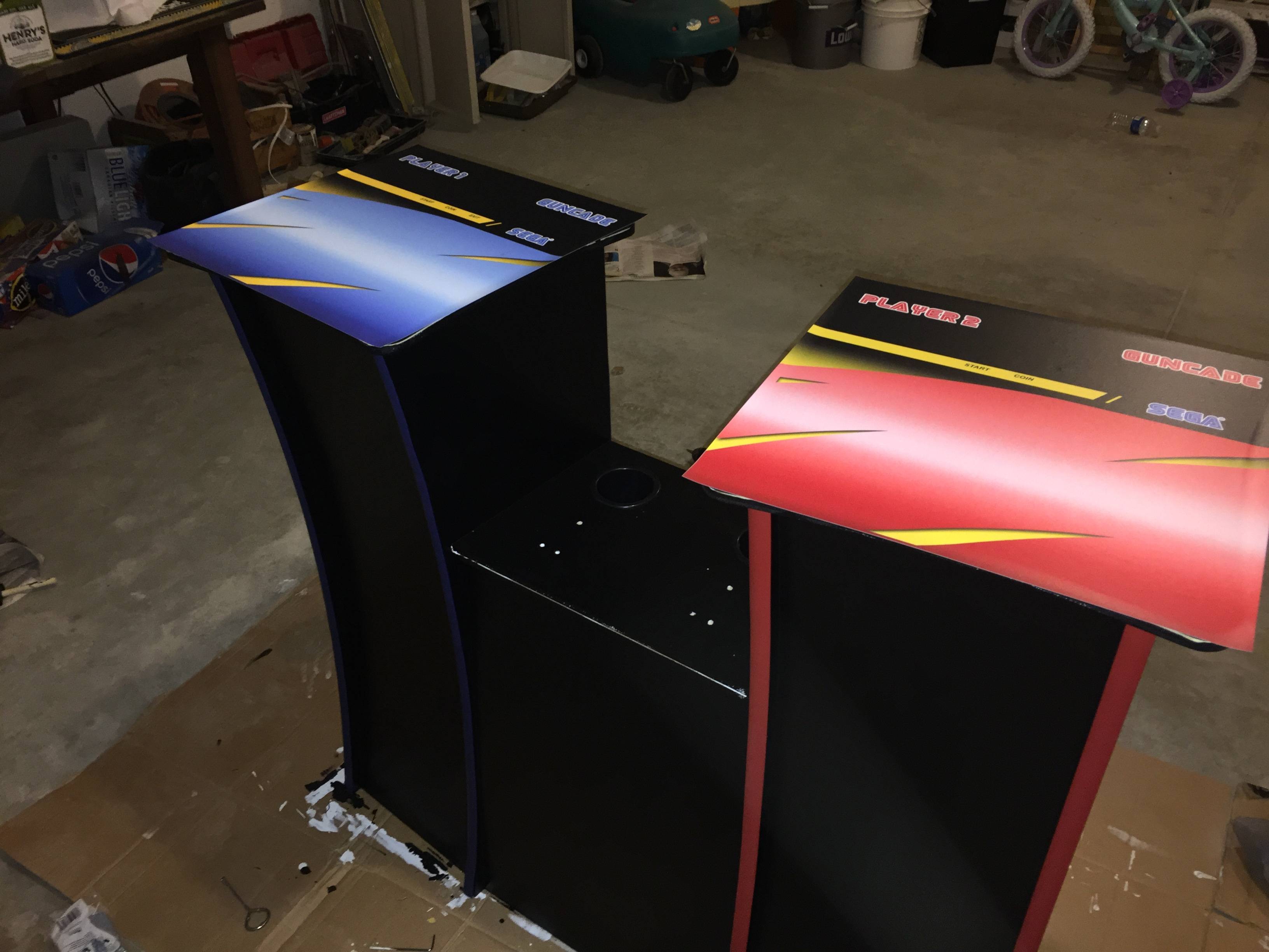

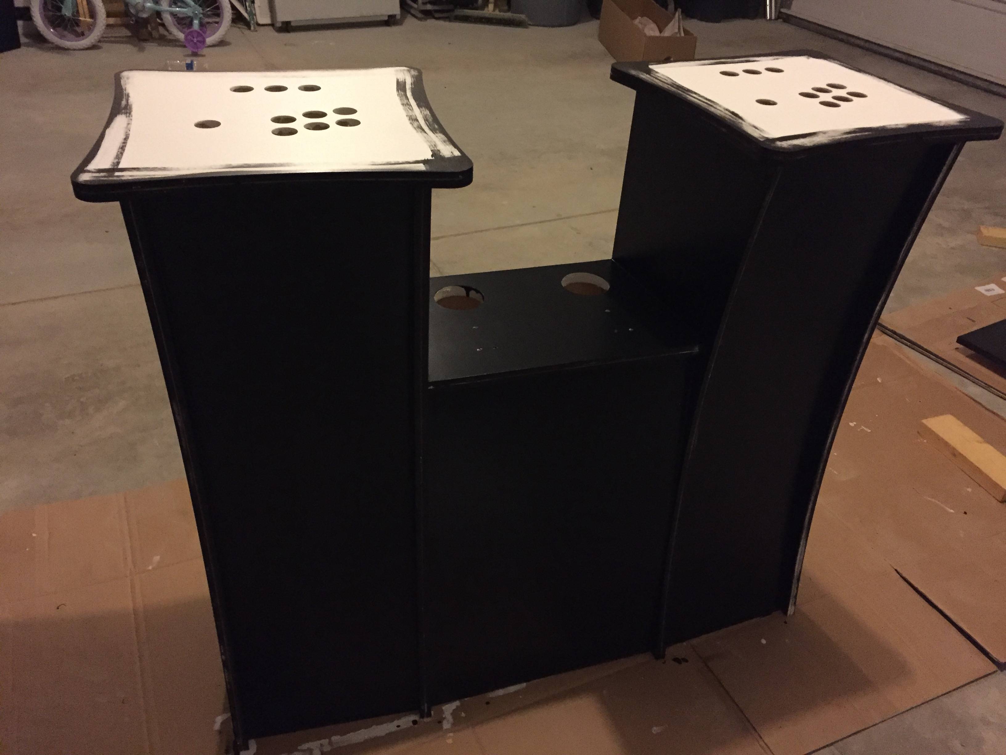

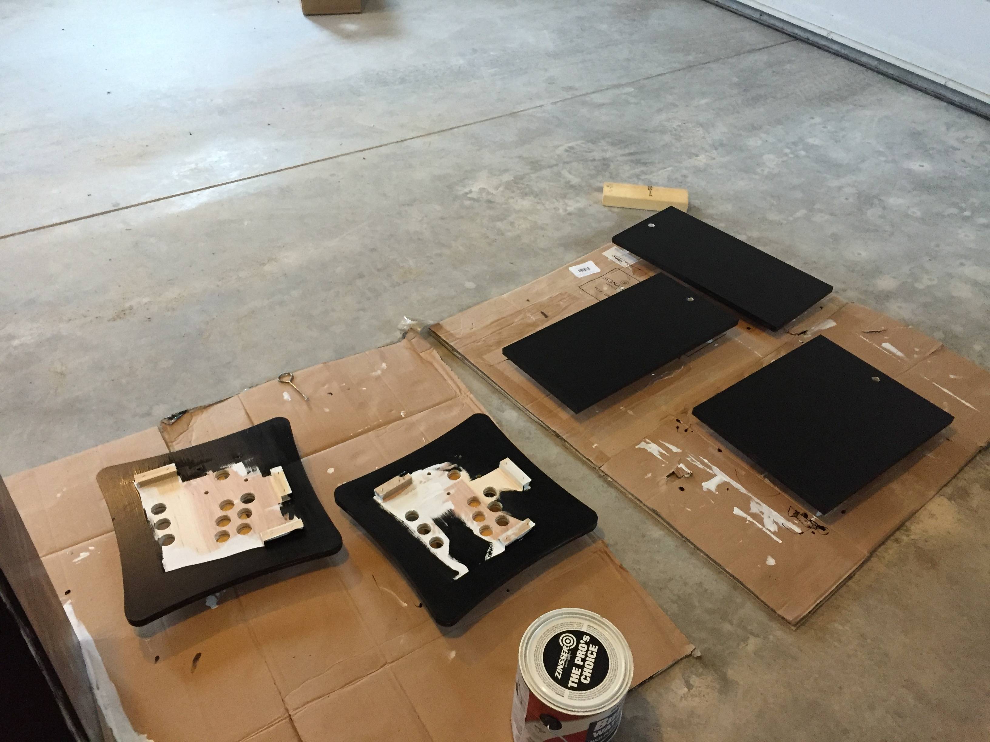

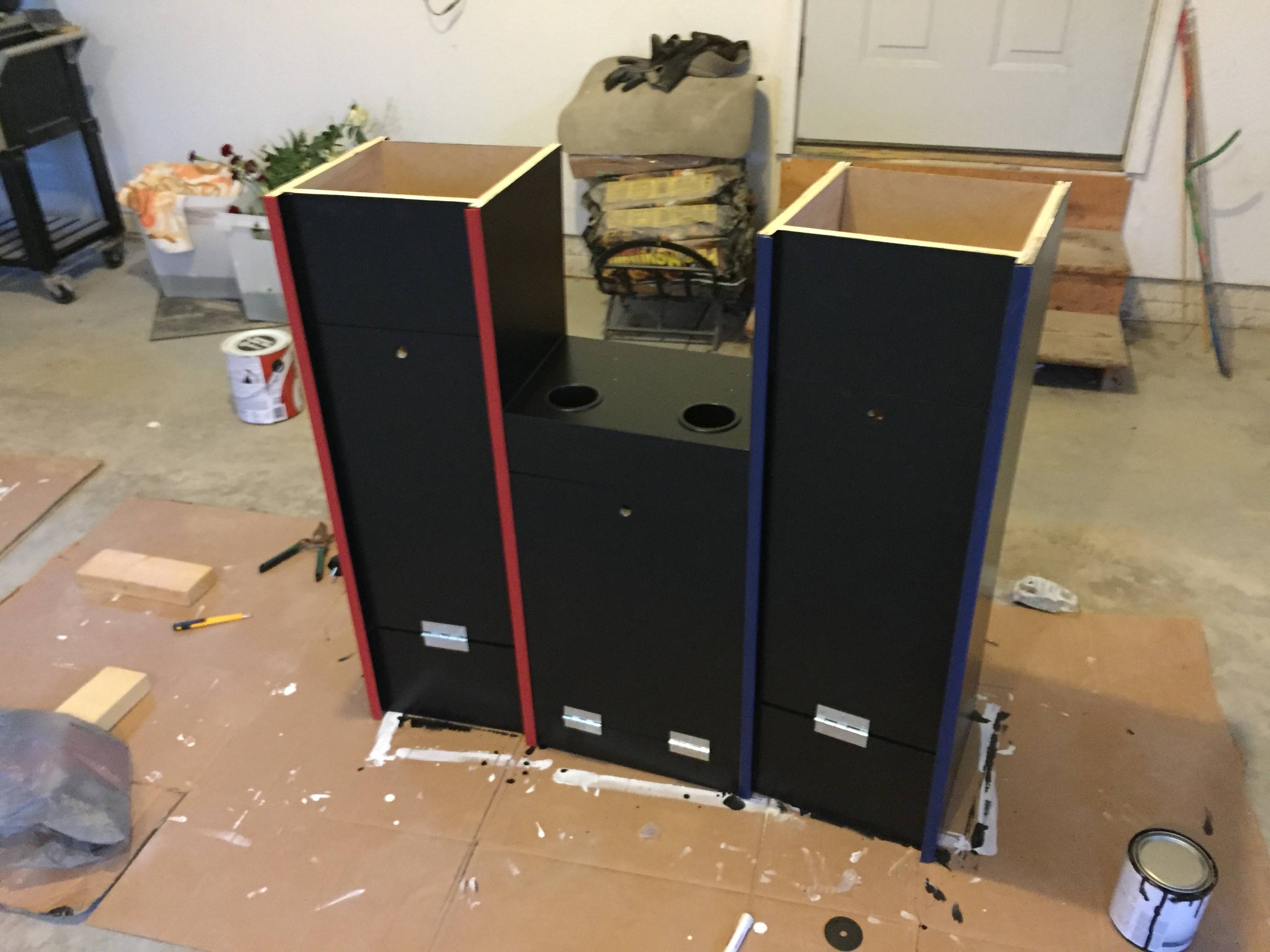

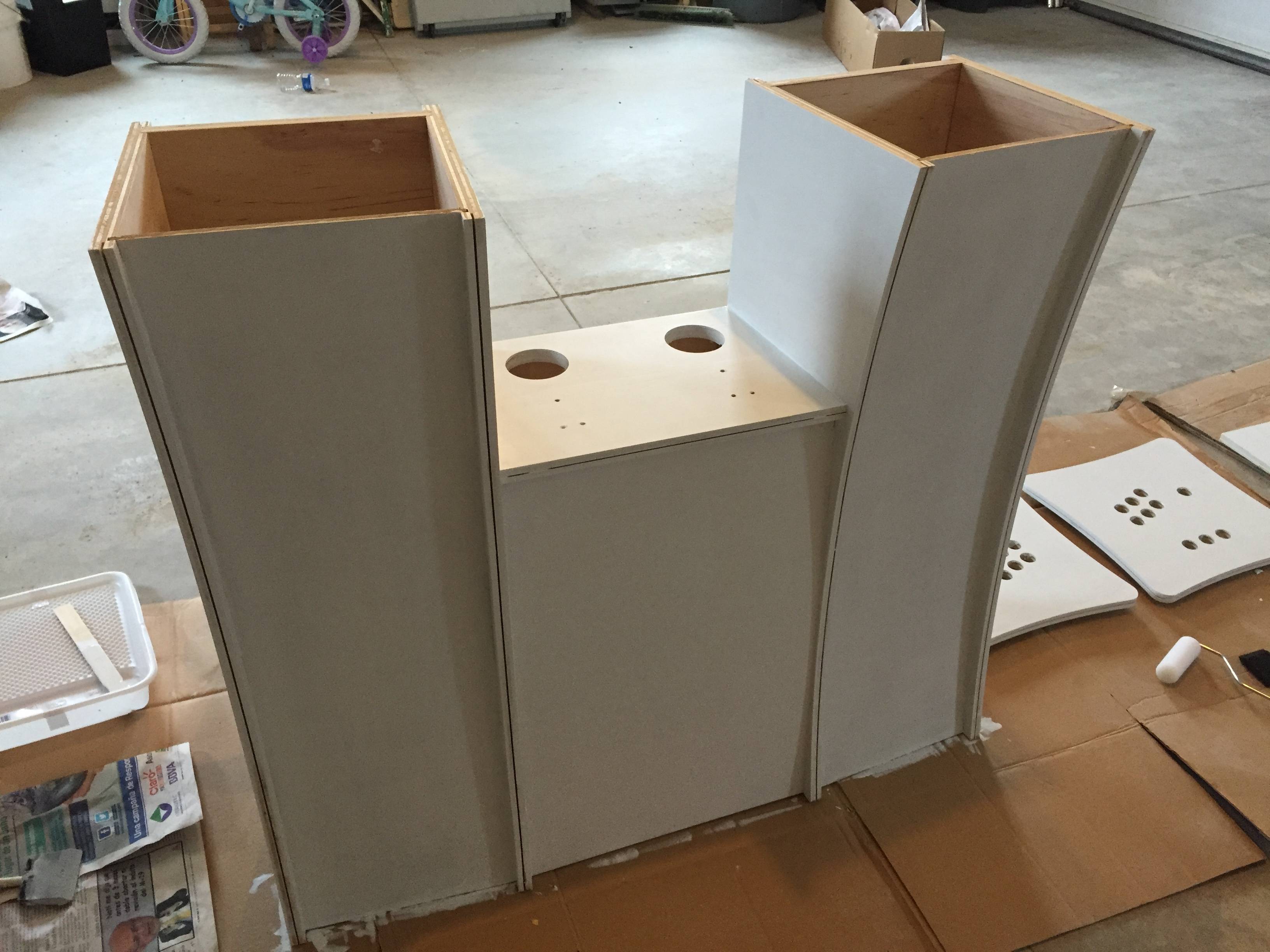

bhudkins Posted April 19, 2016 Author Posted April 19, 2016 Here are some more pics from the build process.

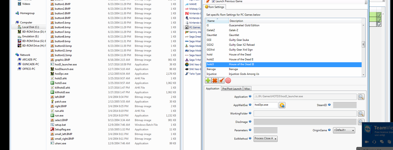

potts43 Posted April 19, 2016 Posted April 19, 2016 I am using troubleshooter 2 for hotd3 pc version. I would try that. If it launches fine with rocketlauncher, theoretically i should work from hyperspin. troubleshooter just runs in the background you shouldnt need to launch it before the game. I've tried that but I must be doing something wrong as it doesn't work in hotd3. Would you mind detailing the steps or settings you use in TS2? It's driving me mad!!
bhudkins Posted April 19, 2016 Author Posted April 19, 2016 I've tried that but I must be doing something wrong as it doesn't work in hotd3. Would you mind detailing the steps or settings you use in TS2? It's driving me mad!! The biggest thing is sometimes the gun IDs change, especially if you unplug or move the guns from the USB I am also using hotd3_launcher.exe which i found on the hyperspin forums .

potts43 Posted April 20, 2016 Posted April 20, 2016 @Bhudkins Ok, I got the game to run and close down from Hyperspin but couldn't get the guns to do anything. How do you use TS2 with the game itself? How are you launching it ? I can move the in game menu cursors to move but as soon as the game starts there is nothing happening and no firing either. thanks
shitoken Posted April 20, 2016 Posted April 20, 2016 Very nice build. Aimtrak guns will be next order to Andy once I finish setting up my machine hehe
bhudkins Posted April 20, 2016 Author Posted April 20, 2016 @Bhudkins Ok, I got the game to run and close down from Hyperspin but couldn't get the guns to do anything. How do you use TS2 with the game itself? How are you launching it ? I can move the in game menu cursors to move but as soon as the game starts there is nothing happening and no firing either. thanks Make the settings the same as mine on page 1, assuming you found and downloader hotd3_launcher You will need to change the ids to get the guns to work. I would start with gun 1 ID 0 and save it then try it with 1 gun until you get it working. Then do the same with gun 2.
potts43 Posted April 20, 2016 Posted April 20, 2016 Make the settings the same as mine on page 1, assuming you found and downloader hotd3_launcher You will need to change the ids to get the guns to work. I would start with gun 1 ID 0 and save it then try it with 1 gun until you get it working. Then do the same with gun 2. How do you launch TS2 though? If that's not running then it won't/can't work. Do you double click the exe and it runs in the background before launching Hotd3 launcher?

bhudkins Posted April 20, 2016 Author Posted April 20, 2016 Honestly i don't do anything to start it, i just save the configuration in the app and it works LOL. If i change the gun IDs and save it, it doesnt work. It hooks into it somehow, not excatly sure of the process. I also have the orginal troubleshooter running, but I can that process is running in the background. As far as the lightguns. They work for PC games, wii (dolphin), model 2 and model 3, atomiswave and naomi using demul and silent hill on TTX
potts43 Posted April 21, 2016 Posted April 21, 2016 Honestly i don't do anything to start it, i just save the configuration in the app and it works LOL. If i change the gun IDs and save it, it doesnt work. It hooks into it somehow, not excatly sure of the process. I also have the orginal troubleshooter running, but I can that process is running in the background. As far as the lightguns. They work for PC games, wii (dolphin), model 2 and model 3, atomiswave and naomi using demul and silent hill on TTX You don't run the program? Now I'm well confused [emoji13]. Thanks for your help.
bhudkins Posted April 21, 2016 Author Posted April 21, 2016 You are right it doesnt make any sense... maybe its a combination of the original troubleshooter running. I am at a loss, I just know if my guns arent working I update them in t2
