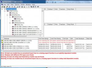

faydra6410 Posted July 4, 2015 Posted July 4, 2015 Had similar gfx_ctx_init problem but Aceisback's d3d9 solution fixed it but next time i loaded RetroArch I got a new host of problems. I am running a clean install of windows 7 Pro 64bit, and have been following SimplyAustin's video in order(brilliant videos). On the RetroArch one I used all the files provided in his video. after i fixed the d3d9 dll error I was hit by the following: The application was unable to start correctly (0xc000007b) I Google'd relentlessly for 2 days and finally was able to find something on YouTube using dependency walker after loading RetroArch in it I found I was missing 15 dlls. fixed all but 2 (see image). Upon further googling I discovered that there are not any 64bit dll files available, has anyone else encountered this? Advice please I'm stumped. By the way I have read all the comments and tried them too.... DX9... C++ ect.

faydra6410 Posted July 4, 2015 Posted July 4, 2015 I sorted this 30 minutes ago.... took my hubby's graphics card out of his pc and let windows configure it. Trust me I tried everything i could find on the net and nothing else worked I tried everything direct x was an early attempt. Thank you for helping though. I figured I better update in here so others know my fix as well.
