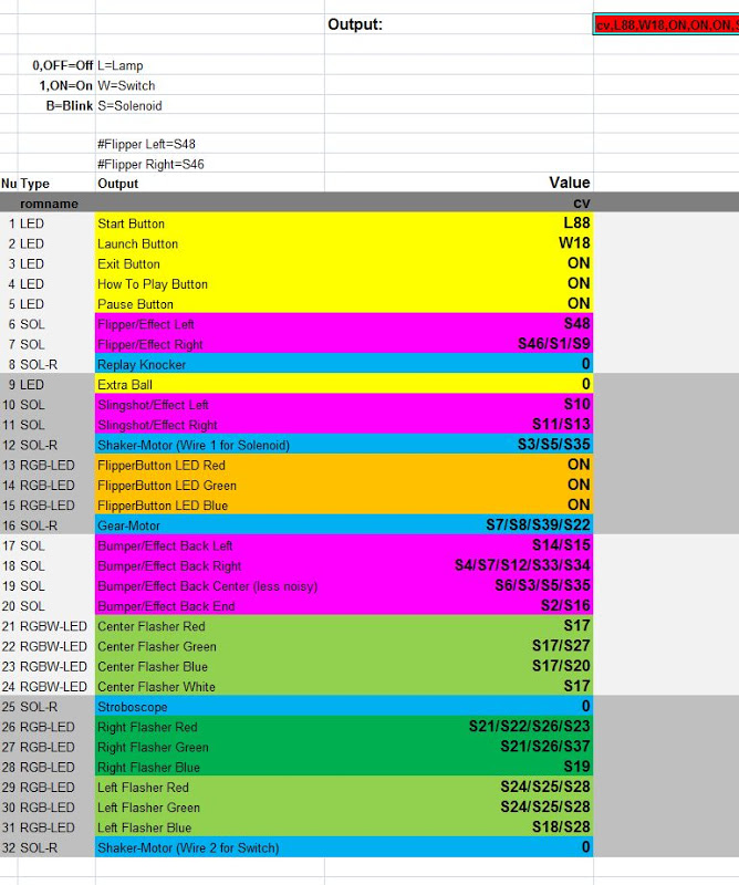

chriz99 Posted December 27, 2010 Author Posted December 27, 2010 just for you, njay: the excel (2003 version) file play a bit with the file and post some configs of other tables. would be great! I thought we could make for each table a separate excel file. so its easier to share. here is cirqus voltaire http://www.mediafire.com/?srcrkhlwf50ke68 here monster bash http://www.mediafire.com/?kvan3e4gqu9mada so far available: cv, mb, totan, ij, sttng, tz, taf, afm, cc, fh, mm, tom cheers chris [sIGPIC][/sIGPIC] * taito egret 29 candy cabs * indy & star wars pachinkos 17" bartop with ledwiz rgbleds * 10" bubble bobble & galaga bartop * arm champs 2 check out hi-res backglasses * best vpin performance * ledwiz config and software

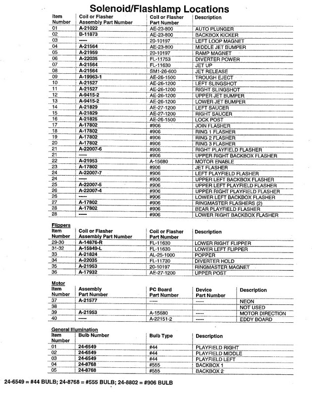

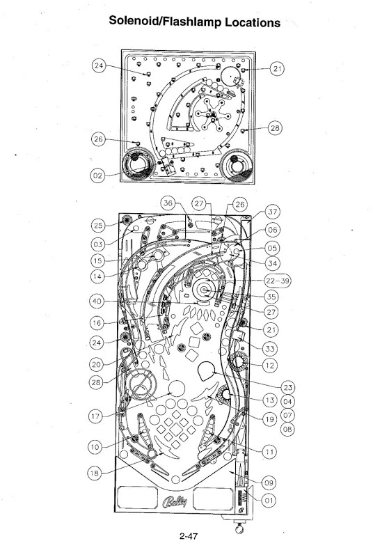

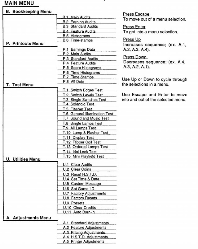

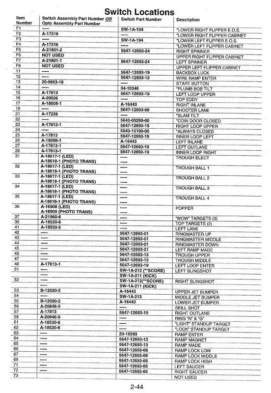

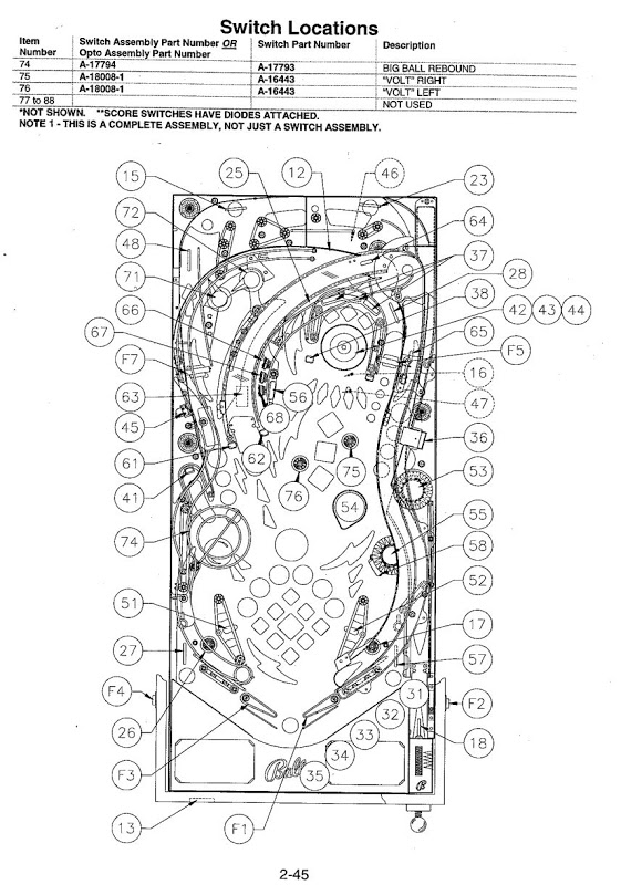

chriz99 Posted December 27, 2010 Author Posted December 27, 2010 you have to download the pinball manual for the solenoid/switch/lamp matrix numbers (check ipdb.org for manual download) for example, cirqus voltaire (I use always switch and solenoid pages). good advice is to print these pages. ---> now go to your pinball, start the table and switch to the pinmame test menu (end/opencoindoor key, keys 7-0 to navigate). go to test menu -> solenoid test and flasher test ---> now you can assign the flasher and solenoid numbers to your various contactor, rgb led, knocker equipment, like: ---> share your config with the community cheers chris [sIGPIC][/sIGPIC] * taito egret 29 candy cabs * indy & star wars pachinkos 17" bartop with ledwiz rgbleds * 10" bubble bobble & galaga bartop * arm champs 2 check out hi-res backglasses * best vpin performance * ledwiz config and software

njay Posted December 27, 2010 Posted December 27, 2010 Thanks, i am testing it now... if you change the port numbers in the excel file should it change the output? if so that is not working here My Mini Pin Build: http://www.hyperspin-fe.com/forum/showthread.php?t=5622 My Arcade Bartop Build: http://www.hyperspin-fe.com/forum/showthread.php?t=14570
njay Posted December 27, 2010 Posted December 27, 2010 nevermind i need to match the flashers numbers to the port numbers in the file My Mini Pin Build: http://www.hyperspin-fe.com/forum/showthread.php?t=5622 My Arcade Bartop Build: http://www.hyperspin-fe.com/forum/showthread.php?t=14570
chriz99 Posted December 27, 2010 Author Posted December 27, 2010 you can do your own config and change the port numbers in the excel-config-file with your equipment, but it would be easier for the community to have a "little" standard. so we could share our config plug and play. cheers chris [sIGPIC][/sIGPIC] * taito egret 29 candy cabs * indy & star wars pachinkos 17" bartop with ledwiz rgbleds * 10" bubble bobble & galaga bartop * arm champs 2 check out hi-res backglasses * best vpin performance * ledwiz config and software
njay Posted December 27, 2010 Posted December 27, 2010 Yes that is true ... i got it to work now with my config, if we make a standard config i can change my cabeling. Question: how do you now if the rgb led gives the correct color when i hit frank it lights up top left and center flasher , blue and red i thought... in the manuals? My Mini Pin Build: http://www.hyperspin-fe.com/forum/showthread.php?t=5622 My Arcade Bartop Build: http://www.hyperspin-fe.com/forum/showthread.php?t=14570
chriz99 Posted December 27, 2010 Author Posted December 27, 2010 Yes that is true ... i got it to work now with my config, if we make a standard config i can change my cabeling. Question: how do you now if the rgb led gives the correct color when i hit frank it lights up top left and center flasher , blue and red i thought... in the manuals? a standard would be awesome! you can see the flashercolor and position when you start a flasher via testmenu cheers chris [sIGPIC][/sIGPIC] * taito egret 29 candy cabs * indy & star wars pachinkos 17" bartop with ledwiz rgbleds * 10" bubble bobble & galaga bartop * arm champs 2 check out hi-res backglasses * best vpin performance * ledwiz config and software
