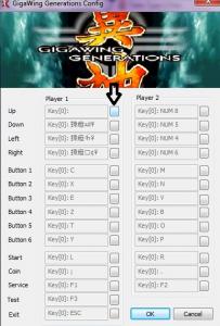

langersld Posted January 4, 2014 Posted January 4, 2014 Sithel said: So here I am a few hours later, I got everything setup according to you tutorial video, and everything went smooth until the configuring keys part. When I start up the pad_config I can set all the keys but no matter what I do clicking "OK" does nothing like it never registers. I even tried tabbing til it highlighted OK and pressing enter and still nothing, so I have to X it out or hit Cancel which in doing so saves nothing. So my simple idea was to copy over your xbox config typex_bindings which copied over fine and even showed the keys correctly. But in game the controller doesn't work, everything is in it's default state still, like F1 being insert coin. This is for every game that uses pad_config. The other games like arcana heart 3 and xb_loader works perfectly with remapping keys. Any ideas here?As far as the tutorial video though, everything was spot on and followed perfectly and everything loads up, just key remapping is acting weird. Sithel how are you selecting the key inputs in pad_config.exe... are you using your mouse to select the appropriate key config? The small square behind each input needs to be pressed before you can register a new input. as per picture below

Sithel Posted January 5, 2014 Posted January 5, 2014 langersld said: Sithel how are you selecting the key inputs in pad_config.exe... are you using your mouse to select the appropriate key config?The small square behind each input needs to be pressed before you can register a new input. as per picture below [ATTACH=CONFIG]36742[/ATTACH] This is correct, I click the box with my mouse then press the appropriate key. It registers the new key, I then continue all the way down changing all the keys then go to click "OK" and clicking that does nothing. So by not being able to click OK, nothing saves and I have to click Cancel or X out the config. Saving Gigapig's Xbox config saves the keys he added into it, but when I go into game nothing is working with those key presses. It's still using all the default key maps.
gigapig Posted January 5, 2014 Author Posted January 5, 2014 Sithel said: This is correct, I click the box with my mouse then press the appropriate key. It registers the new key, I then continue all the way down changing all the keys then go to click "OK" and clicking that does nothing. So by not being able to click OK, nothing saves and I have to click Cancel or X out the config. Saving Gigapig's Xbox config saves the keys he added into it, but when I go into game nothing is working with those key presses. It's still using all the default key maps. What controller are you using? And do you use xpadder? Once you have gone through the setup can you just fit enter on the keyboard, to save the settings? Have a look at this also, it shows a "?" next to joy, this happens if the pad is switched off when you start Pad_config. Does yours show Joy[0]? BTW, from your earlier post, I'm very glad you followed the guide and in a few hours you were set (apart from this of course) nice one.
Sithel Posted January 5, 2014 Posted January 5, 2014 **Update to all this.. I really didn't do anything but I have my whole hyperspin drive on a test PC and everything else works perfectly in every emulator I have. Being that I was having this issue, I just unplugged the drive and stuck it on the PC I will using in my arcade cabinet. (Still a work in progress) Doing everything the same, I was now able to edit all the keys and save it by clicking "OK". Now all games are working that I have by following your tutorial. On my test PC I think it was Raiden III or IV, whichever one has that Green square at the bottom. Anyways I had that, but on my cabinet PC it's not there at all which is good. My arcade PC is a much newer PC with a Geforce 470 gtx so no idea if its a driver or video card issue, but thought I'd mention it. Side note is that all these weird key mapping issues could have come from my anti virus blocking and quarantining things even though I told it not to. Seems like a few of these files are false positives I assume. Next up is following your guide to Otomedius. Oh and btw, maybe not related to this topic but I have Contra Evolution Revolution, which plays fine outside hyperspin. But inside I can't get AHK to remap keys or fix the crash when trying to exit the game. Maybe if you have this game and wanted to make a quick tutorial for it that would be great! Again, thanks for all your work! ** Oh and quick edit In task manager is it normal that the irotate is still running even after I exit the vertical games?
