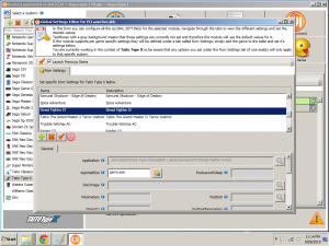

iNTiGOD Posted September 28, 2015 Posted September 28, 2015 Struggling to setup street fighter iv and super street fighter. I seem to be able to launch them outside of rlauncher without issue but when I use rlauncher I get an error (jvs 0000) on loading. Found a video on YouTube which is similar to the problem I'm having. https://m.youtube.com/watch?v=nww-TZJN91Q I've tried the different arcade versions aswell. Any ideas chaps? MAME High Score Tutorial For HyperSpin

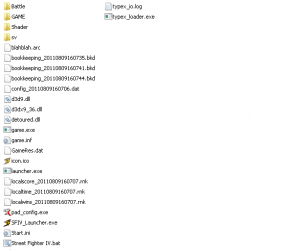

iNTiGOD Posted September 28, 2015 Posted September 28, 2015 Here is the original thread iNTiGOD. http://www.hyperspin-fe.com/topic/3694-taito-type-x-hell-on-earth-jvs-0000-library-error/?hl=%2Bstreet+%2Bfighter+%2Btaito Thank you so much for this.... I managed to get super street fighter running in rlauncher as per the video from lsdguy. Still struggling to get streetfighteriv running. Ive attached a copy of my ssiv folder contents... does it look ok gigapig? Seems to launch happily using the Street Fighter IV.bat from windows explorer but again launching from rlauncher gives that same error. Ive also attached a screen shot of rlauncher. MAME High Score Tutorial For HyperSpin
iNTiGOD Posted September 28, 2015 Posted September 28, 2015 I've taken a step back and thought for a moment.. Whats the difference between sfiv and supersfiv arcade edition? I don't really think i need both versions so ill just stick with the arcade edition. I think ill put my energy into getting my fades setup for this system and ensuring the programs don't loose focus after launching. Thanks anyway gigapig! MAME High Score Tutorial For HyperSpin
