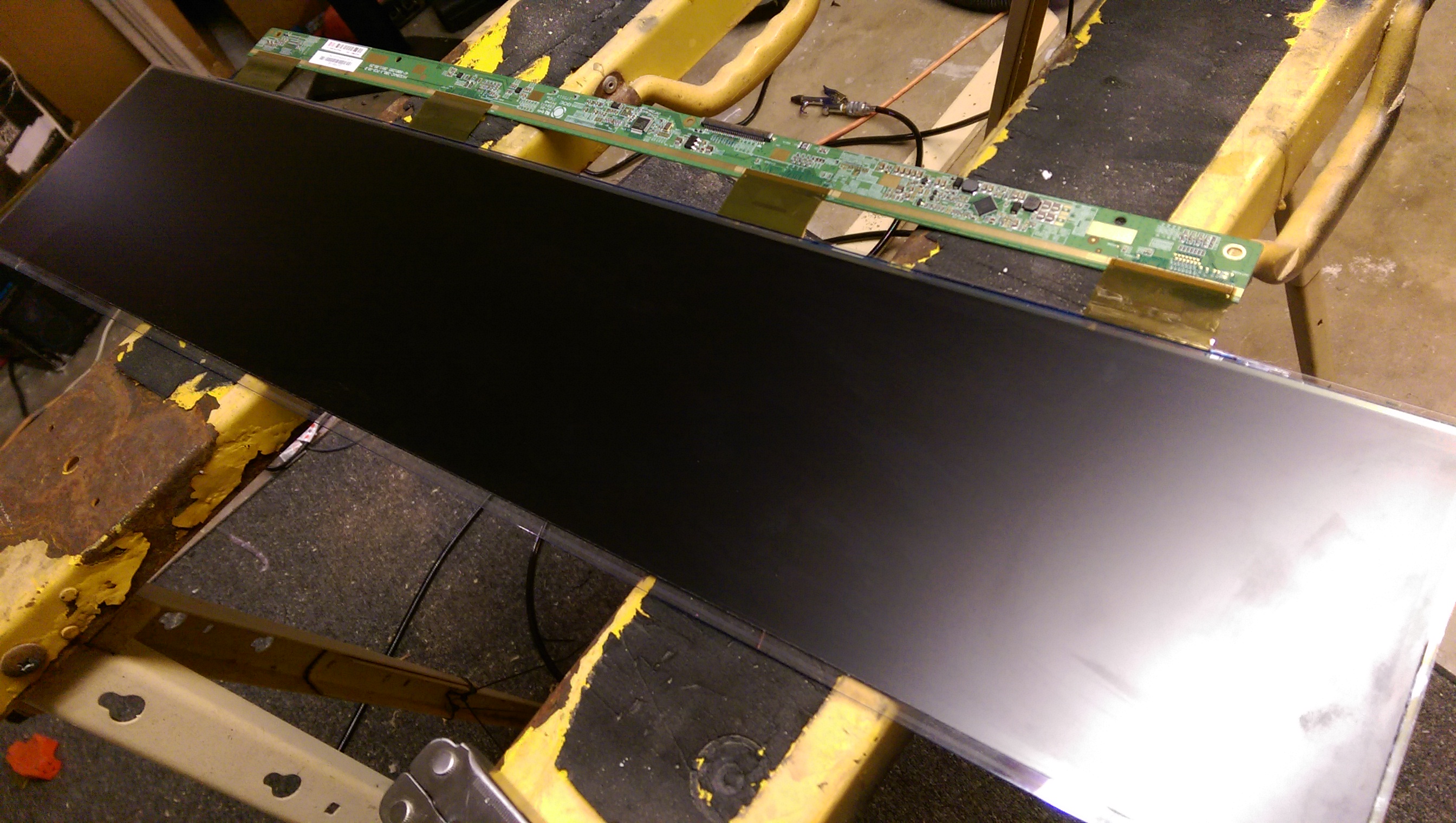

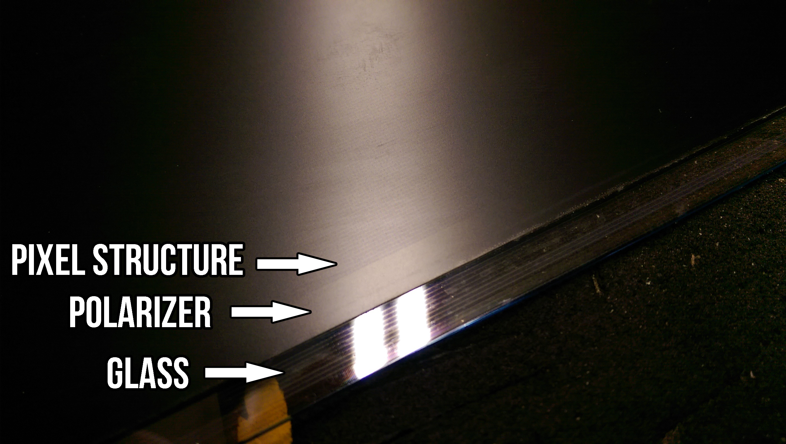

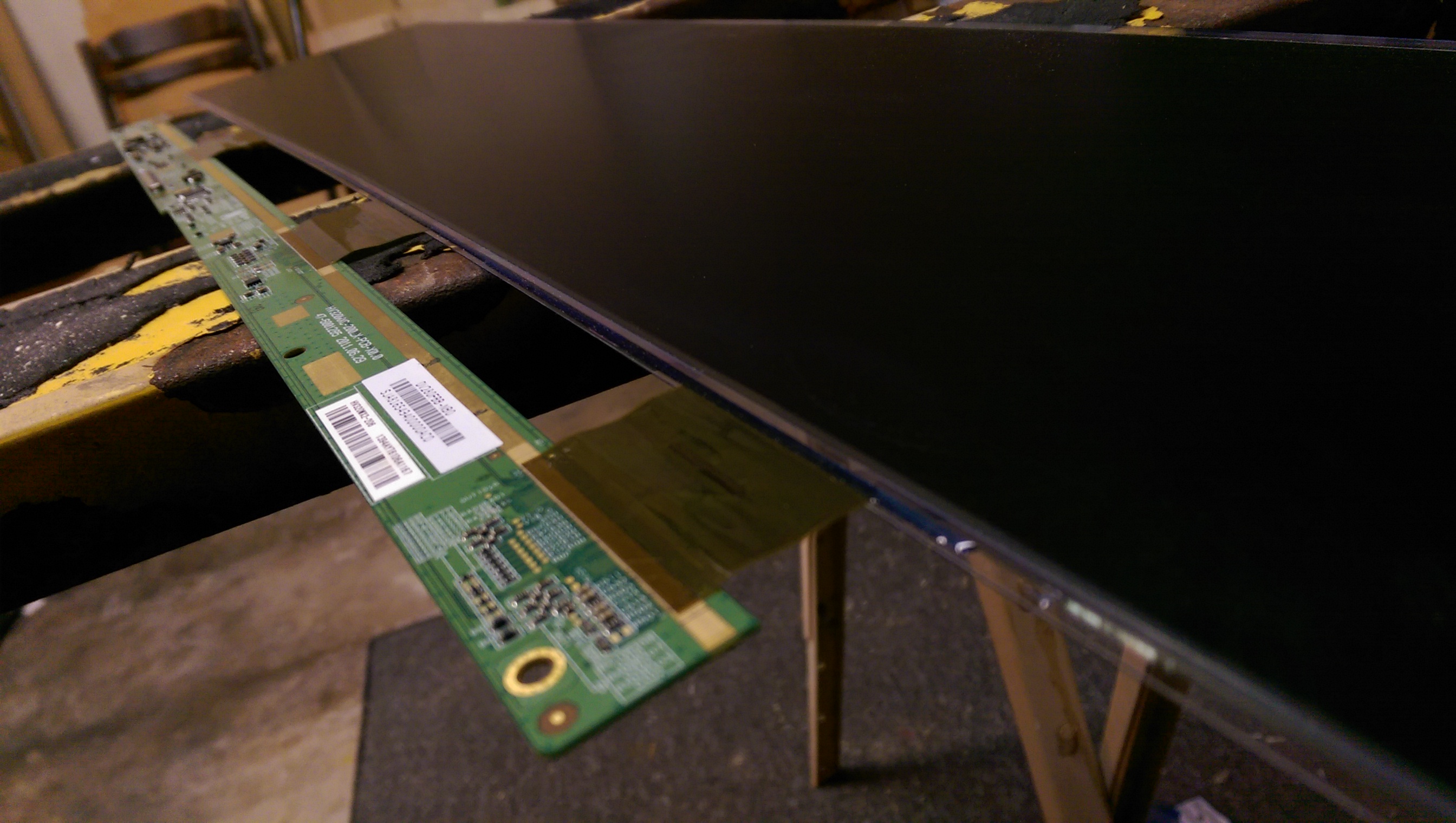

scoodidabop Posted February 7, 2017 Author Posted February 7, 2017 On 2/7/2017 at 12:48 PM, gigapig said: What do you actually search for when looking for one of those? Is it a certain size? Expand I got lucky that one of Vitrolight's panels fit my cabinet design perfectly. The have many sizes to choose from: http://www.ebay.com/itm/New-32Inch-1-2-Stretched-Bar-LCD-display-digital-advertising-screen-/291698159083?hash=item43ea90adeb Start there and email them. They have other sizes that aren't on their ebay page. Plus you'll get a slight discount for buying direct. Be patient though - their customer service reps have somewhat broken english so communication can be a little tough. Here's the LCD itself. Top signal board and ribbon cable. Pretty standard stuff... Now the area of interest: The bottom line where the LCD has been cut back... Then there's the backlight assembly and frame. Containing a full 8 to 10 layers of different diffusion materials, all cut to fit into the custom frame. I'll get a pic of that if you guys want to see it. So, yeah these things are made with precision. Probably just in very small runs, which is why they're so expensive. I don't see a DIY solution being possible but it if you have a chainsaw I'd love to see you try it! As an alternate LG makes an "ultra wide" that's about 28" x 13". It's pretty tall but might work in a Capcom "Big Blue" style cabinet: http://www.ebay.com/itm/like/122101593219?lpid=82&chn=ps&ul_noapp=true Unfortunately if I modified my cabinet design to fit that 13" tall LG it would look very top-heavy and unbalanced (see below). Maybe I should go back to the drawing board and figure out a design that fits the LG because I'd love to put an LCD marquee in every cabinet I do but they're just too cost-prohibitive for most builds:
