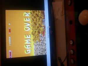

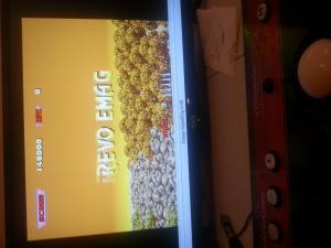

Griggs2d Posted June 18, 2016 Posted June 18, 2016 Hello! This is my first time posting. I love the settings and thanks for sharing them. I have a question about an issue I have. When I add rounded corners a portion of the screen is clipped from the left and right. I have some images for your review. Any advice is apreciated. Thanks again!
