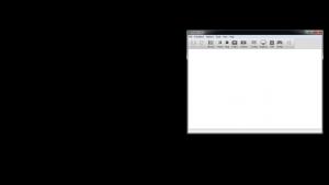

I am trying to launch Mario kart gp 2 via hyperlaunch hq but I just get a black screen.
I have dolphin triforce version 3.0 694 which runs the game superbly outside of hyperspin ( none of the newer versions worked well for me)

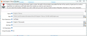

I have noticed the hyperlaunch ahk for dolphin triforce is for version 3.0 693, unfortunately I cannot find this version anywhere in x86 form or a 3.0 694 ahk for that matter.
Ive also read that people are using pc launcher to run this but I cannot find a easy tutorial for this particular game.

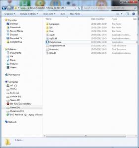

So I'm able to run the game fine outside of Hyperlaunch with version 697 of Dolphin Triforce, I've also tried both x86 and x64 versions as well as version 694 x86 and also the latest from here.

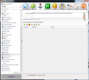

I'm assuming the Rom path would just point to where the GP2 iso is, like I have here and that's it with regards to set up, or is there something we've missed?

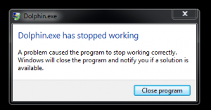

I am getting this error while running the game through HL, which doesn't tell me much.

@Fire10
Had you setup the config in Dolphin? You need cheats enabled, also under Gamecube set Sp1 to AM-baseboard and the same for port 1.
I will Dropbox you my version 697.
The module is for an older version so that might be the problem.
Apparently the recent builds now also support F-Zero AX and the first Mario Kart GP, didn't test them yet though.
I think that's old news and refer to unlocking the AX version from the Gamecube release. New triforce builds should run the actual triforce dumps, at least that's the info I got a few days ago.
Got it working with version 3.0 694, will use 697 tomorrow and see if still working. You need to work with the configuration/video config because some settings make it crash like the example giga posted.
Was having trouble because I was using the latest version 4.0 684 from the git :( but reverted to old version and it works. Game is a little crappy, Mario, mario, mario is, mario that ... uggghhh STFU!!!! lol

It gets stranger and stranger. I found version 693 which looks promising, but no instead of launching that version Hyperlaunch decides to launch version 4.02 which I'm using for Gamecube. WTF? Is there some sort of conflict there or registry thing going on? I need a break. :(
Clucking Bell!!
At last I've got the bugger working. As above it was still starting version 4 instead of version 3-693.
So I've renamed the Dolphin exe to Dolphin1.exe and it worked Phew!!
Version 3-693 got to the press gas pedal part, I pressed the gas pedal and then black screen.
Bersion 3-697 works as it did normally.
Happy Happy Joy Joy.

Mmmm... I forgot to mention that. I have mine as DolphinDW.exe ... and yes, the exe conflicts with the Dolphin (GC and Wii) one. It's on registry and in user documents. The only way to separate them is by that as far as I know.
I'm happy that you got it working. I have it now in version 697 and everything is ok I guess 95% of the time. As far as configuration goes, I will post a screenshot when I get home ok. :)
