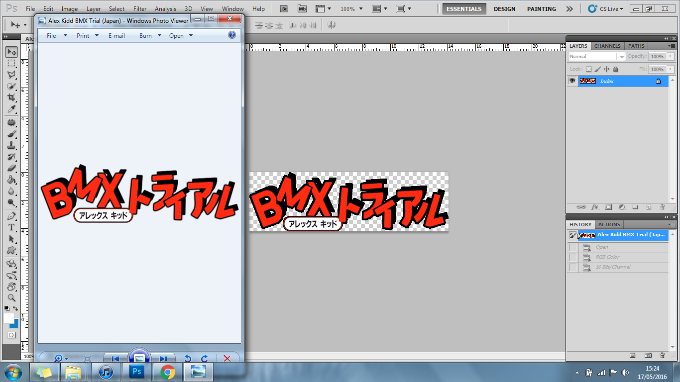

Retro Goonie Posted May 17, 2016 Posted May 17, 2016 For some reason I'm having a problem when placing wheels into Photoshop! I just downloaded the "Sega Master System Official HQ wheel pack 1.2" and wanted to convert the wheels to 16:9 for my setup. If you double click a wheel to view it in "windows photo viewer"....it looks fine. But when I drag and drop a wheel into Photoshop it changes the wheel so it has jagged edges?! (Please see photo) Never had this problem before so a bit puzzled! Does anyone have any idea whats going on? My Artwork! Carts: GCE Vectrex 2D Carts (Realistic Version) 1.0, GCE Vectrex 2D Carts (Vector Version) 1.0 Pointers: NEC PC Engine Pointer(s), NEC SuperGrafx Pointer(s), Sega SG-1000 Pointer(s), Sega TecToy Pointer(s), Sega Mega Drive Japan Pointer(s), Nintendo 64 Pointer(s)

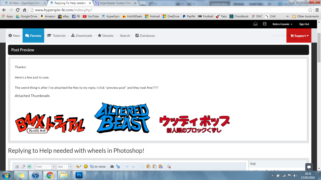

Retro Goonie Posted May 17, 2016 Author Posted May 17, 2016 Thanks! Here's a few just in case. The weird thing is after I've attached the files to my reply, I click "preview post" and they look fine!?!?! My Artwork! Carts: GCE Vectrex 2D Carts (Realistic Version) 1.0, GCE Vectrex 2D Carts (Vector Version) 1.0 Pointers: NEC PC Engine Pointer(s), NEC SuperGrafx Pointer(s), Sega SG-1000 Pointer(s), Sega TecToy Pointer(s), Sega Mega Drive Japan Pointer(s), Nintendo 64 Pointer(s)

JayC Posted May 17, 2016 Posted May 17, 2016 Whait a minute...why are there three stages in the history panel? - Open - RGB Color - 16bit Bits/Channel Have you done that or PS by itself? There should only be the - Open stage when you open something and the files are already RGB, and why would you need it to be 16 bit?
Retro Goonie Posted May 17, 2016 Author Posted May 17, 2016 Whait a minute...why are there three stages in the history panel? - Open - RGB Color - 16bit Bits/Channel Have you done that or PS by itself? There should only be the - Open stage When I drop the file into Photoshop, the layer is locked so I cannot use "Free Transform" to make it fit 16:9. By changing it from "Indexed Color" to "RGB color" it unlocks the layer for me. The "16Bits/channel" was me clicking around, in frustration, to see if it made a difference to the image "do you use openGL with photoshop?" - I would have to say no as I don't know what openGL is! I have no clue when it come to Photoshop settings! I normally just open Photoshop and it just..kinda..works! My Artwork! Carts: GCE Vectrex 2D Carts (Realistic Version) 1.0, GCE Vectrex 2D Carts (Vector Version) 1.0 Pointers: NEC PC Engine Pointer(s), NEC SuperGrafx Pointer(s), Sega SG-1000 Pointer(s), Sega TecToy Pointer(s), Sega Mega Drive Japan Pointer(s), Nintendo 64 Pointer(s)
JayC Posted May 17, 2016 Posted May 17, 2016 Ok, well to start with, does the image look as jagged when you import it or is it jagged only after you "unlock" it? You know you can unlock a layer by just clicking the lock symbol on the layer panel right If it doesn't work then you might have to double click the layer. What PS version are you using btw? OpenGL means that PS can use your graphics card (if it is compatible) to work faster and make cleaner screen results. You can easily check this by going to Edit/Preferences/Performance and check if the Use Graphics Processor is enabled. If it is, then try disabling it or updating your graphics card drivers, what GPU are you using? I have honestly never seen that happen before. Maybe a reinstall would be in order?
Retro Goonie Posted May 17, 2016 Author Posted May 17, 2016 Ok, well to start with, does the image look as jagged when you import it or is it jagged only after you "unlock" it? The image is jagged when I first open it. It doesn't matter if I "drag and drop", use "File>open", or if I right click the wheel and select "open with". You know you can unlock a layer by just clicking the lock symbol on the layer panel right If it doesn't work then you might have to double click the layer. I know, but for some reason that doesn't work on these files?! Neither does double clicking and if I right click on the layer, all my options are grayed out?! What PS version are you using btw? CS5 Extended Version 12.0 check this by going to Edit/Preferences/Performance and check if the Use Graphics Processor is enabled. If it is, then try disabling it or updating your graphics card drivers, what GPU are you using? I have honestly never seen that happen before. Maybe a reinstall would be in order? I can't see "Use Graphics Processor" any where but there is the option "Enable openGL Drawing" which is checked. Turning this option off makes no difference. My GPU is an "nvidia geforce 9300m gs". I'm not feeling a reinstall as this is only a problem with these wheels. It doesn't happen with any other files! My Artwork! Carts: GCE Vectrex 2D Carts (Realistic Version) 1.0, GCE Vectrex 2D Carts (Vector Version) 1.0 Pointers: NEC PC Engine Pointer(s), NEC SuperGrafx Pointer(s), Sega SG-1000 Pointer(s), Sega TecToy Pointer(s), Sega Mega Drive Japan Pointer(s), Nintendo 64 Pointer(s)
