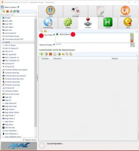

gigapig Posted June 7, 2016 Posted June 7, 2016 Not sure what you mean about relative path. In my settings ini fille it shows patch which is c:\ but in a usb it won't always be (ex. g: h: j:) so I have no idea what relative path if you can help me thanks I used the same method for the 51 System build (available to Platinum members in the download section, Plug) so users would not need to worry about paths other than Roms and if you do it correctly you don't need to worry about that either. For me it's how you set up the folders. Simply create an Emulators folder and a Roms folder in your HyperSpin folder. Open the Settings.ini file located in the ":\HyperSpin\Settings" folder and change the HyperLaunch path to Hyperlaunch_Path=..\RocketLauncher\Rocketlauncher.exe You then just set up RLUI as normal and it should detect the relative path like in the picture below. If I've missed something then let me know. The only problem I see is with disc based systems that use DTLite.
