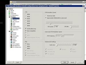

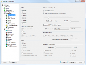

iNTiGOD Posted March 26, 2015 Posted March 26, 2015 Hoping Mr Ron can help me with this one. It seems after setting up this system the games seem to be on fast forward. Music plays at normal speed but the graphics are running at double speed (e.g. LED storm the car jumps and lands within a split second) or bubble bobble movement is 3x as fast as normal. Any ideas? There are so many options in winuae I wouldn't know where to start. Thanks MAME High Score Tutorial For HyperSpin
rfancella Posted March 26, 2015 Author Posted March 26, 2015 Hoping Mr Ron can help me with this one.It seems after setting up this system the games seem to be on fast forward. Music plays at normal speed but the graphics are running at double speed (e.g. LED storm the car jumps and lands within a split second) or bubble bobble movement is 3x as fast as normal. Any ideas? There are so many options in winuae I wouldn't know where to start. Thanks Hi, Backup your amigahost.uae file from your WinUAE/Configurations/Host directory. Launch WinUAE outside HS and HLHQ. Load your existing amigahost.uae file. Click on CPU and FPU on the top left. Post a screen shot of that screen. This is mine: Thanks, Ron PS: If you make any chages to your config, be sure and save it back over your existing .../WinUAE/Configurations/Host/amigahost.uae Code Monkey and all around Command Line geek!If you like what someone has said or done for you, be sure and 'Thank' them. And if they changed your life, send them a Beer!
iNTiGOD Posted March 26, 2015 Posted March 26, 2015 Thanks Ron, Please take a look at mine below. There are some differences in my attachment but also cycle-exact emu speed is greyed out. I took the screen grab over remote desktop connection so that could be why. Ill check after work later. Edit.... Took a look at my screen shot and it has options greyed out that are different to yours... I've changed the cpu to 68000 and it seems ok.? MAME High Score Tutorial For HyperSpin
