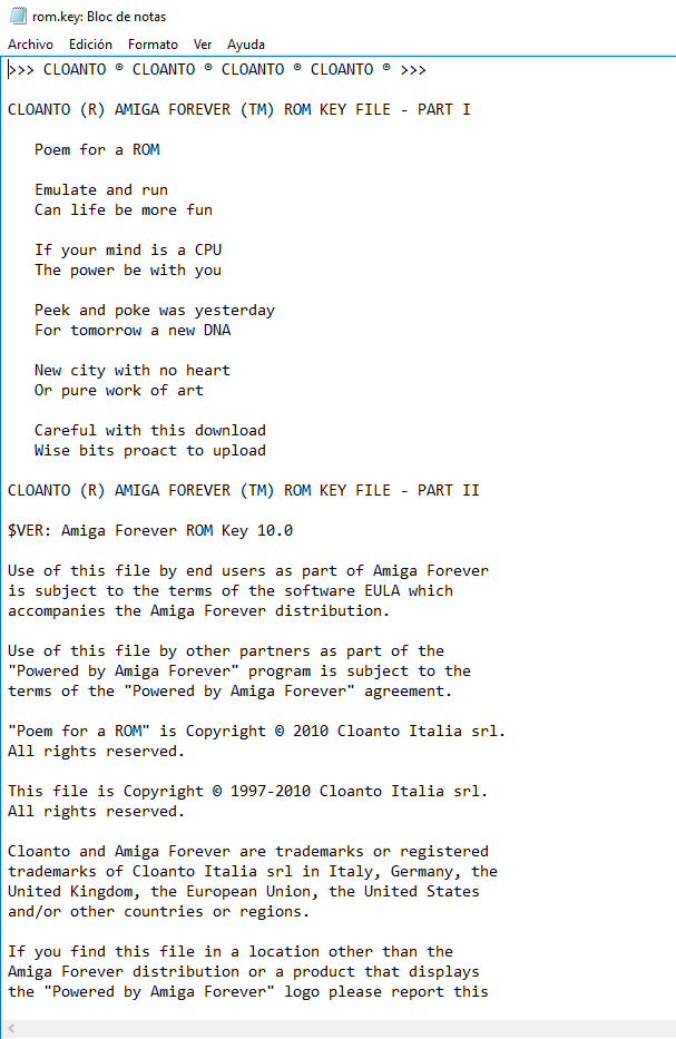

ci2own Posted March 2, 2017 Posted March 2, 2017 I did a new install: Extracted WinUAE 3.4.0 on D:\Emulators\WinUAE\WinUAE\ Extracted WHDLoad_usr.lha on D:\Emulators\WinUAE\WinUAE\ Create "rom" folder in D:\Emulators\WinUAE\WinUAE\ Placed OS Roms with Key in D:\Emulators\WinUAE\WinUAE\rom\ Games are working but still can see the "Not Registered" Screen when launch a game. (No Kickstarts ROMs added) Maybe the OS Folder Key.ini is wrong? It has a poem inside ?
