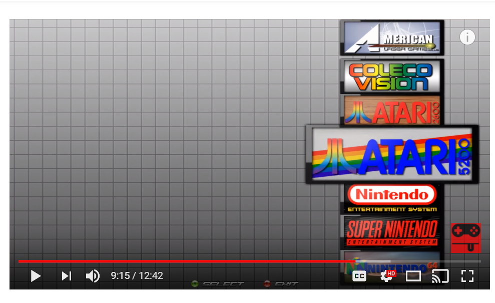

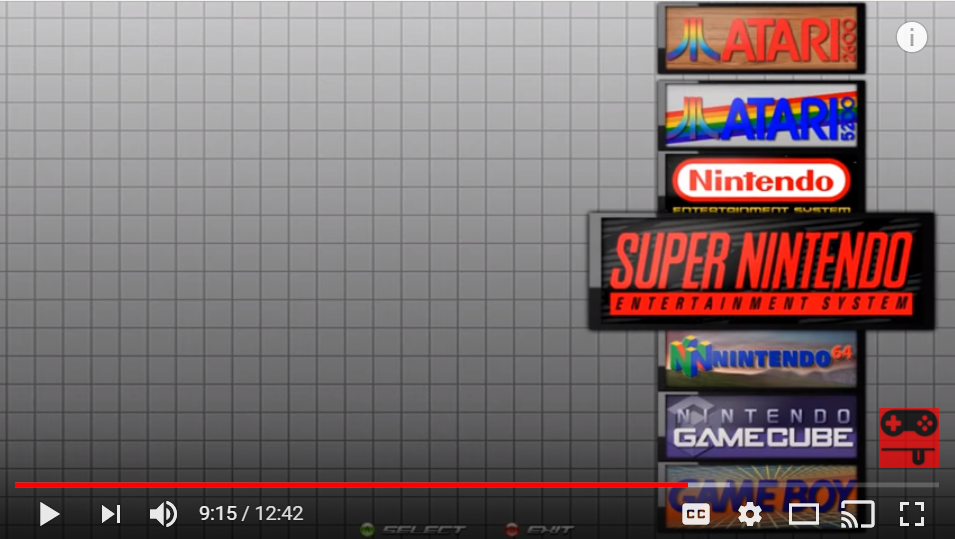

dugan26 Posted November 16, 2017 Posted November 16, 2017 thanks for all the help - I got 3 emulators working perfectly and now its just a matter of repeating for all .. i get it now ... wicked program really! this is amazing Mind if i ask ? How do i get this look? I found this on Simply Austin's youtube site but cant figure out where to get the artwork for this type of look. The wheel is not curved and the art work is "boxed" up with nice black backgrounds I really like that ... is this some kind of hyperspin skin?
thatman84 Posted November 16, 2017 Posted November 16, 2017 The wheel set is on one of his 1st setup vids but the actual set is from @DamnedRegistrations and is on the HS ftp which needs a premium membership. Dont think its hosted anywhere else. I have done some edits myself to the pack. If its ok with DR i will post it. Altough that wont be for a while as moved out of home so no pc atm Hyperspin 2.0 Latest Download Hyperspin 2.0 Documentation -------Pre Hyperspin 2.0 Below---------- HS Android Overview & Install HS Android Base Pack Download My Tutorials
