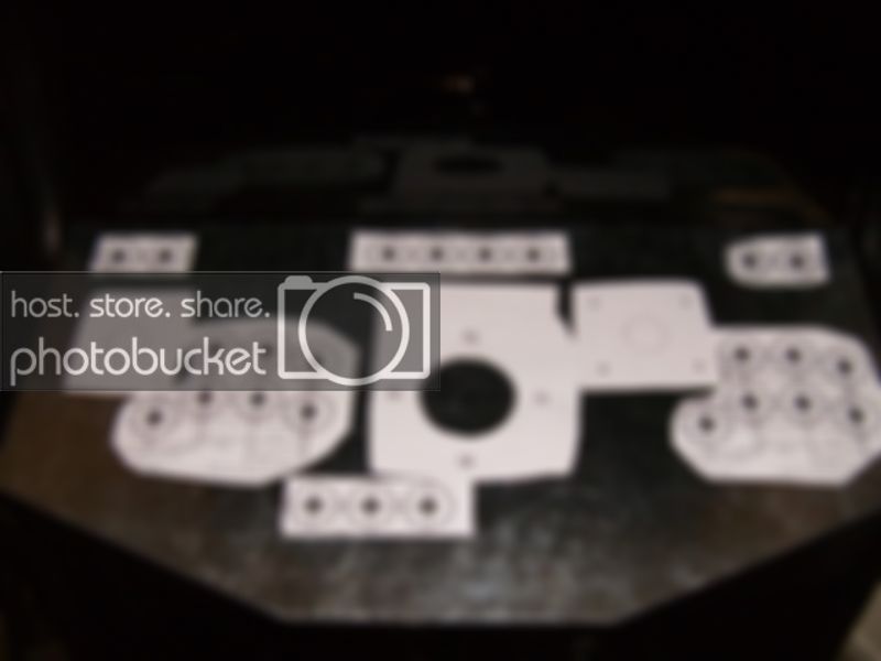

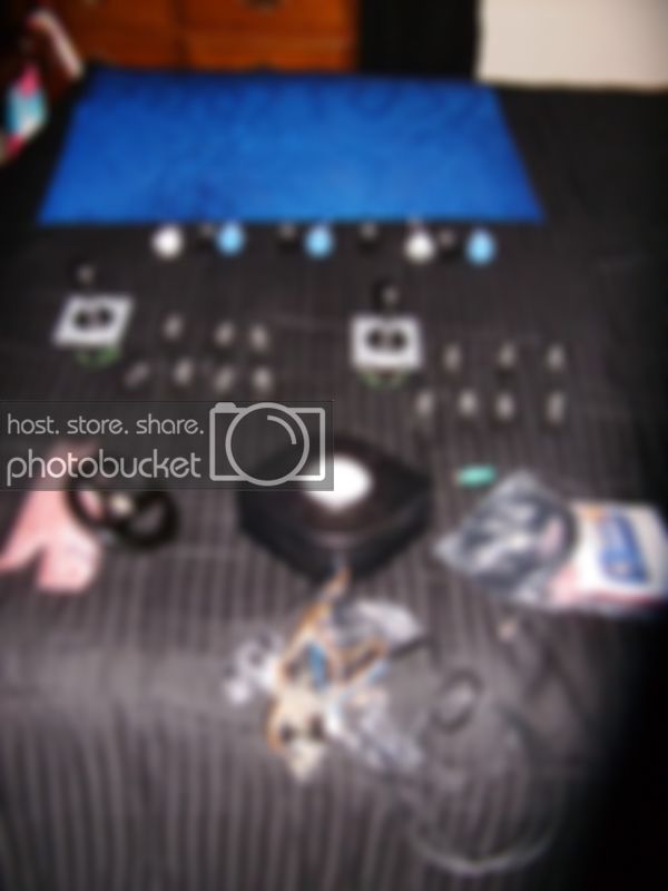

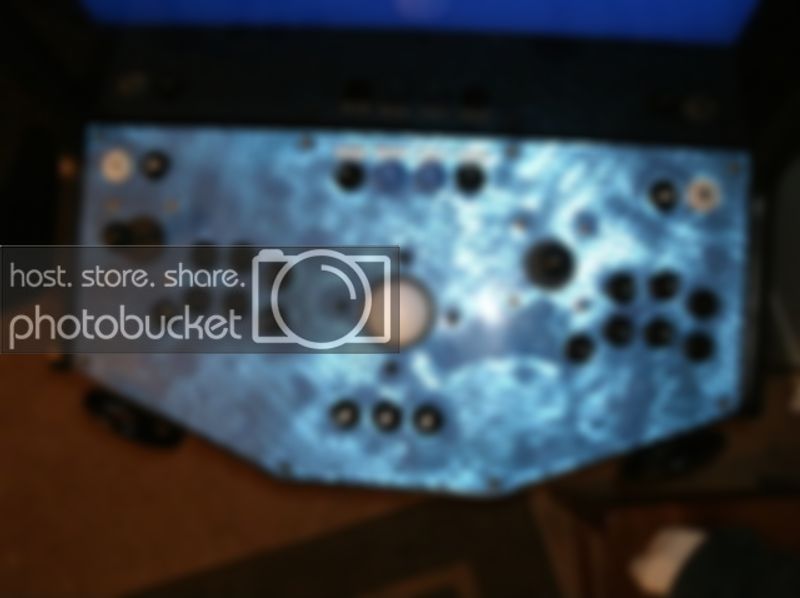

koolbrez67 Posted March 19, 2010 Author Posted March 19, 2010 More photos of how i decided to do my control panel and a bunch of parts. I looked at the layout for 2 days. I then taped down the whole metal sheet with clear packing tape before I drilled out the holes. I killed my first drill it got thru all holes except 6. I went out bought a new drill and was pissed when it cut thru the CP like butter. I then had wished I had bought a new one in the first place. I used a 3"inch Bi meter hole saw bit for the track ball. I think the buttons where 1 1/8 inch. 1 and 3/4 for the joysticks. I used a hollow graphic plastic sheet I found at tap plastics. The lady thought I was crazy when I bought the plastic sheets for the sides. She really thought i was wierd when I said I wanted the Blue Hollow graphic sheet for the Cp. I used 3m super 77 for the CP glue. 3M 90 for the plastic sheets. Everything I used on this cab was meant to be durable and last 20 more years.

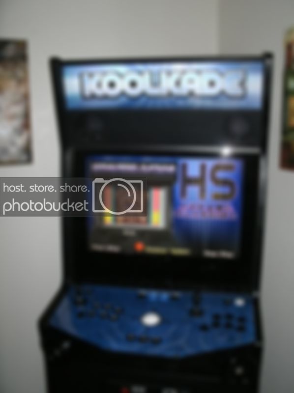

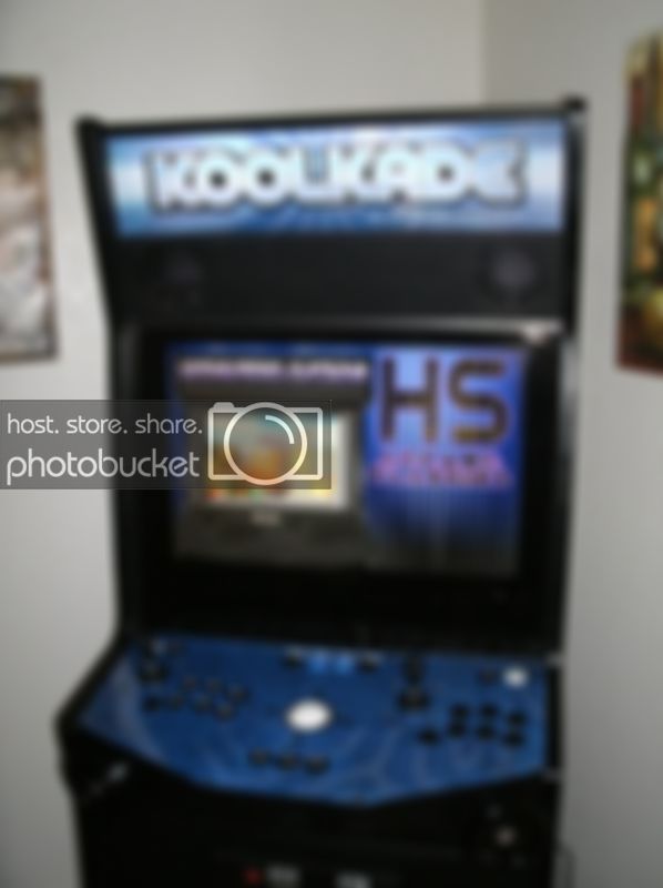

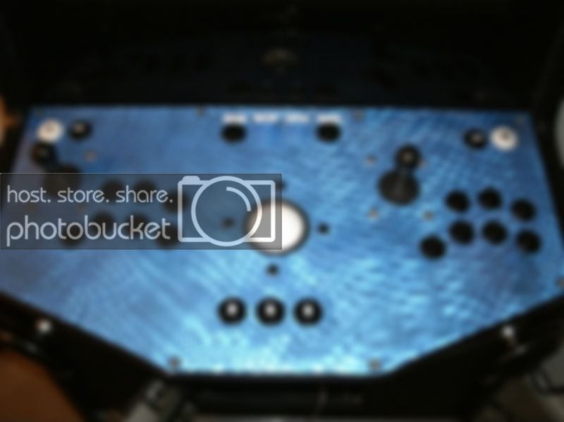

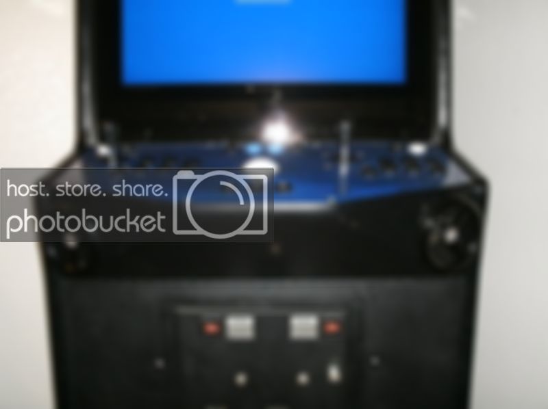

koolbrez67 Posted March 20, 2010 Author Posted March 20, 2010 Photos of my project up close and a video demoing it. <object width="500" height="405"><param name="movie" value="http://www.youtube.com/watch?v=VFAv_oGcTIM&hl=en_US&fs=1&color1=0x006699&color2=0x54abd6&border=1"></param><param name="allowFullScreen" value="true"></param><param name="allowscriptaccess" value="always"></param><embed src="http://www.youtube.com/watch?v=VFAv_oGcTIM&hl=en_US&fs=1&color1=0x006699&color2=0x54abd6&border=1" type="application/x-shockwave-flash" allowscriptaccess="always" allowfullscreen="true" width="500" height="405"></embed></object> I hope you all enjoyed it the extra photos i took.
The Loafer Posted March 20, 2010 Posted March 20, 2010 Sweet, sweet, sweet! Very nice approach to your control panel and especially to the two steering wheel attachments. -------------- (this space available for rent)
Rawd Posted March 20, 2010 Posted March 20, 2010 Love the steering wheels as well! Those must be awesome for Sprint and pole position, but you should make some sort of analog pedals? You just use the buttons for now? Very nice looking cab, excellent work man.
koolbrez67 Posted March 20, 2010 Author Posted March 20, 2010 I use the joystick since it is analog it is just like a foot petal. My son and I race all the time it feels just like an atari wheel.
