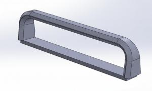

emixama Posted May 9, 2014 Posted May 9, 2014 Good work!! But you must ad the other part of the arch if you won't brake it : Maxime
manicshere Posted May 9, 2014 Author Posted May 9, 2014 Thanks guys! @emixama - Just put it on top for the picture, but thanks for looking out for me
emixama Posted May 9, 2014 Posted May 9, 2014 I put the inner arch on this part before englue it with the other part of the arch. Maxime
