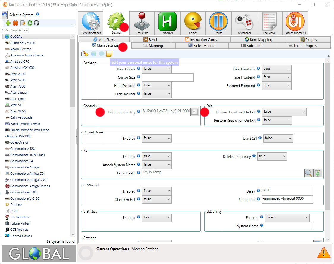

gigapig Posted October 31, 2016 Posted October 31, 2016 It pretty simple. Fire up Rocket launcher UI. Now if you want the same key/combo fir all systems then select Global in the left pane. Click the Settings tab and the make sure the Main Setting tab is selected also. You should then see a box which says Controls, Exit Emulator Key. Click the keyboard key button and in the pop up window select your options and read the tool tips if your stuck.

gigapig Posted November 25, 2016 Posted November 25, 2016 1 hour ago, djdaveoc said: Sorry to post after this is a bit stale but... Is there a way to make the hotkey for exit a button on a wireless Xbox 360 controller without using Xpadder or another 3rd party app? I want to have a button on my controller exit the emulator no matter which emulator it is. Thanks in advance. Yeah sure, just create a button combo in Rocketlauncher UI, I used to have a combo of the back button and Start, you can hold a button for a number of milliseconds. You can also have different exit buttons for different systems.

gigapig Posted November 27, 2016 Posted November 27, 2016 5 minutes ago, djdaveoc said: How do you find out what to type for each button on the wireless 360 controller? You don't type anything, you press the button with the camera icon and the press the button/s on the controller. Makes sure you set your options like Hold Time before pressing the capture button. And of course use the tool tips.
