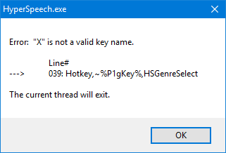

md_max Posted November 6, 2017 Posted November 6, 2017 Hi. I have not English Windows. Error, the language of the keyboard layout ENG Google Drive HyperSpin

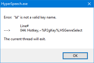

md_max Posted November 6, 2017 Posted November 6, 2017 Error, the language of the keyboard layout RUS Google Drive HyperSpin
BoOgieman Posted November 24, 2017 Author Posted November 24, 2017 On 6-11-2017 at 2:42 AM, md_max said: Error, the language of the keyboard layout RUS maybe change the Genre key to G or something else, also check if HyperSpeech.ini is in ANSI coding. HyperSpeech - Text-To-Speech Voice Addon for HyperSpin
sici Posted March 13, 2018 Posted March 13, 2018 If it can help.. This is the error for keyboard layout ITA The old version works.
