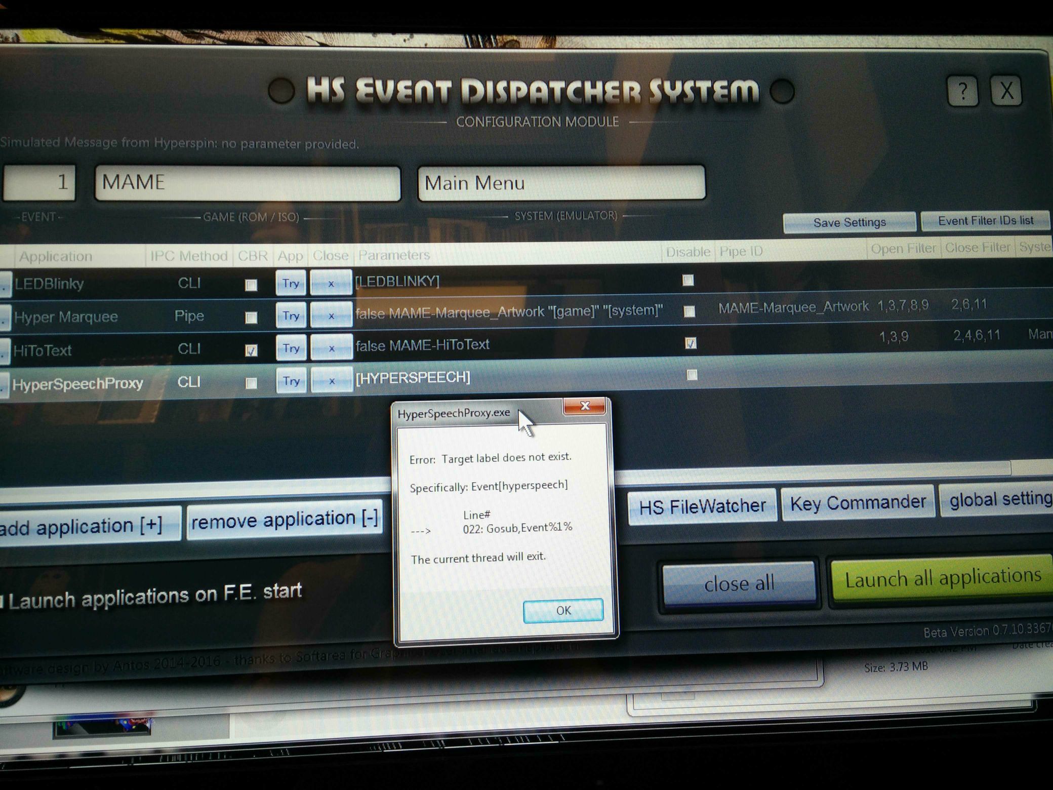

BoOgieman Posted November 30, 2016 Author Posted November 30, 2016 I think you are trying to parse info from EDS to HyperSpeech.exe. That does not work. You need to parse output to HyperSpeechProxy.exe (or LEDBlinky.exe if you renamed it). Not sure what the difference between CLI and PIPE is. HyperSpeech - Text-To-Speech Voice Addon for HyperSpin
sevenseal Posted November 30, 2016 Posted November 30, 2016 not using the lastest eds, 0.7.10 is most recent. you point eds to the proxy app for hyperspeech
shitoken Posted November 30, 2016 Posted November 30, 2016 not using the lastest eds, 0.7.10 is most recent. you point eds to the proxy app for hyperspeech Just updated but still the same.Tapatalk を使用して私の A0001 から送信
sevenseal Posted November 30, 2016 Posted November 30, 2016 Just updated but still the same.Tapatalk を使用して私の A0001 から送信 parameter should be [LEDBLINKY] not [hyperspeech]
BoOgieman Posted November 30, 2016 Author Posted November 30, 2016 EDS is parsing a wrong parameter (namely: hyperspeech) to HyperSpeechProxy, which crashes it. (I will build in a check for proper parameters to trap that nasty error in a next release) HyperSpeech - Text-To-Speech Voice Addon for HyperSpin
