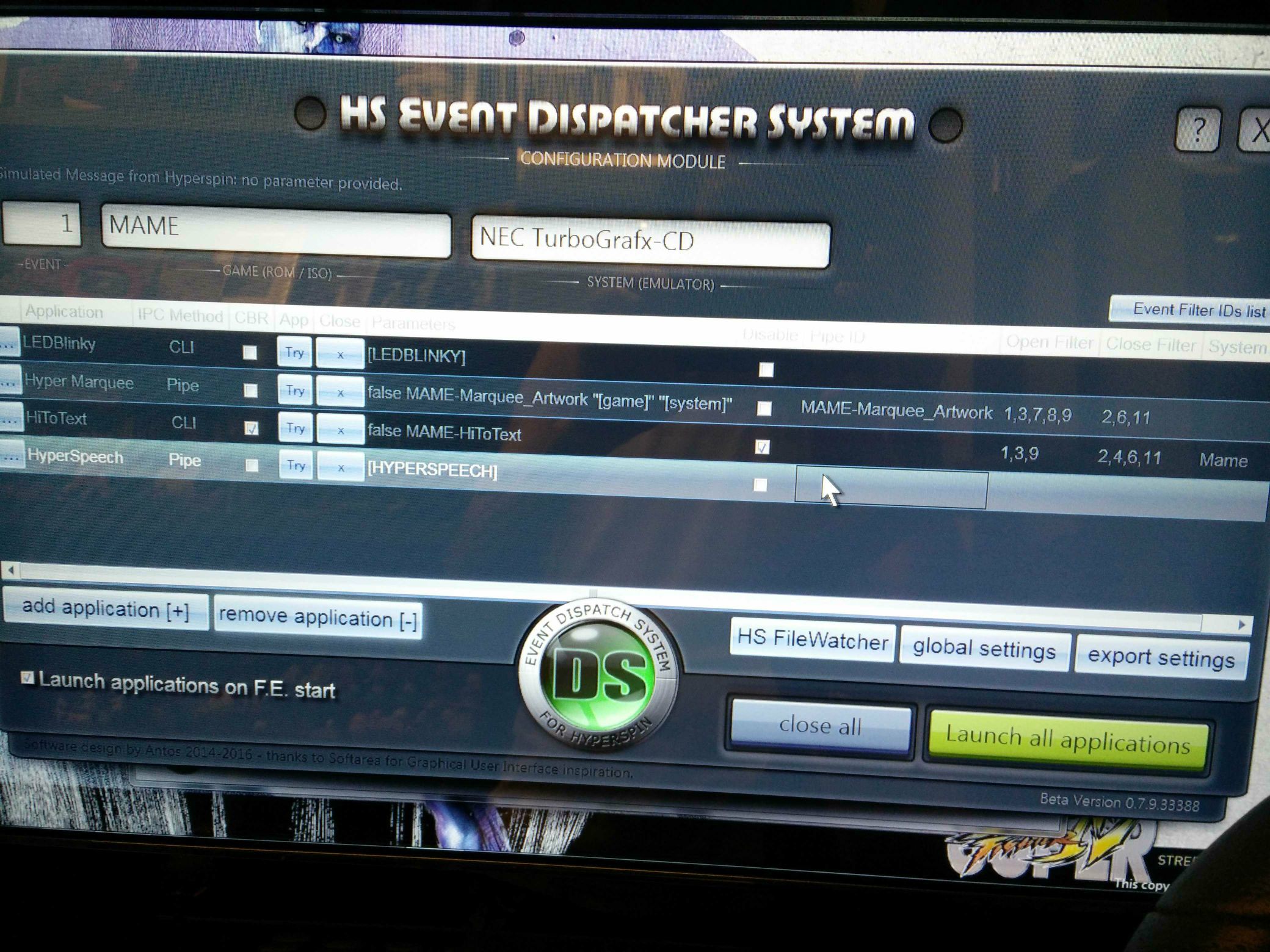

shitoken Posted November 29, 2016 Posted November 29, 2016 Really good news. I will try this out. How can I get this run with hyperspin , if I am using Hypermarquee, EDS & Ledblinky?
BoOgieman Posted November 29, 2016 Author Posted November 29, 2016 Good question. I would suggest triggering Hyperspeech's "LedBlinky" from HypeeSpin first if EDS has problems triggering it. You'll need to find out what works best for you. please share with us. HyperSpeech - Text-To-Speech Voice Addon for HyperSpin
shitoken Posted November 29, 2016 Posted November 29, 2016 Good question. I would suggest triggering Hyperspeech's "LedBlinky" from HypeeSpin first if EDS has problems triggering it. You'll need to find out what works best for you. please share with us. I was using above method but EDS has problems, I removed it with the advice from sevenseal. Any suggestions?Tapatalk を使用して私の A0001 から送信
BoOgieman Posted November 29, 2016 Author Posted November 29, 2016 I don't use EDS, but does EDS work with both the latest version of HyperSpin and LEDBLINKY? If so, you should use EDS to trigger HyperSpeech's LEDBlinky.exe (renamed HyperSpeechProxy.exe). EDS should parse the exact LEDBlinky input variables from HyperSpin to any targets it has defined. HyperSpeech - Text-To-Speech Voice Addon for HyperSpin
sevenseal Posted November 30, 2016 Posted November 30, 2016 well i will chime in here, welcome back boogiemani would suggest to link boogies' proxy program in eds and setup the app the same way LEDblinky is setup as in eds since he has update to work with hs 1.4 things are okay to work
shitoken Posted November 30, 2016 Posted November 30, 2016 5 hours ago, sevenseal said: well i will chime in here, welcome back boogieman i would suggest to link boogies' proxy program in eds and setup the app the same way LEDblinky is setup as in eds since he has update to work with hs 1.4 things are okay to work Do I need to rename the proxy to ledblinky?
BoOgieman Posted November 30, 2016 Author Posted November 30, 2016 1 hour ago, shitoken said: Do I need to rename the proxy to ledblinky? I don't think it's necessary to rename the proxy when using EDS. HyperSpeech - Text-To-Speech Voice Addon for HyperSpin
sevenseal Posted November 30, 2016 Posted November 30, 2016 Do I need to rename the proxy to ledblinky? it can be left with name as is, no need to change when using eds
shitoken Posted November 30, 2016 Posted November 30, 2016 1 hour ago, sevenseal said: it can be left with name as is, no need to change when using eds I am getting target label does not exist. Specifically : Event (hyperspeech) Line#22 Gosub, Event%1% Settings are same as Ledblinky only , I have set Open Filter 1 and Close Filter 2
BoOgieman Posted November 30, 2016 Author Posted November 30, 2016 are you using the latest versions of HyperSpin, EDS and Ledblinky? Which one gives the "target label does not exist", is EDS? HyperSpeech - Text-To-Speech Voice Addon for HyperSpin
shitoken Posted November 30, 2016 Posted November 30, 2016 are you using the latest versions of HyperSpin, EDS and Ledblinky? Which one gives the "target label does not exist", is EDS? Hyperspeech is giving this error EDS version 0.7.9.3388Tapatalk を使用して私の A0001 から送信
