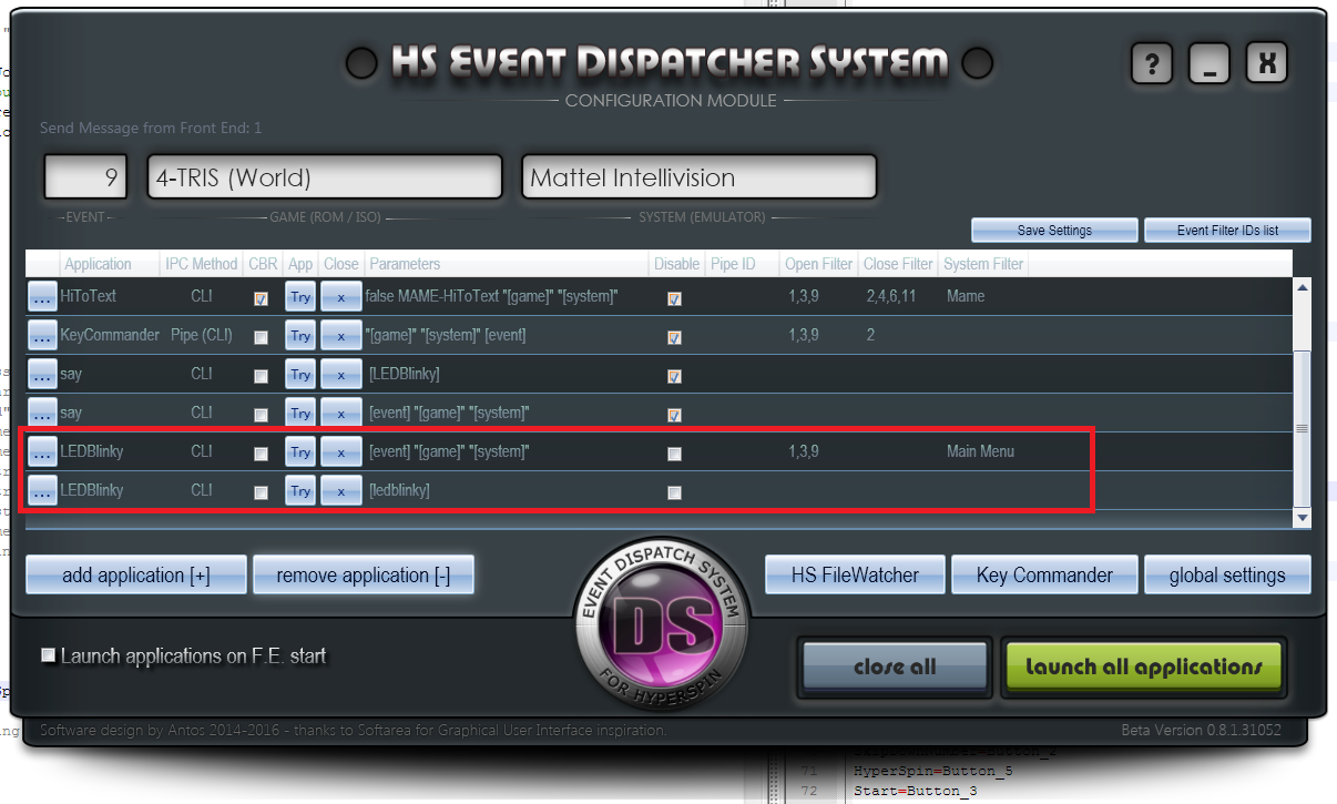

BoOgieman Posted September 26, 2017 Author Posted September 26, 2017 I might have a workaround for the Main Menu speech in HyperSpeech when you trigger HyperSpeech from EDS: Create both applications for the HyperSpeech LEDBlinky (or HyperSpeechProxy) as below: the first one only works for Main Menu, the second one works for all the rest ;-P For the time being it is either this or trigger EDS from HyperSpeech's LEDBlinky.. Hope you guys can work with this solution for now... Regards, BoOgieman HyperSpeech - Text-To-Speech Voice Addon for HyperSpin
gigapig Posted September 26, 2017 Posted September 26, 2017 1 hour ago, BoOgieman said: I might have a workaround for the Main Menu speech in HyperSpeech when you trigger HyperSpeech from EDS: Create both applications for the HyperSpeech LEDBlinky (or HyperSpeechProxy) as below: the first one only works for Main Menu, the second one works for all the rest ;-P For the time being it is either this or trigger EDS from HyperSpeech's LEDBlinky.. Hope you guys can work with this solution for now... Regards, BoOgieman Well BoOgie you appear to have cracked it So very very Happy. Thank you all
Antos Posted September 26, 2017 Posted September 26, 2017 Glad that it worked. Yes Boogie, within EDS you can pass any params that HS sends. One question, why don't you call HyperSpeech directly from EDS instead of LedBlinky? I.e HyperSpeech ~ CLI ~ [event] "[game]" "[system]" HyperMarquee & Event Dispatch System
BoOgieman Posted September 27, 2017 Author Posted September 27, 2017 8 hours ago, Antos said: Glad that it worked. Yes Boogie, within EDS you can pass any params that HS sends. One question, why don't you call HyperSpeech directly from EDS instead of LedBlinky? I.e HyperSpeech ~ CLI ~ [event] "[game]" "[system]" Antos, HyperSpeech is an AHK script that remains in memory and is feeded by OnMessage posts from the HyperSpeechProxy (aka LEDBlinky). It doesn't use named pipes like HyperMarquee. If you can help me understand how that works with AHK or if you can send me some line of AHK sample codes I can start re-coding HyperSpeech for IPC for optimal integration with EDS. So I posted a workaround, but it still isn't fixed... for the real fix I would like to ask you to please make an EDS parameter profile [hyperspeech ] for us HyperSpeech users, that is a copy of [ledblinky] but which can send the "Main Menu" text with event 9 while in the Main Menu. The [ledblinky] parameter does not do that. Fixing the [ledblinky] parameter should also do the trick. Hope you can help us out here. Regards, BóÒgieman HyperSpeech - Text-To-Speech Voice Addon for HyperSpin
