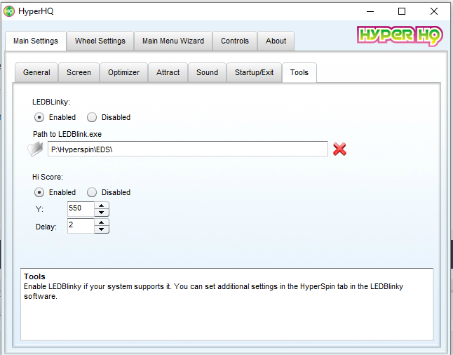

here the mini guide tofor hyperspeech to work with eds
SETUP FOR MAIN DISPATCHER AS EDS
HYPERHQ
1. Main Setting Tab > Tool Tab
2. LEDBLINKY ENTRY: Bubble in Enabled
3. Click "grey folder" icon then select the root folder of EDS (Event Dispatcher System)
EDS
1. you want to add an app by clicking the button "add application [+]" at the bottom left side of the program
2 click the button "..." select hyperspeechproxy.exe in the root folder of hyperspeech addon.
3.Fill areas as you exactly see below to make function with EDS
-=[NOTE]=-  in your hyperspeech addon, you must edit your "Hyperspeech.ini" remains to have the setting, RealLedBlinkyActive=false
