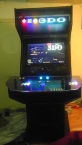

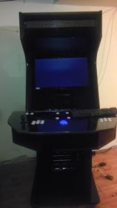

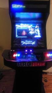

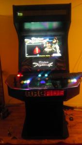

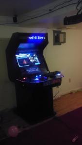

jw21575 Posted April 9, 2014 Posted April 9, 2014 Just wanted to show what I have done so far. Its far from complete but Its coming along. Most of the problems I have had with the software I have figured out by reading through a ton of forums and finding the answer. I think its an old nba jam cabinet as the original control panel had a nba logo and it was 4 players. I did decide to go with the betabrite prism for the marquee. I know a lot of people are going with lcd's but I personally like the look of the betabrite. I still have to install the monitor permanently and I also have a 2nd 7inch monitor I am going to build in to it to use with hyperspin helper to show the controls. This is an older pic but I have permanently installed the betabrite in the Marquee area. I removed it from its original casing and attached it to the original plexiglass for the marquee. I hand built and constructed the control panel and covered it with plexiglass just to keep the wood from being damaged. I was going to get a control panel overlay but once I painted the control panel black I liked it so much I just covered it with plexi. I will post a final picture when it is completed. I am using a 26 inch lcd for my monitor.
BlueGoblin Posted April 9, 2014 Posted April 9, 2014 ok that's really cool!!! A big 3DO fan i see. = )
jw21575 Posted April 9, 2014 Author Posted April 9, 2014 I do have other emulators setup. I do like the look of the 3do marquee better than the others. I mainly built this for my kids who are 6,7,9, and 11 so most of the games are for them. I have my old favorites i like to play as well. Metal slug,mvsc, and i recently started playing around with atomiswave so i can play fist of the north star which is one of my fav animes.

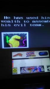

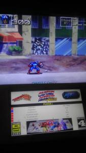

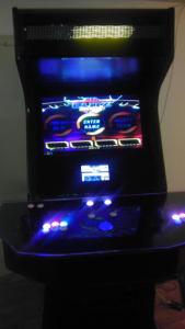

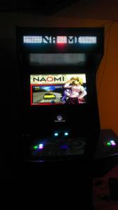

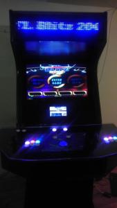

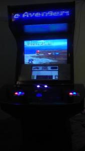

jw21575 Posted May 8, 2014 Author Posted May 8, 2014 Updated cabinet pics with 7 inch usb lcd. I will be switching that out for possibly a 10 inch usb lcd because the font is too small to read. I have a 15 inch aoc usb monitor but it doesnt look right. On the first picture i created the naomi marquee with photoshop. Still trying to figure out what i want for a bezel and side art.
sucramjd Posted May 8, 2014 Posted May 8, 2014 Updated cabinet pics with 7 inch usb lcd. I will be switching that out for possibly a 10 inch usb lcd because the font is too small to read. I have a 15 inch aoc usb monitor but it doesnt look right. On the first picture i created the naomi marquee with photoshop. Still trying to figure out what i want for a bezel and side art. Where did you get the 7" usb led? looking Good btw [sIGPIC][/sIGPIC]
jw21575 Posted May 8, 2014 Author Posted May 8, 2014 Thanks. I Actually found it on amazon.com. It was used but works fine. I actually found this one for $25. But they have them on ebay as well and you can find them cheap. Sent from my HTCEVOV4G using Tapatalk

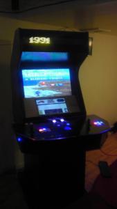

KMxRetro Posted May 8, 2014 Posted May 8, 2014 Oh wow. I LOVE that LED strip above the screen. That's a great idea!
ericleroi Posted May 9, 2014 Posted May 9, 2014 Oh wow. I LOVE that LED strip above the screen. That's a great idea! +1 Nice to see something a little different.
jw21575 Posted May 9, 2014 Author Posted May 9, 2014 Thanks guys. I know everyone is going with lcd screens for their marquees but i like using the betabrite prism for mine. I already had one lying around so i figured i would put it to use. Plus my kids like it too and I basically built it for them to play. Sent from my HTCEVOV4G using Tapatalk
HazzardActual Posted May 9, 2014 Posted May 9, 2014 Thanks. I Actually found it on amazon.com. It was used but works fine. I actually found this one for $25. But they have them on ebay as well and you can find them cheap.Sent from my HTCEVOV4G using Tapatalk anyway we can get a model number? this is the exact type of screen ive been looking for.
jw21575 Posted May 9, 2014 Author Posted May 9, 2014 Details below. I found mine on amazon. I did remove the lcd from the casing. It auto powers on with your pc so it works out good. Brand Name: Lilliput Model: UM-70 Sent from my HTCEVOV4G using Tapatalk

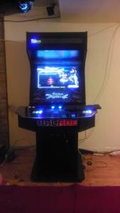

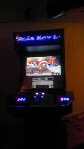

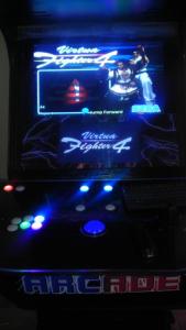

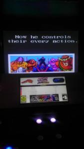

jw21575 Posted May 20, 2014 Author Posted May 20, 2014 New cabinet pics. I switched out the 7 inch monitor for a aoc 15.6 monitor as the 7 inch was to hard to see clearly. It actually measures about 8 1/4 inches high by 14 inches wide once decased. I want to configure it to show controls for mame only and marquees for the other emulators. I actually found a piece of wood the same thickness of the decased screen and cut out the dimensions and it sits flush with the wood.

Silverback Posted May 21, 2014 Posted May 21, 2014 Thats an awesome build jw21575. Love the 2 screen setup.
tkropp17 Posted May 24, 2014 Posted May 24, 2014 How did you get the controls to show up on the second screen? My Builds Apartmentcade Custom Mortal Kombat Hyperspin Arcade Build Half-Top Arcade Build
JFlash3785 Posted May 24, 2014 Posted May 24, 2014 I'm with tkropp17 how did you get the controls to show up on thee 2nd screen.
jw21575 Posted May 27, 2014 Author Posted May 27, 2014 Its a program called orbitals hyperspin helper. You can show controls or marquees on a 2nd screen
