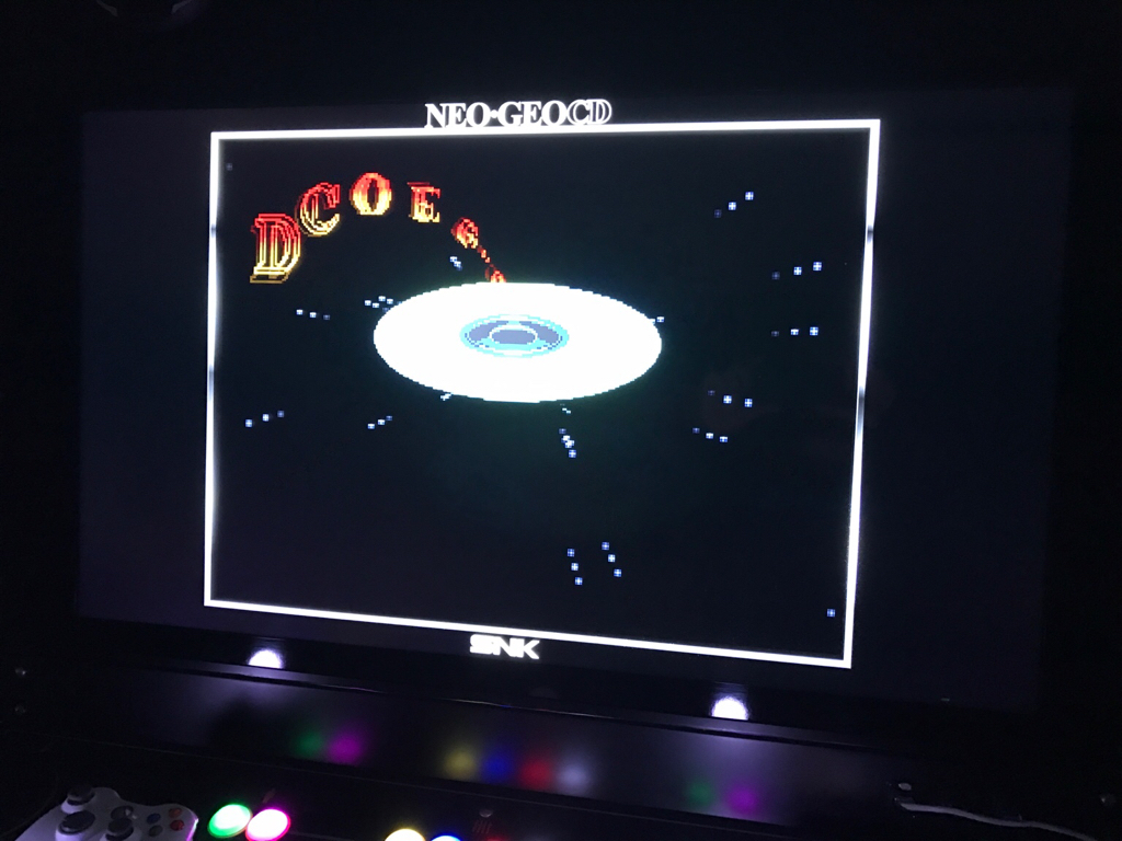

SkyHighGam3r Posted March 17, 2017 Author Posted March 17, 2017 2 hours ago, ci2own said: Just curious, what is that glorious boot screen? It has a spinning CD on a moving stars background with the words "Neo Geo CD" flying around and then the words settle under the CD and the CD changes to the Neo Geo CD logo. 2 hours ago, badboo said: The same for me, when you press F1 to go to the Retroarch setting, you go instead to the original MAME setup. I haven't changed the controll's buttons because I am using an arcade stick and it is ok the way it is. I think this is because of the way this core was programmed. Well, I can still pull up the RA menu with F1... and all that is set fine. Pushing TAB though I pull up the MAME config menu. The problem is I map everything to the keyboard, and then to xpadder. I can't play at all without changing the controls because there are so many conflicts. For instance: TAB on MAME is "Configuration Menu" but in my RetroArch TAB = Reset. So I just need to figure out how to make it save the changes I make to the MAME configuration and I will be golden. Hell I think it will wipe out like 5 or 6 systems I have queued up in my to-do list actually.
ci2own Posted March 17, 2017 Posted March 17, 2017 Well, I can still pull up the RA menu with F1... and all that is set fine. Pushing TAB though I pull up the MAME config menu. The problem is I map everything to the keyboard, and then to xpadder. I can't play at all without changing the controls because there are so many conflicts. For instance: TAB on MAME is "Configuration Menu" but in my RetroArch TAB = Reset. So I just need to figure out how to make it save the changes I make to the MAME configuration and I will be golden. Hell I think it will wipe out like 5 or 6 systems I have queued up in my to-do list actually. Ah! I can see it when launch a gameEnviado desde mi iPhone utilizando Tapatalk Pro
SkyHighGam3r Posted March 17, 2017 Author Posted March 17, 2017 2 minutes ago, ci2own said: Ah! I can see it when launch a game Yeah, now that I switched to the MAME core in RetroArch I'm pulling it up just fine. I just need some help saving the changes I make to the MAME configuration so I can actually play the games.
