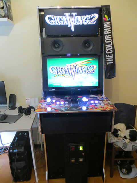

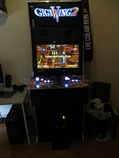

I finally decided to post some photo of my dual monitor cabinet,
started to build around 1 years ago using some part of my first cab (this is my second work) and building from zero the other, but there is still a lot of work to do!
the main monitor is a 27" samsung, the upper screen it's a 25" LG ultrawide is used as "marquee monitor" .
All the button and joystick are RGB, decals are self drawed (by me) and printed on vinyl adesive.
Computer Spec:
Windows 7 x64 , Intel Core I3 3220T, Motherboard Asrock H77 PRO4-M, 8Gb RAM DDR3, AMD Radeon HD7750, 1Tb WD Blue HDD
here some fast (and old) photo of the cab and a little demostration of the LED + Marquee combination.
I will make some better photo when i get the inspiration :good:

The entire cab is basically designed around the monitor, i have decided the width of the cab by the monitor width, and builted all the other things around it. changing it would require a lot of work
I'm used to having 22-24inch monitors, so a 27" screen for me look soo big...
Look good, so good for inspiration !  Me too I'm used for more big screen, I'm having right now a 27 inch 3:4 old TV.  But everything is related to personal background :) And the fun is to build something which make us happy !
I have a question.  Did you think to use your 27 in vertical orientation.  That was my though of my next cabinet.
Another question about side artwork, is it you who make this ?
Nice slim cabinet. Good work mate.
I like your artwork very well designed,  with all the characters representing the emulation world.
yes i have made the side art, It is not as difficult as it seems,  selected the character, created a photoshop document with the exact measurements and printed adhesive vinyl, i drawed 2 or 3 version of the artwork , electronic, abstract... but this layout is what I liked most. i will make a google drive space in future, maybe i will make the PSD free for those who want it.
When I was still planning the cab i have thinked about a way to rotate the screen in vertical position for the game that require that layout, but i have no experience in that sector, it's a ttto much advanced electronic for me actually.

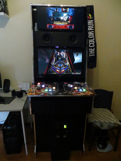

Rotating monitor will be very useful in case like this:
new marquee configuration for flipper system (Future Pinball)

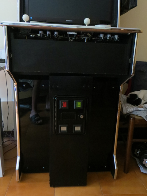

Builded a lower door with a real coin mech, i work well with 0.984" coin (50cent euro or a quarter  dollar) for some reason the mechanism are ""useless"" so it works with any coin :D
I made some mistake with the color (Buyied a much glossy color, i fix it with a spray color)  for the moment i leave it so, in future i probably wrap them with carbon look vinile
