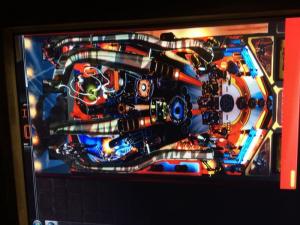

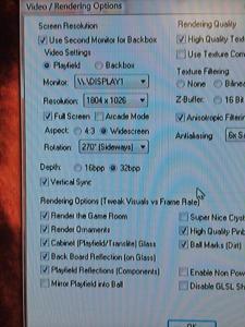

monkeychunkuk Posted May 5, 2014 Posted May 5, 2014 Sorry if this a repost or on the wrong section but I'm wondering if one of smart guys could help me So even when I change the screen size setting in the program preferences The screen always stretches out like in the picture Can someone tell me what I'm doing wrong The program setting The result
mikekim Posted May 6, 2014 Posted May 6, 2014 select arcade mode from the video options (not full screen). use scroll lock and the resizing options to move and resize the screens to the correct proportions

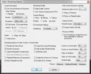

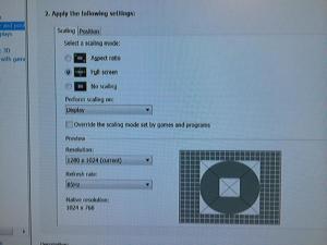

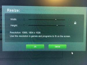

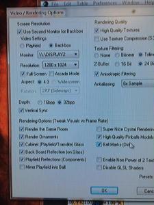

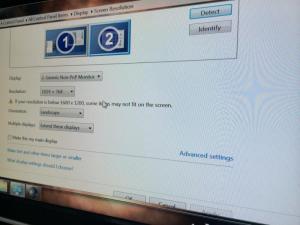

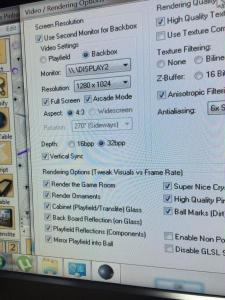

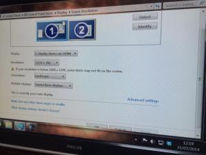

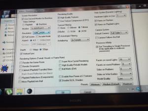

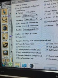

monkeychunkuk Posted July 31, 2014 Author Posted July 31, 2014 Ewwww I don't even know where to begin So I'm using bam to setup FP tables My first issue is the menu is showing up in a weird place The second is the back glass option won't let me adjust position do at the moment the back glass is stuck only showing half These are my monitor settings And FP setting Little help please
RenegadeFred Posted July 31, 2014 Posted July 31, 2014 Backbox resolution is incorrect in FP compared to your actual settings. Settings has it as 1280x1024 where your actual setup is only 1024x768 That could in theory throw things off a bit, as FP is very finicky about its settings. Correct those settings and see if that fixes your problem?

mikekim Posted August 2, 2014 Posted August 2, 2014 display 1 main playfield resolution 1920 x 1080 display 2 backbox resolution 1280 x 1024 rotation portrait
monkeychunkuk Posted August 2, 2014 Author Posted August 2, 2014 mikekim said: display 1 main playfield resolution 1920 x 1080 display 2 backbox resolution 1280 x 1024 rotation portrait Thank you Mike I shall be back with pictures

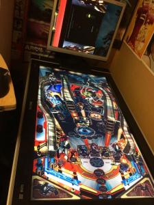

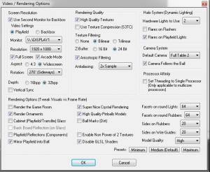

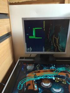

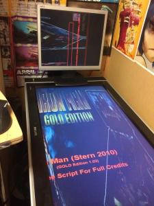

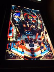

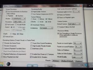

monkeychunkuk Posted August 2, 2014 Author Posted August 2, 2014 Hmmm no joy I set up and got the same And I switched the play fields after this picture btw I don't understand I seem to get the machine end on the back glass and when I move it I get half a screen, I've literally changed the screen to every setting I can't seem to even get BAM option screen to stay on one screen Just to recap my setup is this 32 screen I have it setup like this And in Fp And the back glass I'm using a 19 4:3 Setup like this And in FP And when I run either with bam or without I get this

RenegadeFred Posted August 3, 2014 Posted August 3, 2014 In your first two pictures, it shows Screen 1 and Screen 2 both set as your backglass? For your 32" is it possible to make it 1920x1080 ? Settings should have - Use second monitor as Backbox checked (as you have this whole time) Playfield Checkmarked - Display1 Resolution 1920x1080 (if possible) or whatever the max resolution the 32" can handle. Fullscreen and Arcade Mode checked Aspect - Widescreen Rotation - 90 or 270 Now, click on the Backbox mark Make sure it's set to Display2 Resolution - 1280x1024 The rest of the settings are optimized for my setup, they may be different in yours. --- With those settings correct I don't see why you would have any issues at all. UNLESS the program your using to adjust the monitors (seen above in your pictures) isn't matching the settings? That would definitely give you issues as I don't believe FP automatically adjusts the windows resolutions, but extends the screens like you've been experiencing. --- The last reply with the backglass/playfield is more then likely - both are set to the same monitor.
monkeychunkuk Posted August 3, 2014 Author Posted August 3, 2014 Thank yup I spotted my mistake after I put those pictures up I had it setup like yours and still have the same issue BUT I will copy yours and see box for box and see if I get any joy Thank you for helping out
