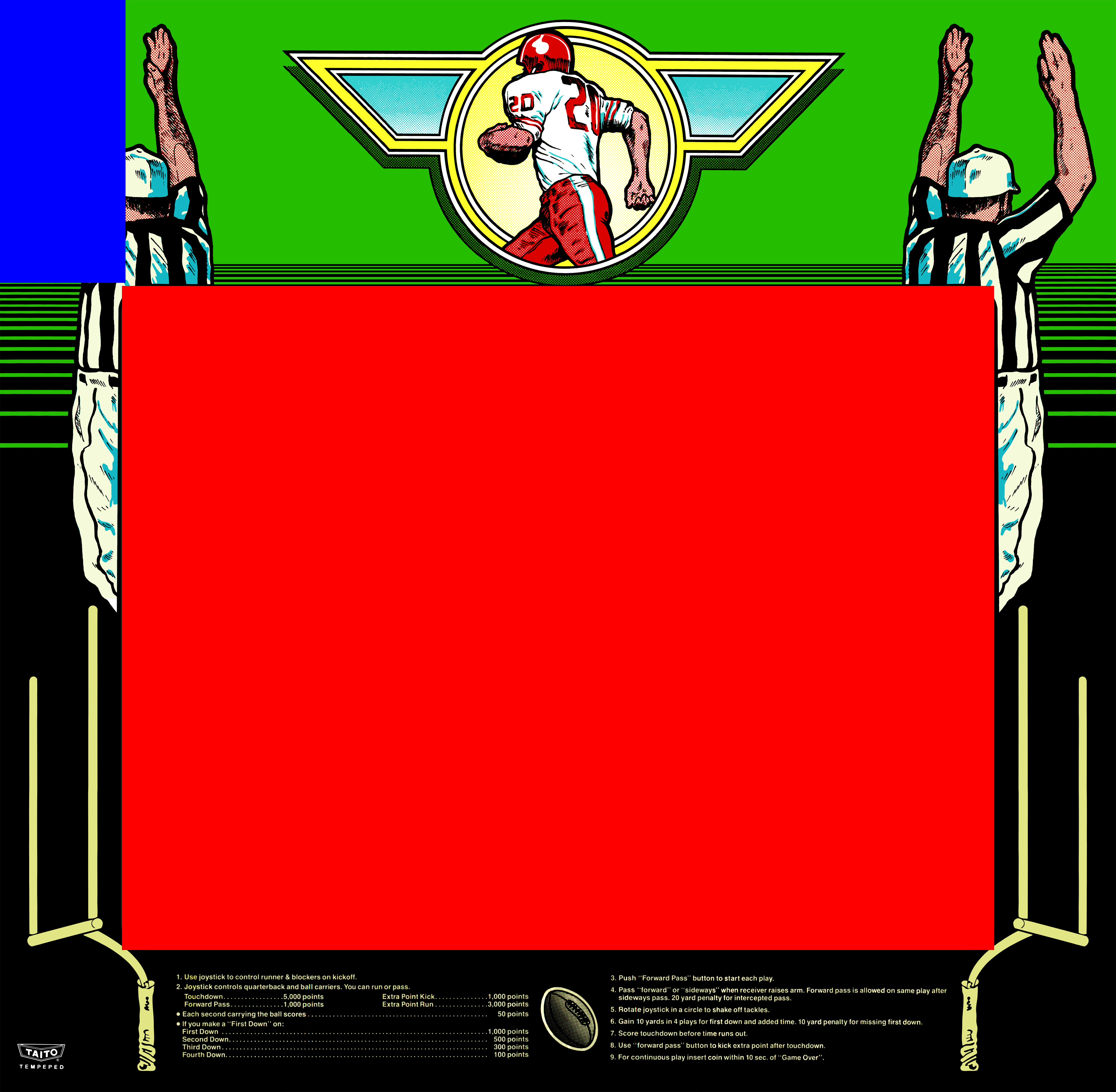

their is no standard practice,
just use a working RL bezel and add you artwork.
the only thing you need to do is update the ini file for the image.
for example I downloaded
/Official/Bezels/MAME Standard Bezel Pack (MAME)/19yard.zip
this file has
default.lay
the Rocket launcher bezel should have
10_yard_fight_bezel.ini
you will need 3 important things
dimensions of your image
size of your video display (red image)
and
video position (blue image)
the lay in the MAME bezel should have most if not all the info you need you just need to create an
INI file
or convert this
<mamelayout version="2">
	<element name="bezel">
		<image file="10_yard_fight_bezel.png" />
	</element>
	<view name="Upright_Artwork">
		<screen index="0">
			<bounds x="519" y="1107" width="2960" height="2220" />
		</screen>
		<bezel element="bezel">
			<bounds x="0" y="0" width="4000" height="3915" />
		</bezel>
	</view>
</mamelayout>
into this
[General]
Bezel Screen Top Left X Coordinate=29
Bezel Screen Top Left Y Coordinate=0
Bezel Screen Bottom Right X Coordinate=1951
Bezel Screen Bottom Right Y Coordinate=1440
