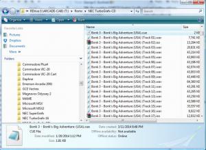

@pavlovtiger. Has that iso been renamed from .bin? And post a pic of the contents of the cue sheet. Cheers.

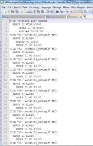

Here is the untouched cue sheet from the Wonder 3 ISO:

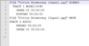

And here is the one from Cotton Boomerang, which only came with one mp3 file and the ISO and cue sheet, though keep in mind this pic is done after I renamed the audio in accordance with the game, and converted it from mp3 to wav:
I think I might have forgotten to convert Wonder 3's audio to wav earlier. Perhaps if I do that on top of renaming every track to what the game should be ("Should" here meaning 'whatever I want it to be, as it isn't on the official xml') then the audio -should- work. Or at least I have been led to believe through mild experience that it should. If I got Cotton to work, anyway. Maybe this is why games like these aren't on the official databases.

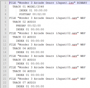

At the moment it's only this one Saturn game that refuses to work. Here's a new cue sheet I painstakingly changed to match the preferred title and re-encoded wav files, which does not work in SSF at all:
I have to assume Daemon doesn't like the audio, because the game loads perfectly through Hyperspin if I remove the audio altogether. I have no clue why Cotton Boomerang works fine when I change -that- audio to wav, it's an identical process to what I tried with Wonder 3, it's just renaming wav audio on the files and cue sheet. I think I may need to remake the ISOs that come with multiple audio files as 32assassin suggests, this isn't working even though presumably it should. Maybe Wonder 3 is just a bad example/bad audio/some other thing I can't see, but I have too little experience with these. It's why I blanche every time I download a game and see a stack of mp3s. I have to go, "hmm, well how badly do I want -this- game on my Hyperspin."
