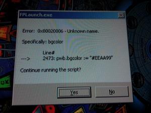

ukexpat71 Posted March 25, 2013 Share Posted March 25, 2013 Hi, So i decided to take the plunge into fplaunch 1.295 WIP10 and all is working better than expected except for this error thats been brought up before but not resolved. "I'm having an issue with accessing instructions from within a game via the Exit menu. " FPLaunch crashes, See attachment I have Flash installed and shockwave and java. Flyers are working fine from the exit menu triggered by 'e'. I can access instructions and flyers no problem on the Hyperpin wheel screen and I am using the Enter button to select menu options. Just no Instructions from the Exit menu?? Please help this is doing my nut in. Thanks webster. Link to comment Share on other sites More sharing options...

ukexpat71 Posted March 27, 2013 Share Posted March 27, 2013 Hi, the escape was using ctrl as well, dont know why but mapped to another key ok. E was already mapped as Exit but only works when at the hyperpin wheel menu not in game. P for Pause brings up the service/flyer menu in game as E should. But no keys work. (flippers cant move menu up or down, E does not work or Enter) I have made this 'useExitAsPause=true' flase in Settings.ini and Fp but get error. Please someone attach your WORKING FPlaunch and settings.ini mapped to e for exit. Thanks, Webster Link to comment Share on other sites More sharing options...
ukexpat71 Posted March 27, 2013 Share Posted March 27, 2013 IGNORE - its all working now. Link to comment Share on other sites More sharing options...
